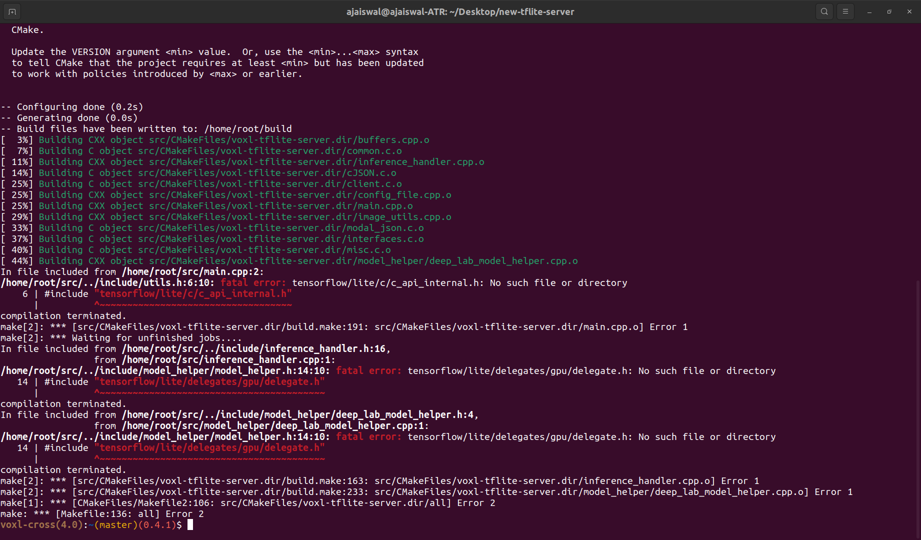

      I'm having the same issue trying to compile the latest tflite-server from gitlab. I haven't even changed any code and it still did not build for qrb5165. It has multiple missing files such as modal_json.h, modal_pipe.h, c_api_internal.h, delegate.h, etc.
      I copied and pasted the json and pipe headers from the libmodal repositories from voxl SDK/Code Libs on Gitlab and that fixed the first two. But still got the file not found error.

                    I tried cross-compiling latest tflite-server on voxl-corss:V4.4 and got the same error despite adding /usr/include/ in the src/Cmakelist.txt
