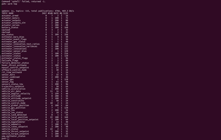

          pxh> ERROR [muorb] SLPI: MAG #0 failed:  TIMEOUT!
          ERROR [muorb] SLPI: BARO #0 failed:  TIMEOUT!
          pxh> qsheERROR [muorb] SLPI: BARO #0 failed:  TIMEOUT!
          pxh> qshell dsp_hitl statERROR [muorb] SLPI: MAG #0 failed:  TIMEOUT!
          pxh> qshell dsp_hitl statusINFO  [uORB] Advertising remote topic vehicle_global_position

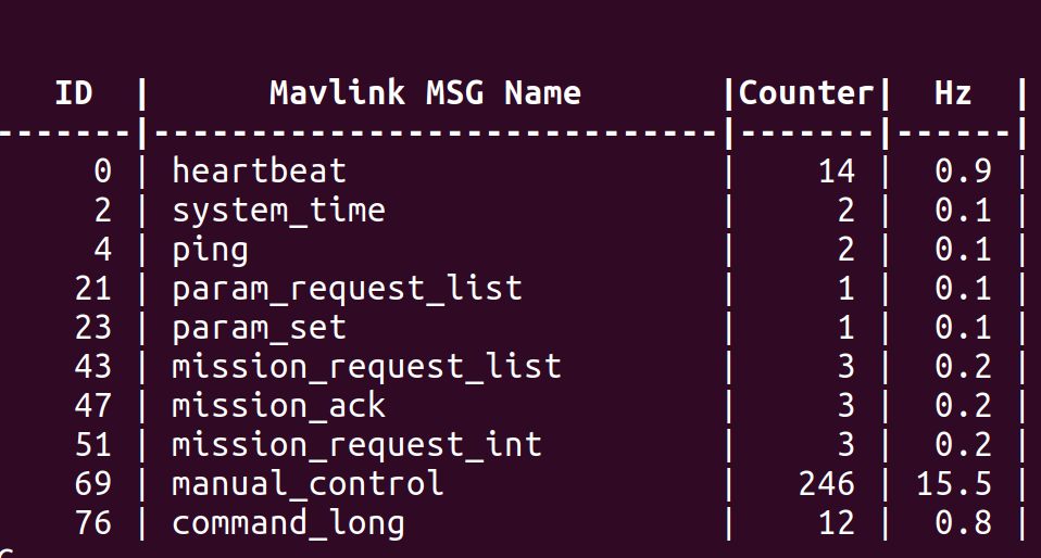

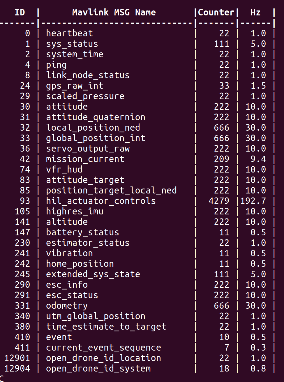

                Similarly, when I looked at mavlink messages, nothing really stood out as too heavy:
                • onboard services:
                • from gcs:
                Some of the things I tried:

                        @Eric-Katzfey I tried examining the logs for default modal AI px4 firmware IRIS configuration and my customized firmware with vtol modules enabled. Strangely, the CPU usage seems identical and above 75% even in the default case.
                        Log plots here: https://drive.google.com/file/d/1UZfAYMRQ-VfYnyf1u__l9NAUHnM8Q0PJ/view?usp=sharing.
                        I assume one of the cpus is the apps one and the other is the dsp one. This is still strange, since according to my comment above the total cpu usage of the apps was slightly over 70%.
                        @garret said in Firmware Structure (Adding VTOL support) - Clarifications:
                        total CPU usage is only slightly over 70%
                        As for the gazebo sending messages, still looking into it. However, I did some quick diagnostic and found that gazebo's publication rate seems sufficient:

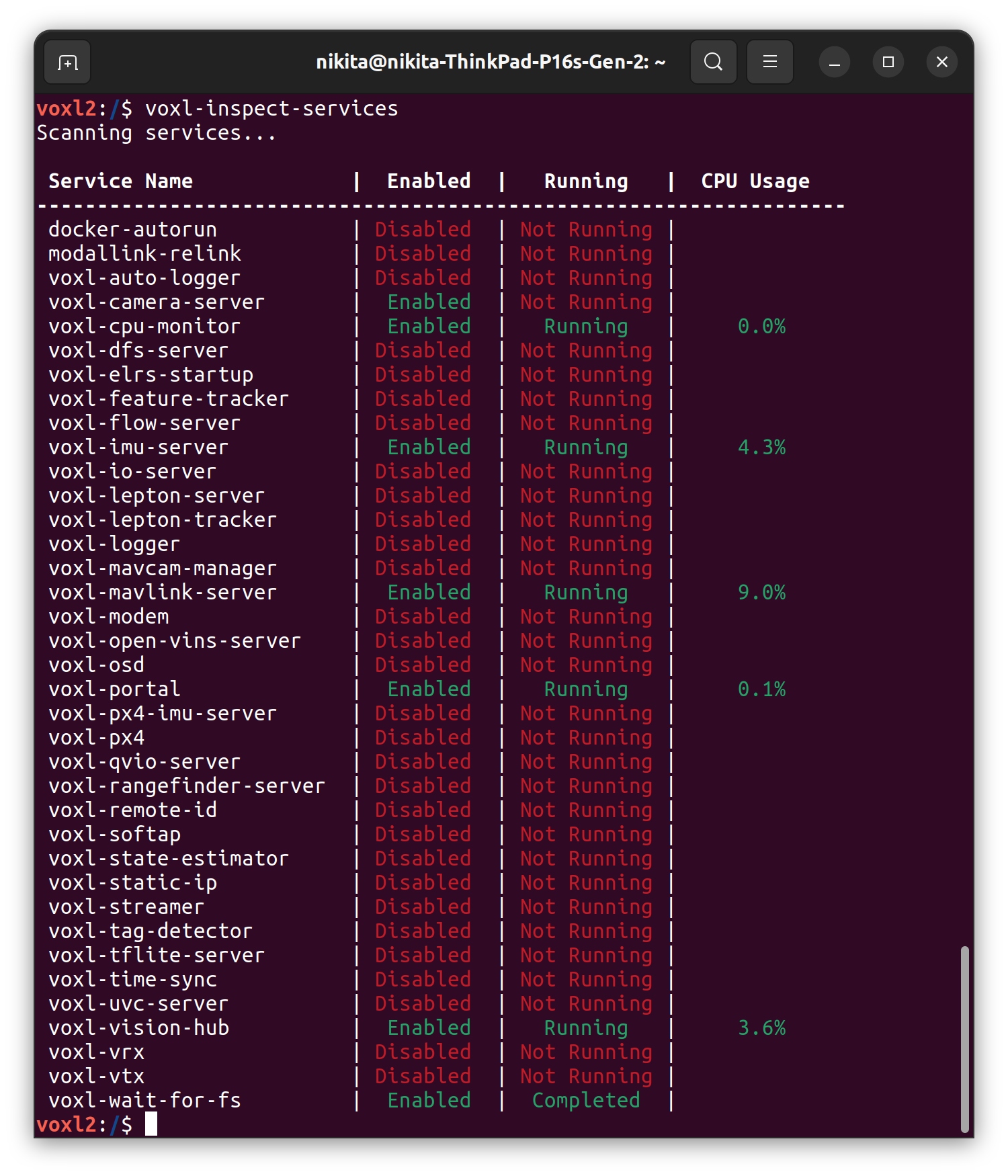

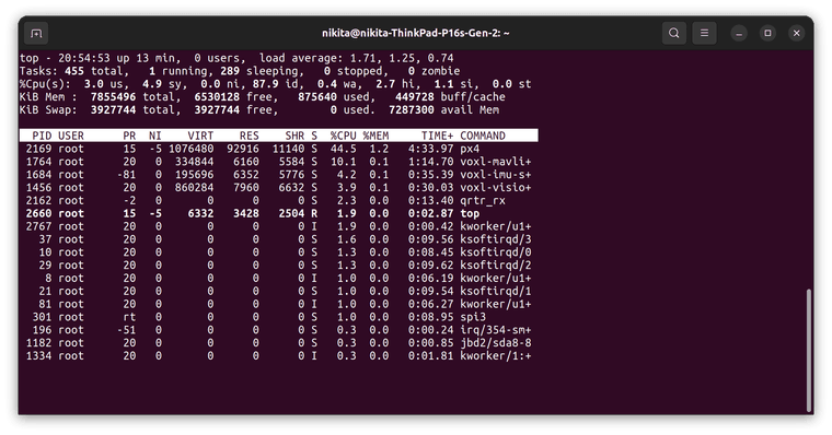

                          I have looked at the cpu usage from voxl-portal and got even more confused. When comparing with my previous posts, the results differ again. To summarize:
                          • after adb shell into voxl2, "top" suggested total linux cpu usage of ~70% when running px4
                          • voxl-inspect-services gave about ~15%
                          • PX4 logs give varying cpu usage from 0% to 88% depending on the core
                          • voxl portal outputs about 10% cpu usage on every core when running px4 hitl sim.
                          Is there a reason all these sources differ so much?

                            @garret You have to be careful looking at CPU utilization on the Linux side. Sometimes the number reflects usage on a single core or the usage of a single process and sometimes it is total usage across all cores. The utilization on the DSP is what usually matters more for PX4 since most of the code runs on the DSP.

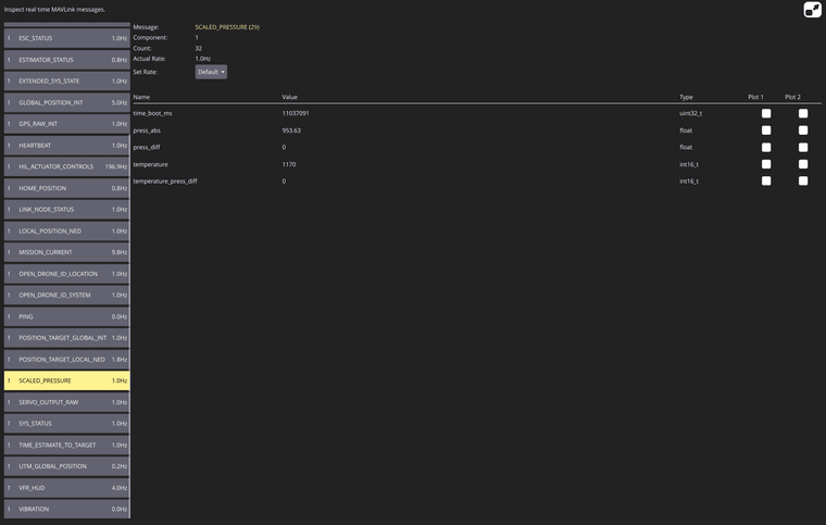

                                        @garret As best I can tell the diff_pressure field in the Mavlink HIL_SENSOR message sent from Gazebo would have this info but it is an optional field so not sure if Gazebo is actually populating it. If it is then it will be made available within PX4 via the differential_pressure topic.
                                        G 1 Reply Last reply Reply Quote 0
                                        • G
                                          garret @Eric Katzfey
                                          @Eric-Katzfey gazebo evidently is not publishing diff_pressure but I am confused as to why. from what I have seen online, usually it just works out of the box for people when they build the world. i even checked all the .sdf models in the gazebo classic repo and all the mavlink plugins for fixed wing and for quads are identical. where would this be configured ?
                                          all I see in gazebo is the airspeed topic like such:
                                          gz topic -d 4 -e /gazebo/standard_vtol_hitl_world/standard_vtol_hitl/airspeed/link/airspeed

                                          and but when it comes to the received mavlink messages:
                                          this is the closest I have to diff_pressure
                                          Eric KatzfeyE 1 Reply Last reply Reply Quote 0
