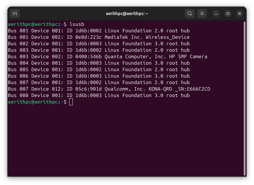

        @wrossi17 can you post the output lsusb? You should be looking for something that includes "LAN75xx"
        W 1 Reply Last reply Reply Quote 0
        • W
          wrossi17 @Chad Sweet 0
