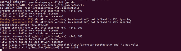

      docker run --rm -it --net=host --privileged -e DISPLAY=$DISPLAY -v /dev/input:/dev/input:rw -v /tmp/.X11-unix:/tmp/.X11-unix:ro voxl-gazebo-docker ./run_gazebo.bash
    Since my /ttyUSB0 is recognized, I assume gazebo is trying to send the data to the voxl2 board.

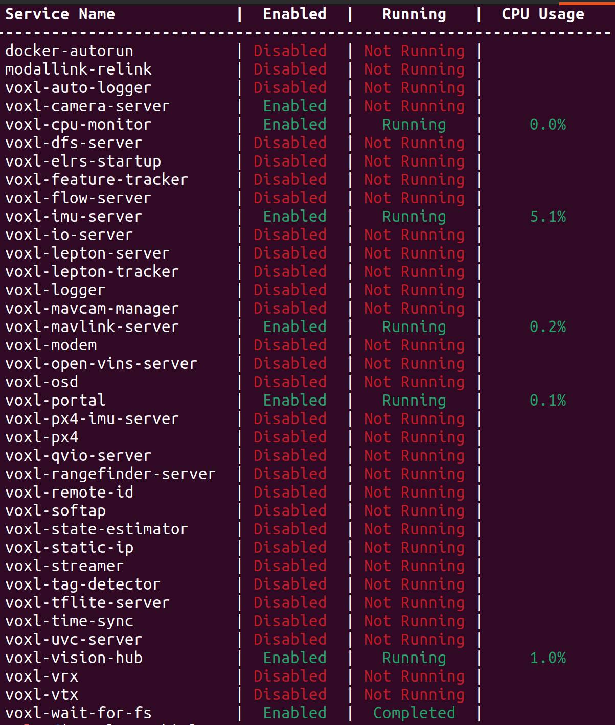

    1. As for my services, I have the following:
    px4 and qvio are disabled by default and mavlink is running.

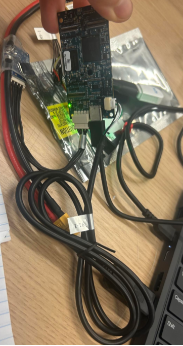

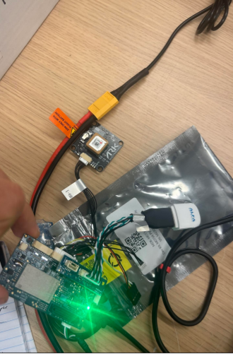

      @garret Note: this is my physical setup

        @garret I use the Sparkfun CAB-12977 and CAB-17240 for HITL and it works really well.

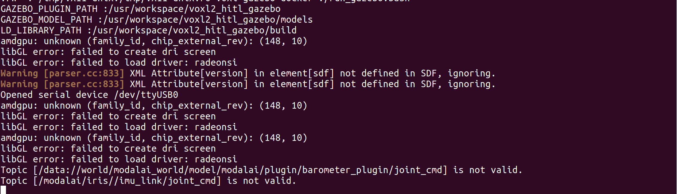

            @garret Very likely. But you also have some errors on gazebo launch that I have never seen before so that could be part of the problem as well.

              @Eric-Katzfey are you referring to libgl errors?
