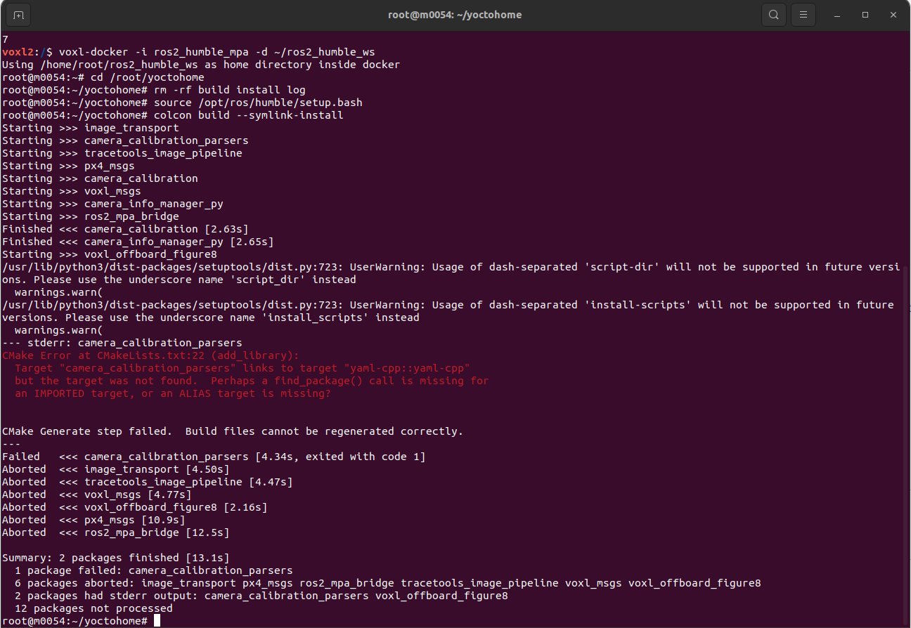

        1. Is it possible to upgrade the Ubuntu version to 22.04 on the VOXL2 autopilot? This is to use ROS2 Humble without a docker.
        2. Currently to run ROS2 Humble on the existing Ubuntu 18.04 setup, we installed a docker but we're a repeatable issue.The colcon build --symlink-install keeps failing (screenshot attached below). How can we resolve this?
        We've also seen a few instances of location conflicts during the installation of ROS2 humble, but have tried to resolve that as and when we see them.

            @george-kollamkulam
            Where are you getting the image / ROS2 packages? Is this an image that ModalAI maintains?
            Just looking at the error, it seems like it can't find the yaml-cpp package. It could be that it's not installed correctly or something's wrong in your CMakeLists.txt. It looks like the yaml-cpp readme has some info for including it in your CMake project.
            If you're using camera_calibration_parsers from image common, it might be worth bringing the issue up there.
            Let me know if that helps,
