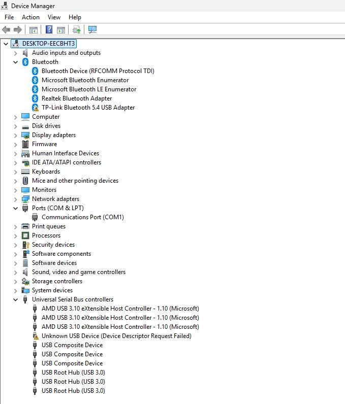

      Windows: Device Manager shows Unknown USB Device (Device Descriptor Request Failed) with a yellow triangle

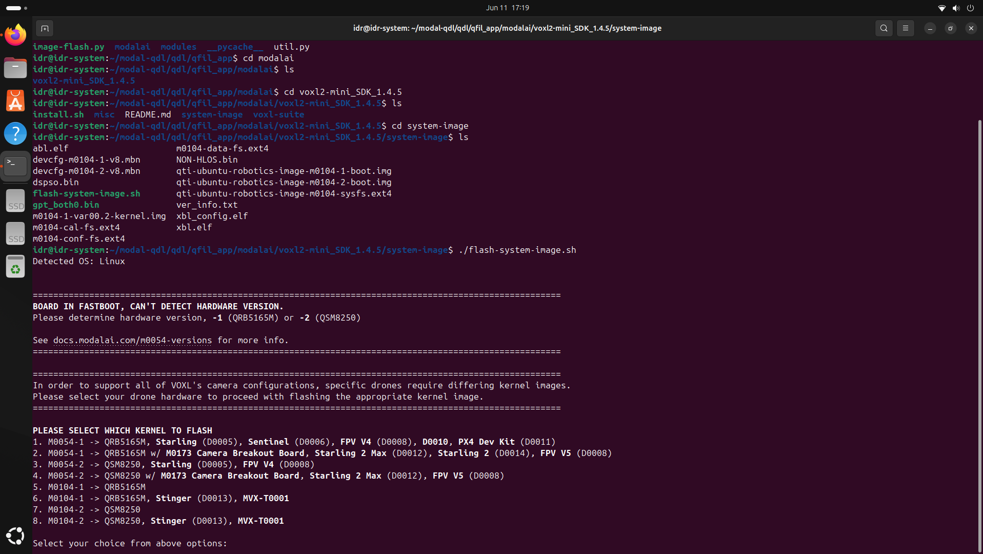

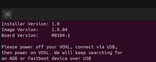

      I also tried to run flash-system-image.sh (see the attached screenshots)fails with “device not found” in fastboot mode

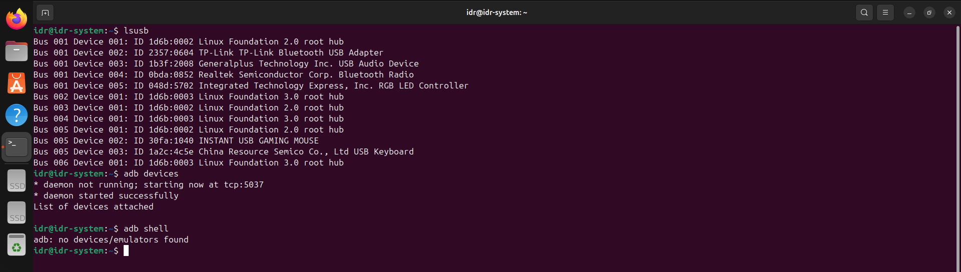

            @Sarika-Sharma With the device powered and plugged in via USB, what do you see with lsusb?
            S 1 Reply Last reply Reply Quote 0
            • S
              Sarika Sharma @tom
              • tomT
                tom admin @Sarika Sharma
                @Sarika-Sharma Interesting, is there a different USB cable / port combo you can try? It may be worth trying with a USB-A to C cable as some C to C cables don't contain the proper data lines

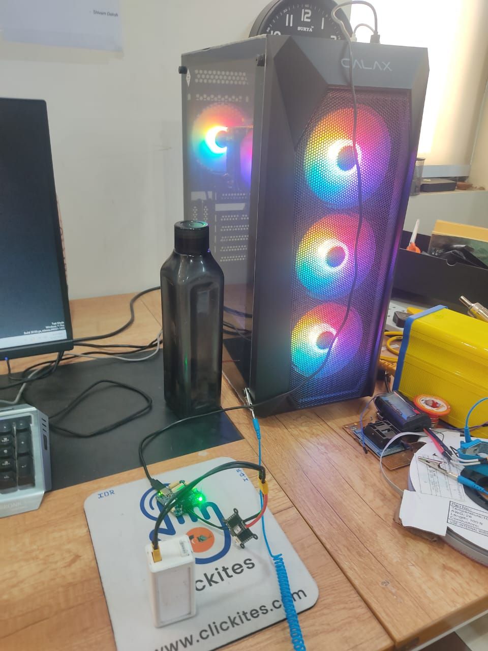

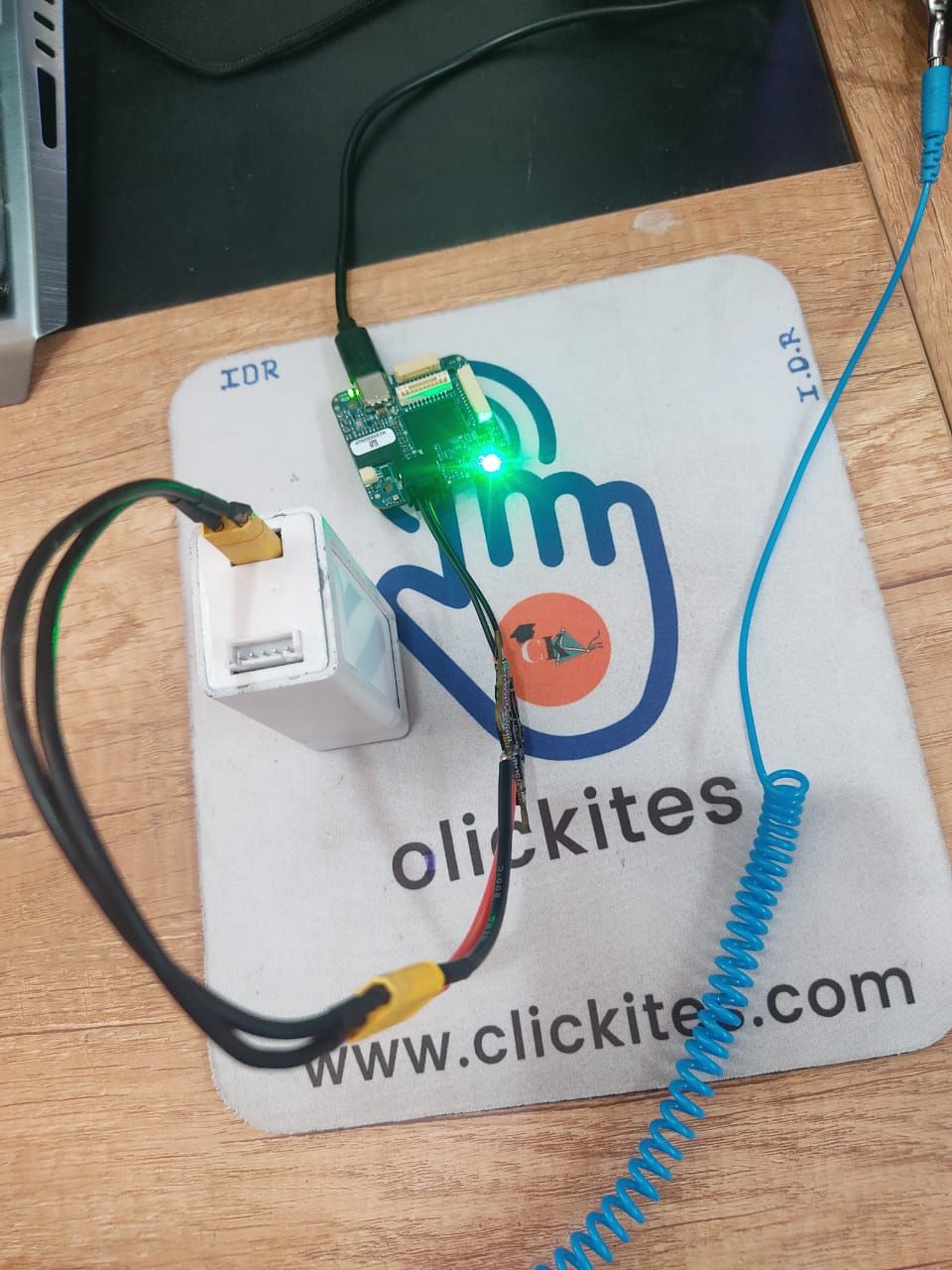

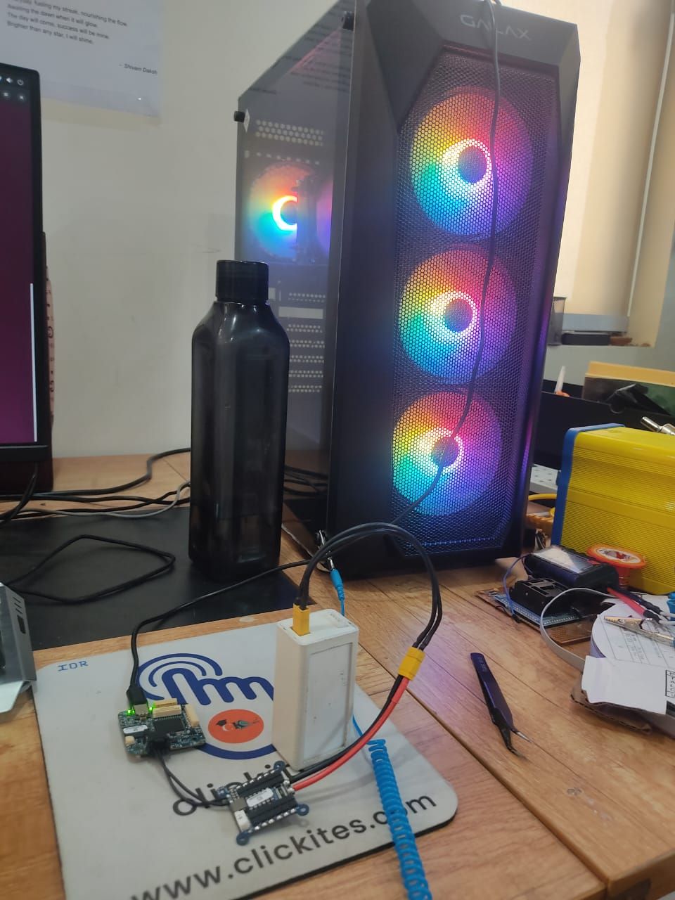

                  @tom Yes, I’ve already tried using a USB-A to USB-C cable and also I used the same cable to connect VOXL2 previously, and it works perfectly — I'm able to access the ADB shell without any issues, so the cable and USB port are both functional. However, when I try to connect the VOXL2 Mini using the same cable, I’m unable to see any device listed with adb devices on Ubuntu natively(I have a dual-boot setup).I’ve also checked lsusb on Ubuntu in both normal power-on and while attempting EDL mode, but no Qualcomm device shows up.
                  When I switch to Windows, the VOXL2 Mini appears in Device Manager as "Unknown USB Device (Device Descriptor Request Failed)" with a yellow warning icon (screenshot attached).

                  • tomT
                    @Sarika-Sharma Interesting, what kind of battery are you using? What is the voltage?
                    • S
                      Sarika Sharma @tom
                      @tom I'm using a LiPo 3S battery with a voltage of 12V.
                      • tomT
                        @Sarika-Sharma Okay that should be fine, was just double checking the voltage wasn't too high for that ESC.
                        I'd recommend submitting an RMA: https://www.modalai.com/pages/rma
