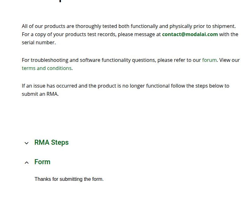

                If not, I'd recommend filing an RMA and we can further debug the issue: https://www.modalai.com/pages/rma

                  I don't see any Qualcomm device with running "lsusb".
                  I also have confirmed that the USB-C cable is able to access another VOXL device.
                  So I have submitted the RMA
                  Please let me know if any questions or suggestions.
