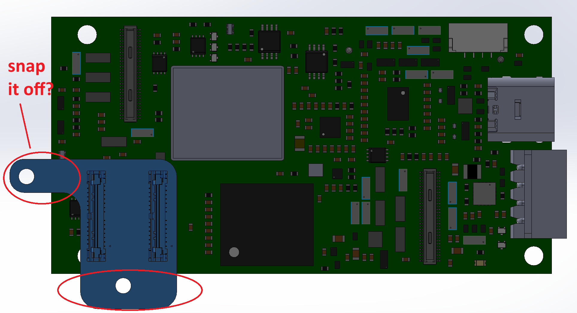

            @Alex-Kushleyev I am trying to package the M0180 hadron board with VOXL 2. Just to confirm that the M0180 board is properly plugged in the VOXL2 as shown:
            If yes, can the M0180 board be trimmed (horns snapped off?) as shown in red for better packaging?
            Thank you in advance for your reply.
              @h3robotics , yes this is the correct orientation, if you wanted to connect M0181 to VOXL2 J7 (not M0180, i think that was a typo in your question).
              Here is the reason why the mounting holes do not line up:
              • the M0181 board was originally designed to better fit when connected to VOXL2 J8 (when J6 and J7 are used by M0173 camera front end), then the mounting hole in the tab will line up with the mounting hole on VOXL2 next to the power connector. However, using J8 is not yet officially supported (needs to be tested).
              • You could still connect M0181 to VOXL2 J7, but the holes do not line up well.
              • When using M0181 with VOXL2 Mini, the mounting hole (the one that is not in the tab) will line up with the Mini's mounting holes.
              If you really need to connect M0181 to VOXL2 J8, we could explore this, but i would also need to know what other cameras you are connecting to VOXL2 (and if you are using M0173 camera front end), just to make sure there would not be conflicts with other cameras.
