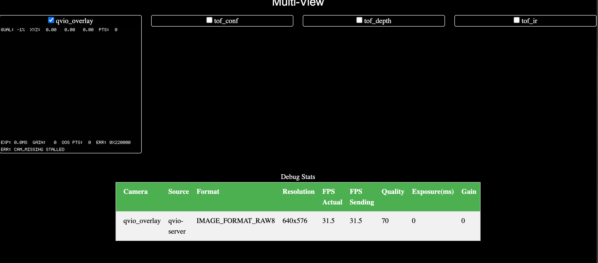

      @Alex-Kushleyev , we are using a tracking camera for VIO with TAV2, In ground test the camera works fine, but when we are doing a flight test the qvio overlay shows CAM_MISSING_STALLED
      This happens only during midflight, when we initialize and takeoff it is fine, midflight we get this error. Can you please help!
      A 1 Reply Last reply 8 Aug 2024, 19:17 Reply Quote 0

        @Jetson-Nano , it seems like the tracking camera stops sending images - if this is happening during flight, perhaps there is some issue linked to vibration which is causing the camera image transmission from camera to the ISP to break. Please inspect camera flex cable and connection to VOXL2 board.
        Also, does voxl-camera-server stop with an error when this happens? you can check journal logs for the camera server process.
        J 1 Reply Last reply 9 Aug 2024, 17:15 Reply Quote 0

          @Alex-Kushleyev The Flex connectors seem to be fit in place. Maybe there could be possibility of the connectors losing connection points on the high speed connector points in the flex cables. Is there any way we can brace the connectors tight in place? Would you recommend something?
          A 1 Reply Last reply 13 Aug 2024, 21:36 Reply Quote 0

            @Jetson-Nano, Normally, the camera connectors would not wiggle out of place (while staying inserted) if they are inserted correctly and they are not damaged. That is to say, if the connector stays physically inserted, vibration should not cause it to have bad contact.
            It is possible that the flex cable is damaged or has a fine crack in the copper traces. You can test it out by gently moving the flex cable while the camera is streaming (but do not pull hard or do not try to disconnect the connector by pulling on the flex).
            J 1 Reply Last reply 14 Aug 2024, 05:45 Reply Quote 0

              @Alex-Kushleyev But, the camera server is stopping. When the there is no vibrations, the drone is on ground and not even armed I am getting this error. When I run camera server it shows either killed or aborted. If there is damage in the flex cable it should not work even in the ground when it is stationary. It is stopping exactly after 5 sec of starting the server.
              If I configure the camera server only for tracking it is working fine, when I configure along with the ToF it is showing the error.
              J 1 Reply Last reply 14 Aug 2024, 06:45 Reply Quote 0

                Aborted
                A 1 Reply Last reply 15 Aug 2024, 17:47 Reply Quote 0
                • A
                  Alex Kushleyev ModalAI Team @Jetson Nano
                  @Jetson-Nano , Yes it seems like TOF sensor is not working properly. Can you please repeat the test with only TOF and enable some debugging:

                                @Alex-Kushleyev I have also attached the below output where ToF sensor fails sometimes during midflight, we tried reattaching the flex connectors to interposers and works fine for a while and shuts off. I tried to troubleshoot on the following note,
                                Case 1: Only Tracking enabled with ToF attached - I copied the required .bin files to /usr/lib/camera/. I restart the voxl-camera-server and the Tracking camera works fine on ground and midflight, without being frozen or feed being stalled from server.
                                Case 2: Only ToF enabled, with Tracking attached - I copied the required bin files to the destination. I restarted the voxl-camera-server, after a while data starts getting published. But the senosr doesn't always work. On a scale of comparison based on testing, the sensor stops publishing data 2 out of 5 run of tests.
                                Tried increasing the FPS of the sensor from 5 to 15, to check if would help. It helped improve mapping quality, but not well to solve the issue of losing feed.
                                Case 3: ToF + Tracking ov7251 attached and enabled - Configured the voxl-configure-cameras to configure 5. Then I restart the systemctl restart voxl-camera-server, the camera server restarts and feed is viewed in portal since cameras are publishing data. Sometimes upon restarting or running voxl-camera-server only, the cameras are detected and the server gets aborted abruptly or a message of gracefully exited appears.
                                Sometimes, the server goes of randomly on ground or mid-air and comes back again. On running dmesg -w on a terminal, I get the following output.
                                      Hi @Jetson-Nano ,
                                      Thank you for sending the logs. Unfortunately, I do not see anything specific that would indicate an error in the last few logs.
                                      Do you have more than one VOXL2 you could use for testing? also, do you have another TOF sensor you could use? It seems the issue is tied to the TOF sensor but it is not clear whether it is on the VOXL2 side (maybe connector issue) or the TOF sensor side.
                                      What you are describing is not normal behavior - the camera server from any recent official release should be pretty stable when used with these standard configurations (tracking camera, TOF, etc).
                                      Since the tracking camera by itself seems to be working fine, please focus on testing TOF only (you can disconnect the tracking camera) and make sure you can get that to work reliably, testing on a different VOXL2 or a different TOF module if possible (to rule out one of the two being an issue)
                                      Also, which SDK are you using?

                                        @Alex-Kushleyev Thanks for reverting. Yes, I have another VOXL2 board. I'll test and share the results. I'm currently testing with SDKs 1.1.1 and 1.2 releases.
                                        • J
                                          Jetson Nano @Alex Kushleyev
                                          @Alex-Kushleyev I tested the ToF with another VOXL2 board I have. Modified the camera config as only for ToF. On ground tests, the camera server seems to work fine. On terminal system logger publishes similar type of CAM_INFO, CAM_ERR dmesg -w messages as earlier.
                                          We used the same interposer as used in earlier VOXL2 compute.
