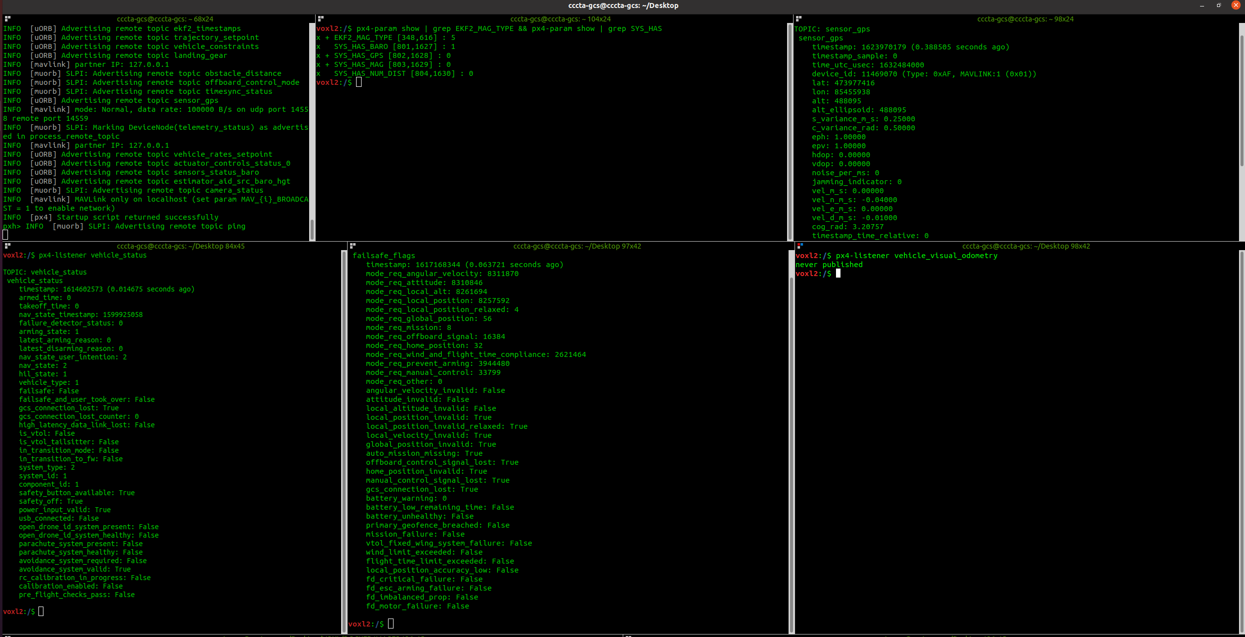

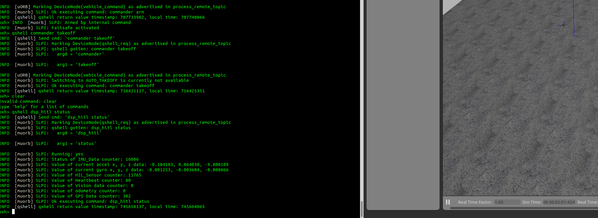

@leonardo-Andrade-0 Doesn't look like the HITL driver is receiving any data over the serial port. That's why you see those failures about baro, gyro, and accel data missing. Can you execute the command
qshell dsp_hitl statusand see that it says? -
qshell dsp_hitl statusand see that it says?@Eric-Katzfey said in VOXL2 - HITL/VIO:
I runned the command , but seems it's ok.What could I check? What do you suggest?@Eric-Katzfey

@leonardo-Andrade-0 Is px4 generating a log for the failed takeoff attempt? It's best to go into /data/px4/log and clear out any logs that may be saved there. Then run your test and verify that a new log was created. That log should indicate the reason for the arming failure. You can also just look at topics like
failsafe_flagsandvehicle_statuswith thelistenercommand to see what they are indicating as failures. What does the start command look like in/usr/bin/voxl-px4-hitl-start? Did you change it from the defaultqshell dsp_hitl start -g -m -o? -

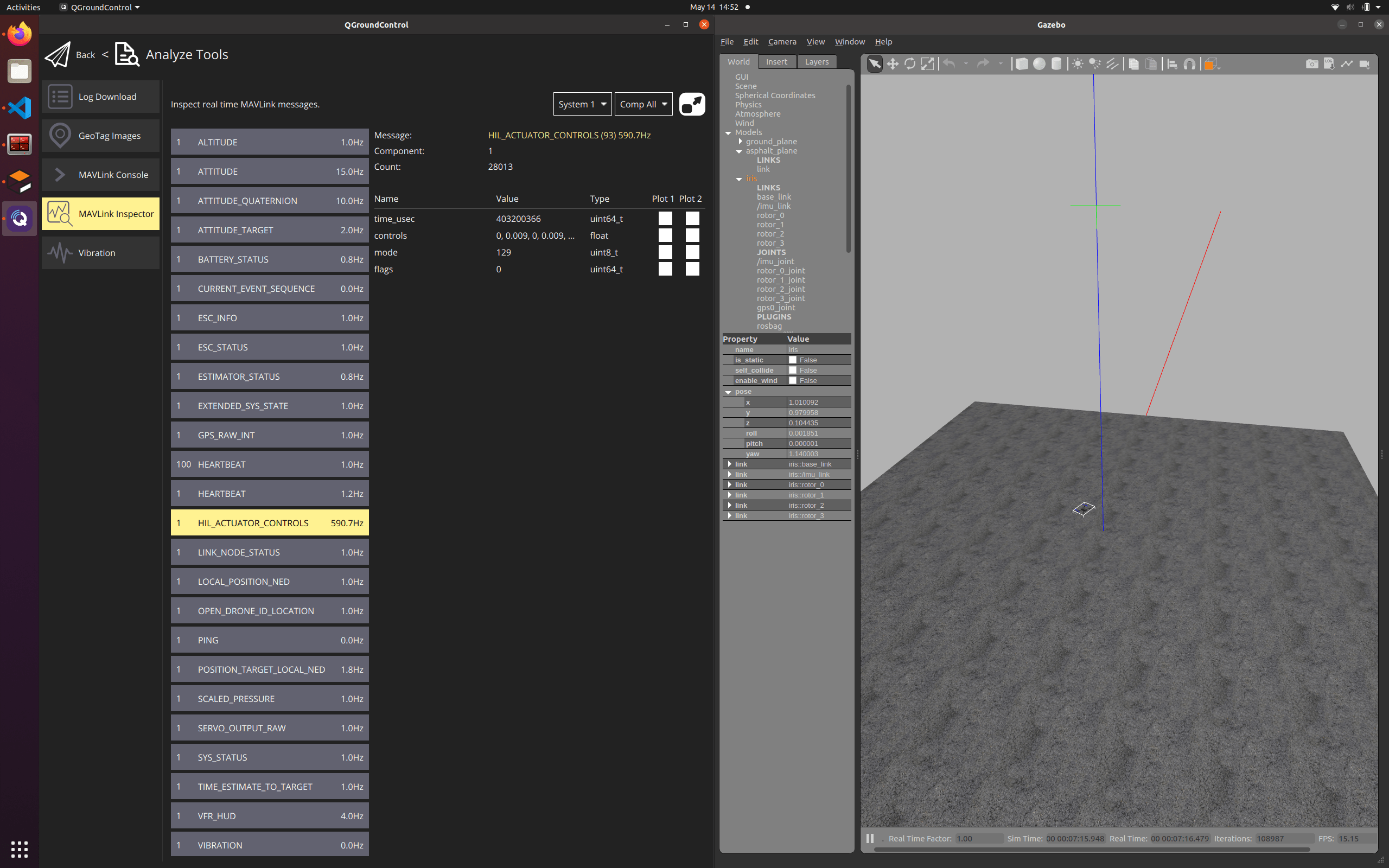

@leonardo-Andrade-0 It shows you are just running gazebo from the command line. You need to be running our version of gazebo from the Docker. See https://docs.modalai.com/voxl2-PX4-hitl/#gazebo-simulator-setup-on-host-computer

@leonardo-Andrade-0 Can you change the start command to remove the
-ooption from dsp_hitl start? That will try prevent VIO odometry from being published and only leave GPS and magnetomer for position hold. See if that works. You can see that home position is not valid in the failsafe flags but it should be if GPS is coming in. -
