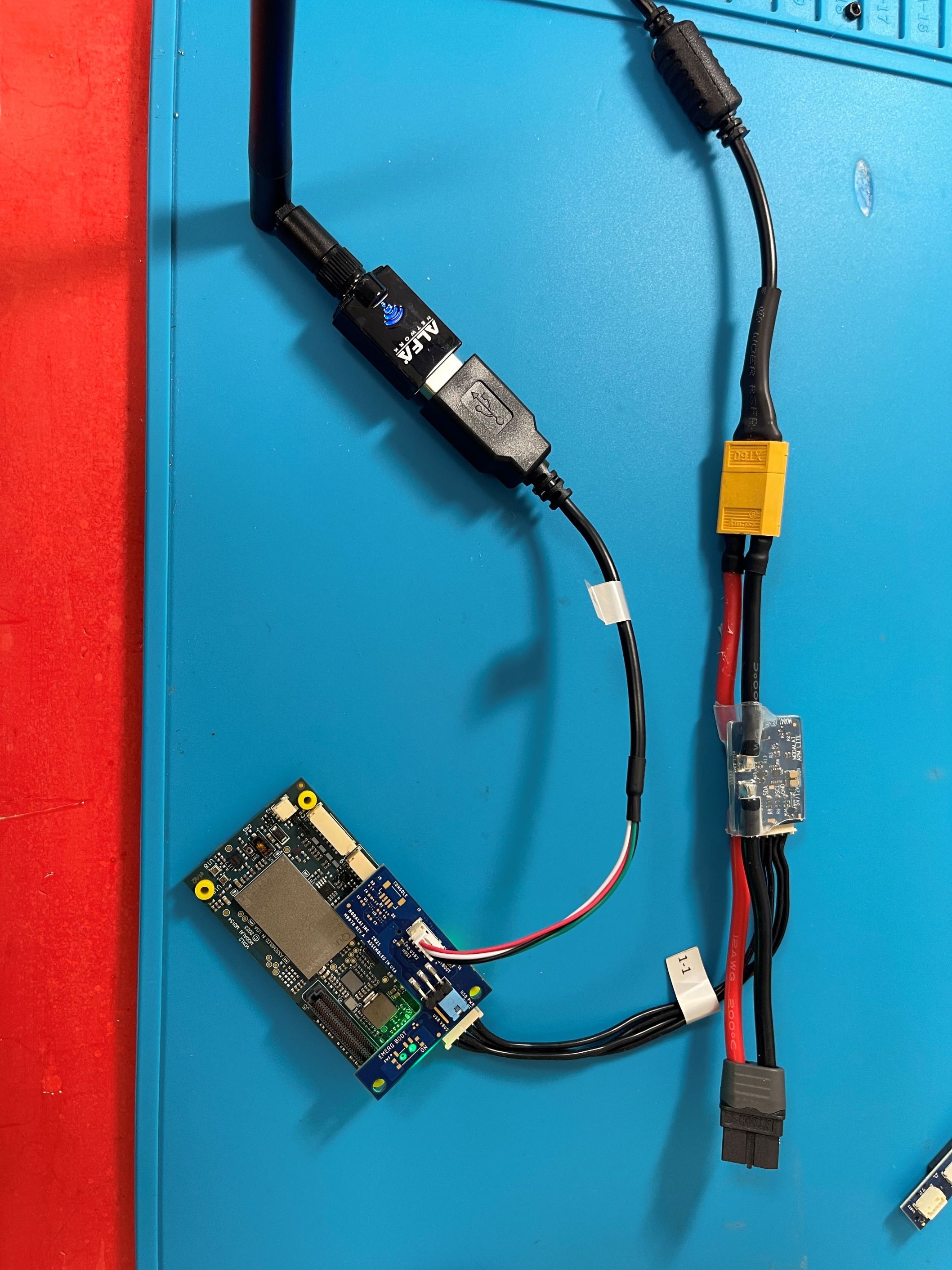

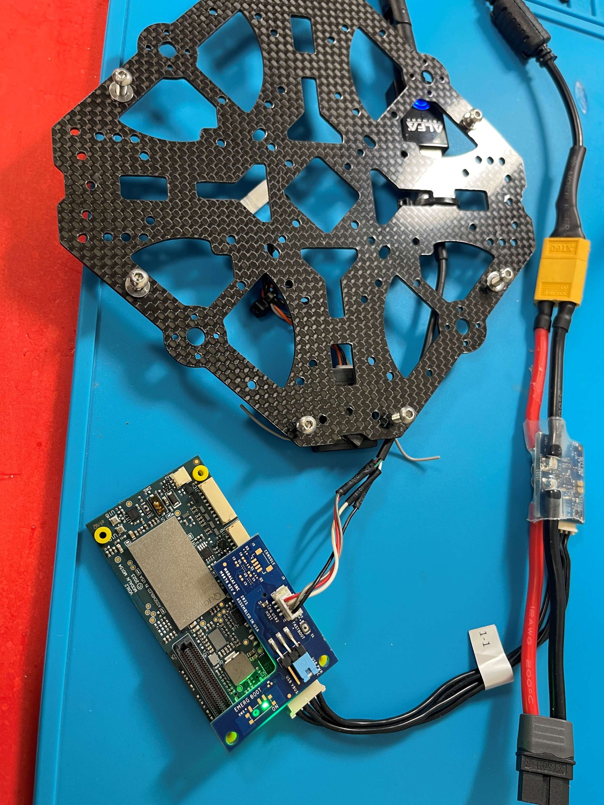

    Our team received our newest parts in the mail yesterday evening and we are working on integration today. Parts included a new 4 in 1 ESC and a WiFi Dongle and the M0125 Expansion Board to connect the WiFi dongle to.
    After proper installation and applying power, no lights show on the Alfa module and no network is detectable. In the past we had M0078 expansion module and when setting up the WiFi dongle we needed to engage the fast boot button during first power up. Is there a step with this new board I am missing? Should power be flowing natively to this M0125 board? WiFi module works and lights flash when plugged into my computer.

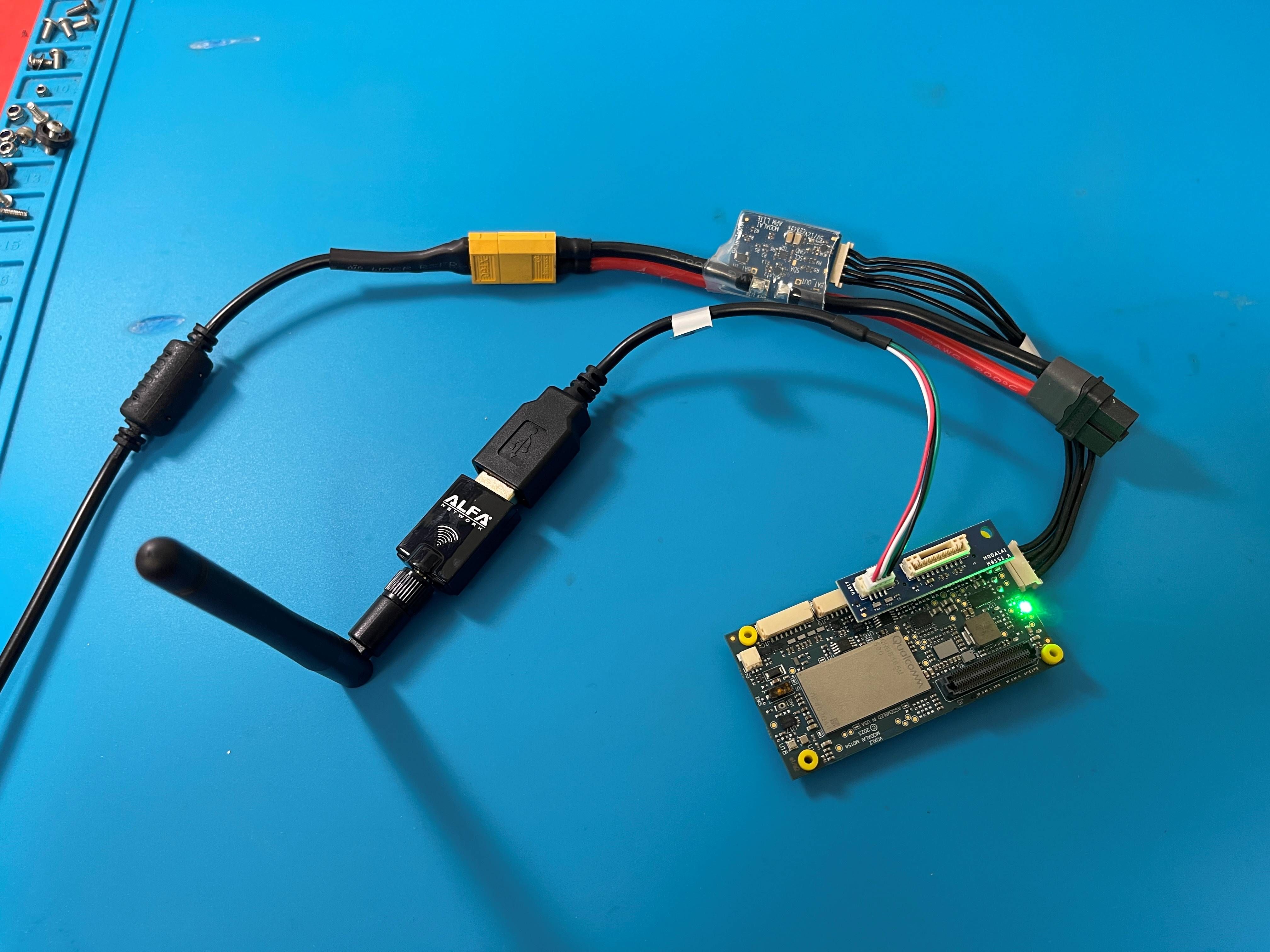

      I tried the old board from our other aircraft, it worked just fine with both the old and new wifi dongle/Alfa Module.

          @Stefan-Amundarain What you're plugging the WiFi module into is a UART, not a USB port. You'd need to use the other connector, in combination with an MCBL-0022
