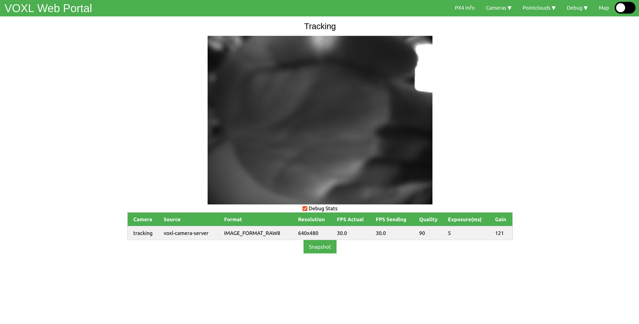

    Hi everyone,
    I recently ordered a tracking camera to mount on the voxl2, but it appears to be completely out of focus (see image below). I thought that the cameras were shipped already with the focus set. Is it possible to regulate the focus?

      Sorry for the inconvenience. We do screen for focus, this one may have slipped through. Please see attach focusing guidelines from our production team https://storage.googleapis.com/modalai_public/temp/MODALAI-Focusing-M0014-160823-043819.pdf
