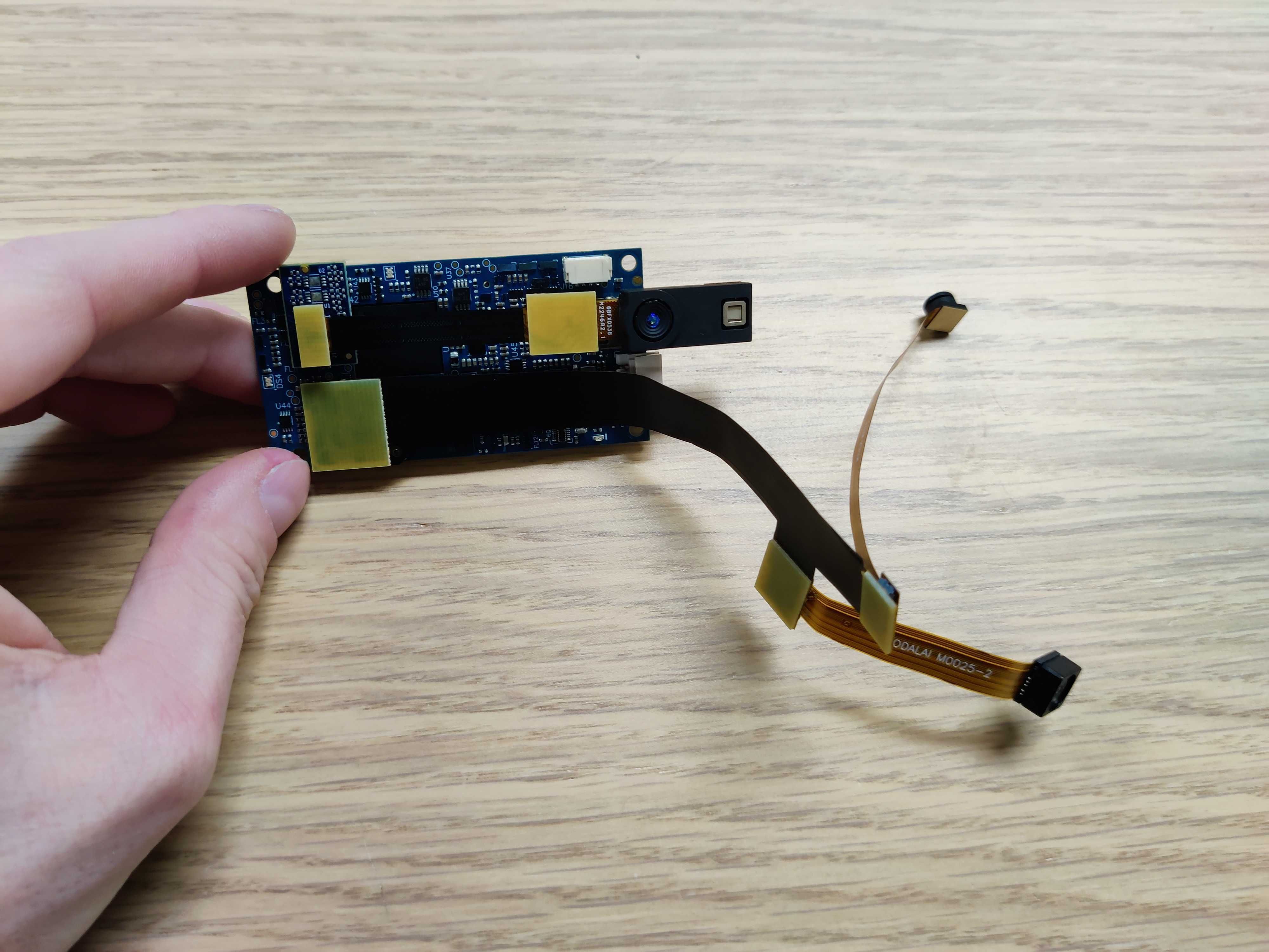

      @Aaky Can you post a picture of your camera / hardware setup so we can see which orientation / port each sensor is connected to?

        @tom Please find attached picture of all three cameras connected to VOXL2 as per standard camera config C6. Also with this hardware connections I can see C4,C8,C9 camera config work successfully but just not C6.

          @Aaky The C6 camera config was moved around a bit in the beta4 release. Not documented at all so absolutely not your fault for following what is on our docs. We may switch it back to the way you have it there but for the time being the workaround is to arrange your cameras as seen in this pic:

            @tom Thank you. It works well now with above workaround.
