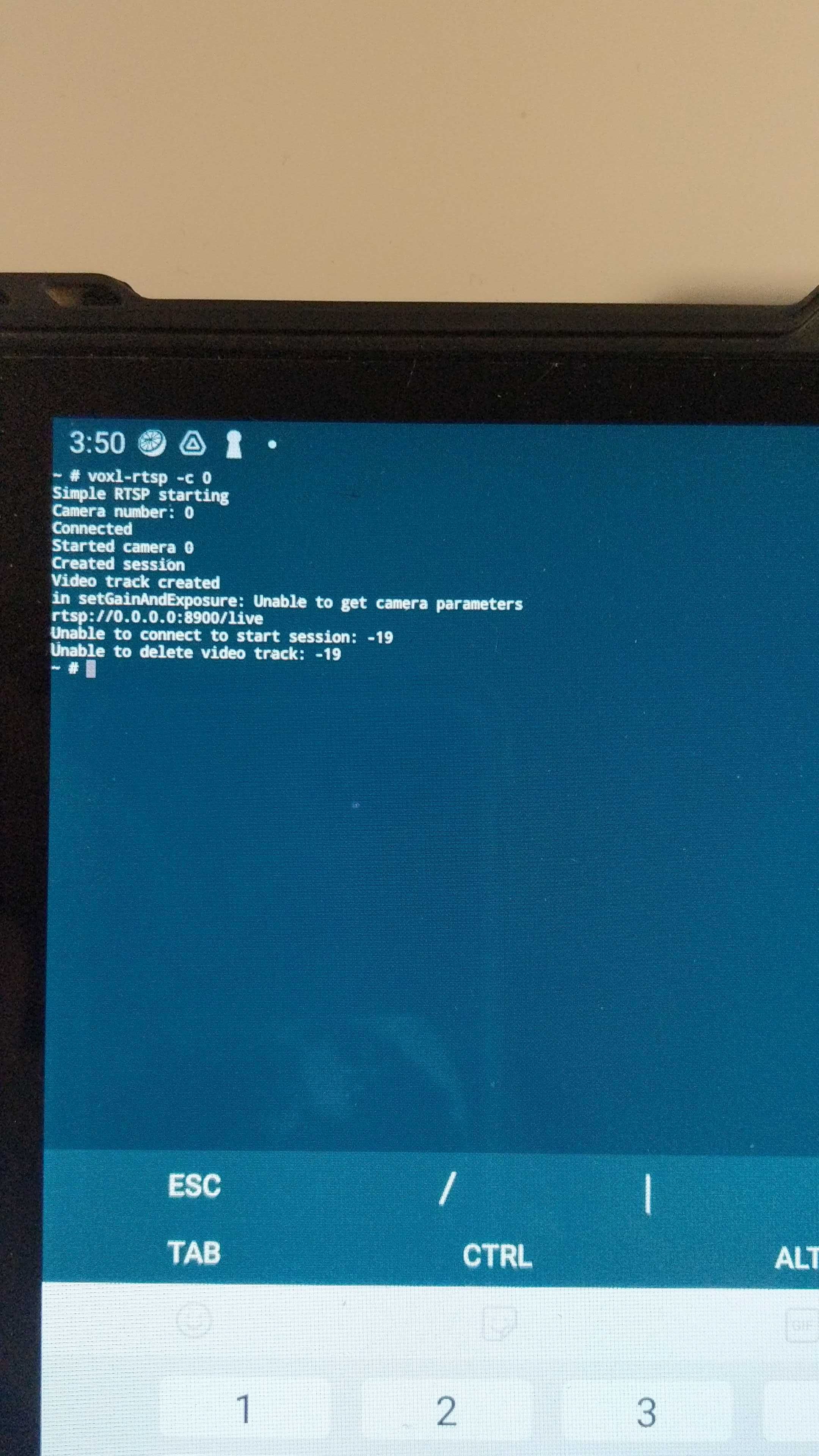

                  @Chad-Sweet I tried replacing the driver but it gave me the following error when trying to stream camera 0 IMG_20210224_155006.jpg
                  Cameras at ID 1 and 2 worked though (stereo and tracking)
                  I also configured the cameras as option 3 (Hires + Stereo + Tracking) and it issued the following result:
                  attempting to use camera configuration 3
                  adding override_cam_id value=1 to /etc/snav/camera.downward.xml
                  adding override_cam_id value=2 to /etc/snav/camera.stereo.xml
                  I also tried reverting the driver change and reset the configurations to factory settings but the issue persisted.
                  One last thing to note is that whatever camera configuration I ended up setting it to, streaming camera at ID 0 does not work anymore.
                  Any ideas on how to fix this?
                  Thanks
                    Thanks

                    Edit: reverting to original driver returns the functionality to default (upside down feed)
