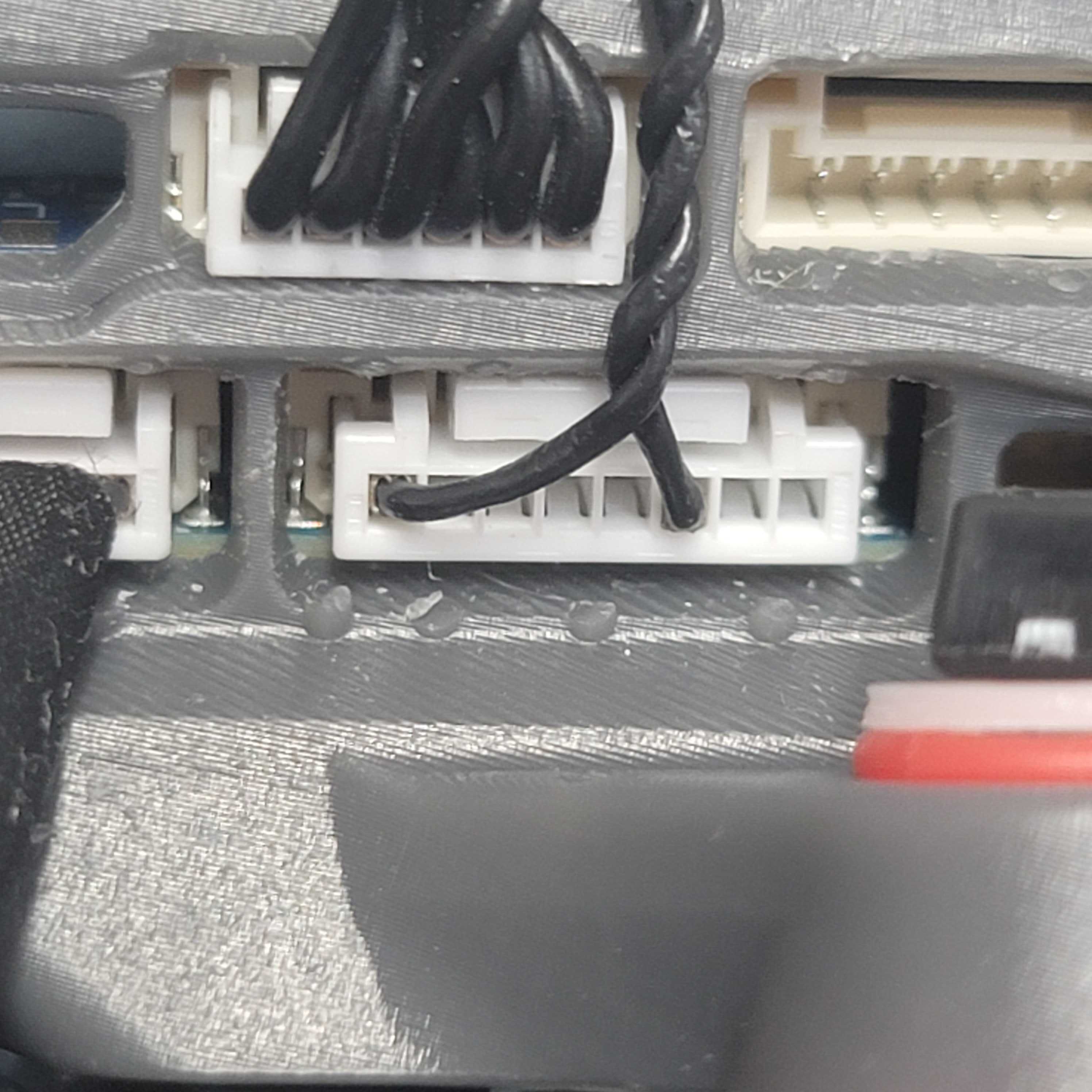

      Does your RB5 have a binding board? You can check if you have this connector. Should be on the right-hand side: 20220613_185010.jpg
      There's two different procedures for binding depending on your config.
      If you turn on the transmitter first and then the drone, does the satellite have a steady orange light?
      Can you try the binding procedure with the drone powered with a battery or run with a power supply? Might not be getting enough juice with just the ac power adapter.
      If the Spektrum satellite is not flashing orange, it hasn't started the binding protocol. Until it starts flashing then you can attempt to bind with the transmitter.

        RB5 does not look like have binding board and Spektrum RC is v1.1 per https://docs.modalai.com/Qualcomm-Flight-RB5-user-guide-pre-flight-setup/ .
        If turn on DX6e first, then power on RB5, Spektrum has a blinking orange light. Then power off DX6e, Spektrum blinking orange light goes off right away. This state leaves DX6e no chance to do bind procedure.

          Early RB5 Flight shipments came with an extra piece of hardware to assist with binding, see this doc here: https://docs.modalai.com/Qualcomm-Flight-RB5-user-guide-pre-flight-setup/#rc-radio-setup and shown in the tutorial here: https://youtu.be/zAPg070k8do

            Indeed, my bad, early RB5 has RC version 1.0. Bind successfully now after connecting AR6210 manual bind satellite. Thank you, Chad! Thank you, Adrian!
