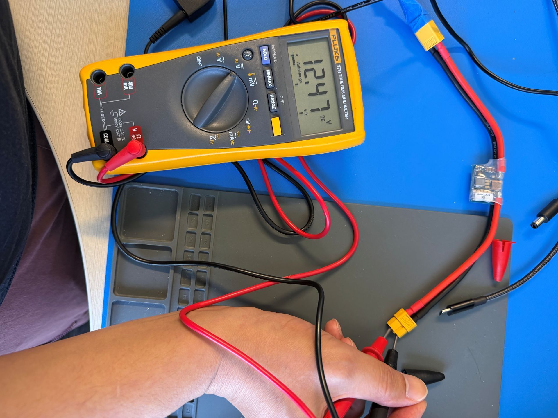

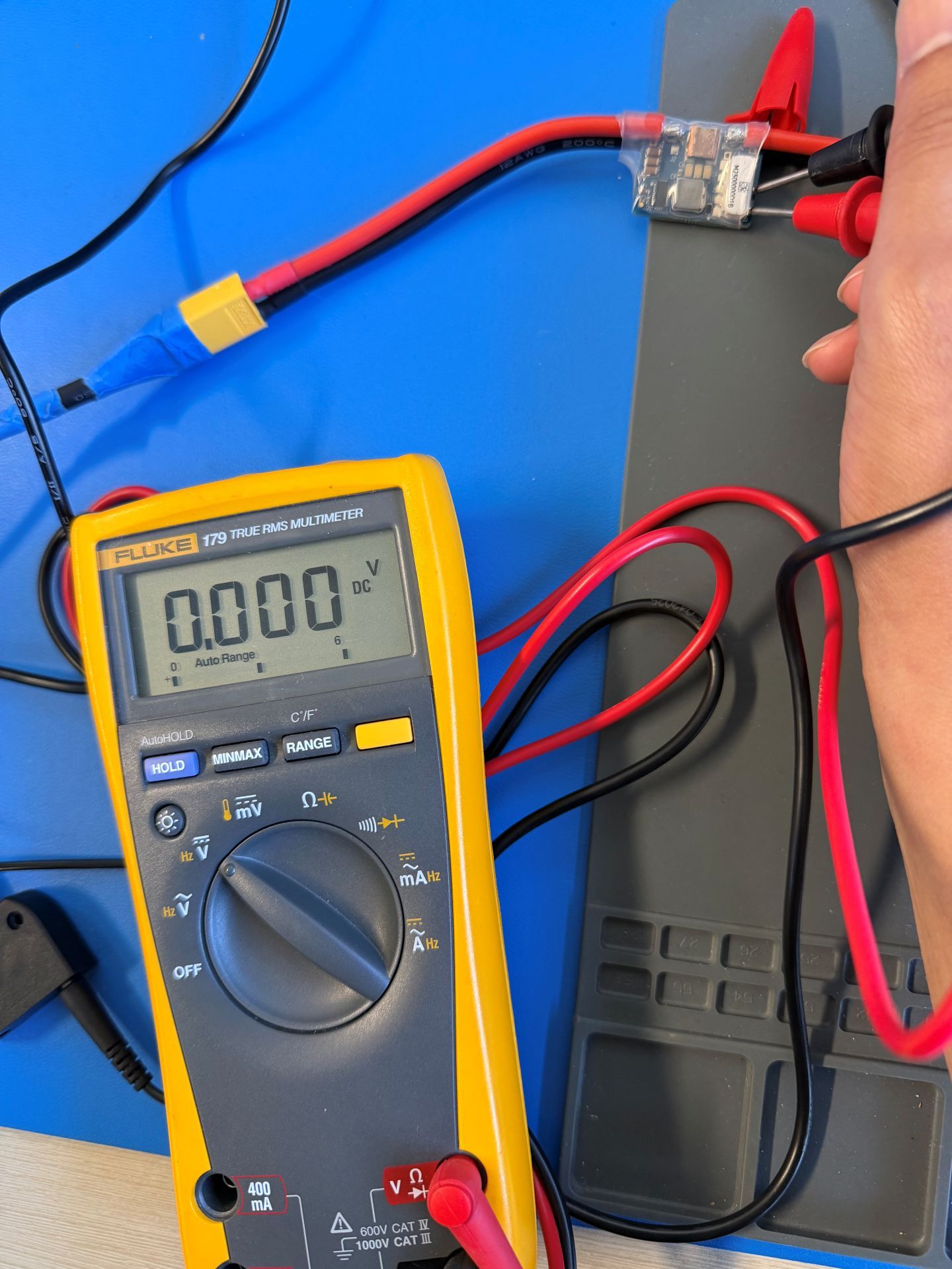

        Do you have a DMM to measure voltages out of the power module?
        You should see 5V +/-0.1V. If not, work your way back to the 12V wall adapter.
        I'm thinking most likely the wall adapter is the culprit here as that is a COTS item, whereas the Power Module and the VOXL 2 have been tested by our staff and procedures.

          The power module did not did not have a voltage on the 4 pin. I followed the diagram here:
          https://docs.modalai.com/voxl2-power/
          The 12V did have power. The issue could be with the power module? I see no signs of damage on the power module.

            Thanks @mikhail-mayers. We'll get you a replacement Power Module. That is pretty clear cut to me. I'll have someone from our Operations team reach out to you to ship a replacement Power Module. Do you happen to know your order #? Thanks!

                          Great to hear @mikhail-mayers . I tested the module you sent back and it baffles me... must be some internal silicon damage to the IC since it had all in-spec inputs, and no faults on any outputs, but it was just not turning on... so, it is now one of my Mechanical Samples 🙂
