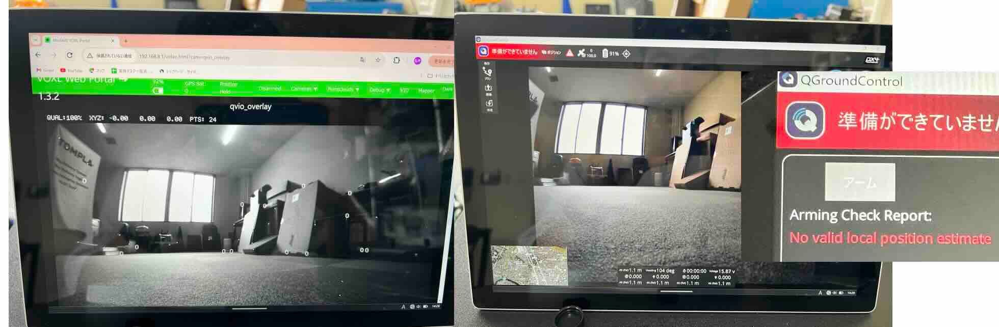

    @James-Strawson said in Starling 2 MAX with position flight mode with VOXL: NAME CURRENT NEW [1] EKF2_MAG_TYPE 0.0 5.0 [2] EKF2_EV_CTRL 0.0 15.0 [3] EKF2_HGT_REF 1.0 3.0 [4] EKF2_GPS_CTRL 7.0 0.0 [5] EKF2_EV_QMIN 0.0 1.0 I check the param that you recommend , but It is not fixed. Starling 2MAX is already set same param. Should I check another point?
