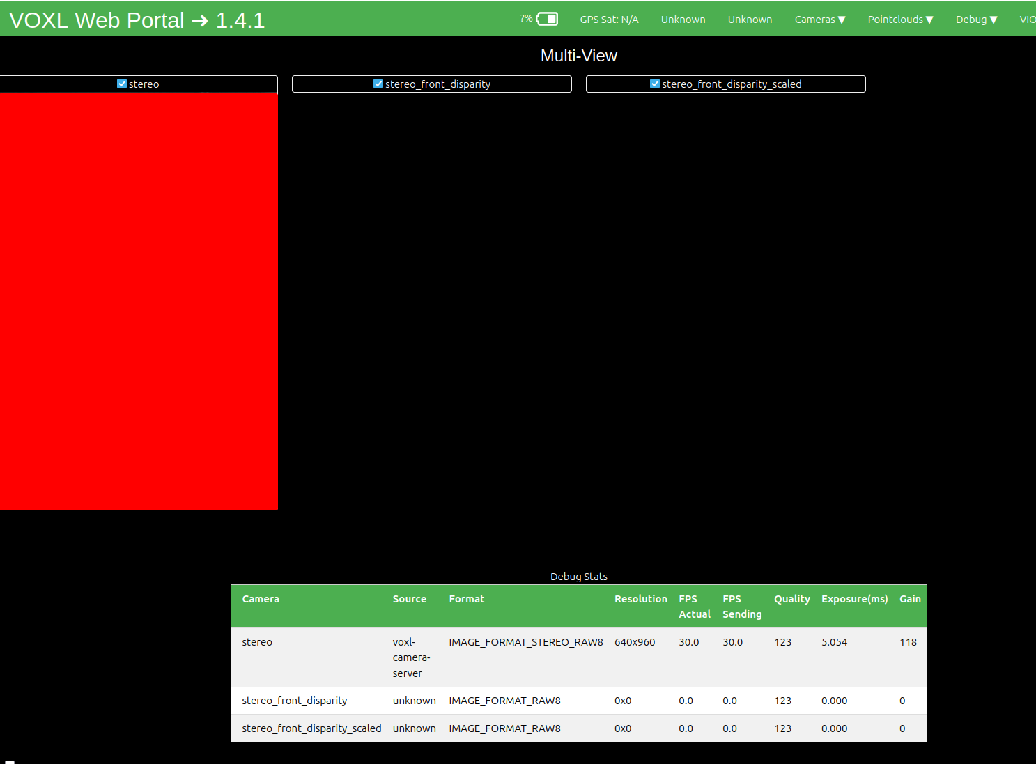

  • Tracking camera calibration not progressing
    KnightHawk06K KnightHawk06
    @Alex-Kushleyev I initially tried using an LCD screen for the checkerboard, but the camera wasn't detecting it. Should I move the camera around when transitioning between boxes on the LCD screen?
    Afterward, I reverted to the physical checkerboard and moved slowly during calibration. Additionally, I switched to the stereo camera configuration (https://docs.modalai.com/voxl2-camera-configs/#c-10-front-stereo-only-ov7251). Calibration completed successfully, and I was able to start the voxl-dfs-server (after renaming the intrinsics/extrinsics files to match the DFS configuration).
    However, I'm still not seeing valid output data in the VOXL Portal. Both the DFS server status and journal logs appear normal. Any idea what might be causing this?
    The orientation was labeled vertical in the extrinsics file, I updated it to horizontal since the cameras are mounted in that direction, I tried both.
    voxl2:~$ voxl-calibrate-camera stereo -s 6x9 -l 0.0254
    Waiting for valid pipe...
    Please open voxl-portal in a web browser to view the camera calibrator overlay stream
    Running Calibration...
    Calibrating Left Camera
    using intrinsics guess for ov7251 stereo cam
    Matrix
    [512.0490656858071, 0, 317.943082105687;
     0, 512.9677676044445, 249.1010817824914;
     0, 0, 1]
    Distortion
    [-0.2223760024137635;
     0.2834698825913266;
     0.006375005556120415;
     0.001380405690556171;
     -0.3234049381178579]
    distortion_model: plumb_bob
    Re-projection error reported by calibrateCamera: 0.618295
    Calibration Succeded!
    Calibrating Right Camera
    Matrix
    [499.9941123870856, 0, 302.2300515222531;
     0, 500.0159138740167, 197.2845691878148;
     0, 0, 1]
    Distortion
    [-0.1920328131645855;
     0.1661211129668493;
     -9.2603546772169e-06;
     -0.0005742159007090549;
     -0.1386842520292771]
    Re-projection error reported by calibrateCamera: 0.654897
    Calibrating Extrinsics
    7 frames will be processed
    Processing non-fisheye stereo
    R
    [0.9998717783469182, -0.01301971984148091, 0.009322754990917012;
     0.01315096821001574, 0.9998132816974246, -0.01415816995820597;
     -0.009136678855605861, 0.01427895782876463, 0.9998563059074108]
    T
    [-0.09106229154044132;
     0.0003557888497092847;
     -0.01247277836064075]
    Re-projection error reported by stereoCalibrate: 0.921971
    Detected horizontal stereo pair
    Distance between cameras: 0.0911
    Extrinsics Calibration Succeded!
    Saved intrinsics to: /data/modalai/opencv_stereo_intrinsics.yml
    Saved extrinsics to: /data/modalai/opencv_stereo_extrinsics.yml
    Exiting Cleanly
    cat opencv_stereo_front_extrinsics.yml
    %YAML:1.0
    R: !!opencv-matrix
       rows: 3
       cols: 3
       dt: d
       data: [ 9.9987177834691821e-01, -1.3019719841480912e-02,
           9.3227549909170124e-03, 1.3150968210015740e-02,
           9.9981328169742456e-01, -1.4158169958205966e-02,
           -9.1366788556058610e-03, 1.4278957828764632e-02,
           9.9985630590741081e-01 ]
    T: !!opencv-matrix
       rows: 3
       cols: 1
       dt: d
       data: [ -9.1062291540441320e-02, 3.5578884970928471e-04,
           -1.2472778360640750e-02 ]
    reprojection_error: 9.2197082833254862e-01
    orientation: vertical
    calibration_time: "2025-04-29 21:24:04"
    cat opencv_stereo_front_intrinsics.yml
    %YAML:1.0
    M1: !!opencv-matrix
       rows: 3
       cols: 3
       dt: d
       data: [ 5.1204906568580714e+02, 0., 3.1794308210568698e+02, 0.,
           5.1296776760444448e+02, 2.4910108178249143e+02, 0., 0., 1. ]
    D1: !!opencv-matrix
       rows: 5
       cols: 1
       dt: d
       data: [ -2.2237600241376348e-01, 2.8346988259132661e-01,
           6.3750055561204149e-03, 1.3804056905561710e-03,
           -3.2340493811785792e-01 ]
    reprojection_error1: 6.1829492384868989e-01
    M2: !!opencv-matrix
       rows: 3
       cols: 3
       dt: d
       data: [ 4.9999411238708558e+02, 0., 3.0223005152225312e+02, 0.,
           5.0001591387401669e+02, 1.9728456918781478e+02, 0., 0., 1. ]
    D2: !!opencv-matrix
       rows: 5
       cols: 1
       dt: d
       data: [ -1.9203281316458551e-01, 1.6612111296684931e-01,
           -9.2603546772168998e-06, -5.7421590070905486e-04,
           -1.3868425202927714e-01 ]
    reprojection_error2: 6.5489679777844001e-01
    width: 640
    height: 480

    Available camera config IDs are as follows:
    26 - M0173 Starling 2 IMX412 + dual AR0144
    27 - M0173 Starling 2 PMD IMX412 triple AR0144
    28 - M0173 Starling 2 Max dual IMX412 + dual AR0144
    29 - M0173 Starling 2 Max PMD + dual IMX412 + dual AR0144
    30 - M0173 Starling 2 Prototype dual PMD + dual IMX412 + dual AR0144
    36 - M0173 Stalker V5+ IMX412 + dual AR0144
    37 - M0173 Stalker V5+ IMX412 + dual AR0144 + Boson
    46 - M0173 Stalker V5+ IMX664 + dual AR0144
    47 - M0173 Stalker V5+ IMX664 + dual AR0144 + Boson
    C - use user-defined custom camera config in
    (/data/modalai/custom_camera_config.txt)
    q - Quit The Wizard
    selection: C
    Selecting custom camera config
    Camera Configuration: custom
    /data/modalai/custom_camera_config.txt: line 54: syntax error: unexpected end of file
    "version": 1.0,
    "cameras": [
    "name": "stereo_left",
    "enabled": true,
    "type": "ov7251",
    "camera_id": 1,
    "format": "RAW8",
    "width": 640,
    "height": 480,
    "frame_rate": 30,
    "preview_width": 320,
    "preview_height": 240,
    "preview_frame_rate": 30,
    "preview_format": "RAW8",
    "is_stereo": true,
    "independent_exposure": false,
    "ae_desired_msv": 35,
    "ae_filter_alpha": 0.8,
    "ae_ignore_fraction": 0.2,
    "ae_slope": 0.05,
    "ae_exposure_period": 4,
    "ae_gain_period": 4
    "name": "stereo_right",
    "enabled": true,
    "type": "ov7251",
    "camera_id": 2,
    "format": "RAW8",
    "width": 640,
    "height": 480,
    "frame_rate": 30,
    "is_stereo": true,
    "ae_slope": 0.05,
    "ae_gain_period": 4
    "hal3_buffer_manager_size": 16,
    "max_hal3_request_inflight": 8,
    "smarter_buffer_allocation": false,
    "mipi_clock_speed_khz": 384000
    General Questions
