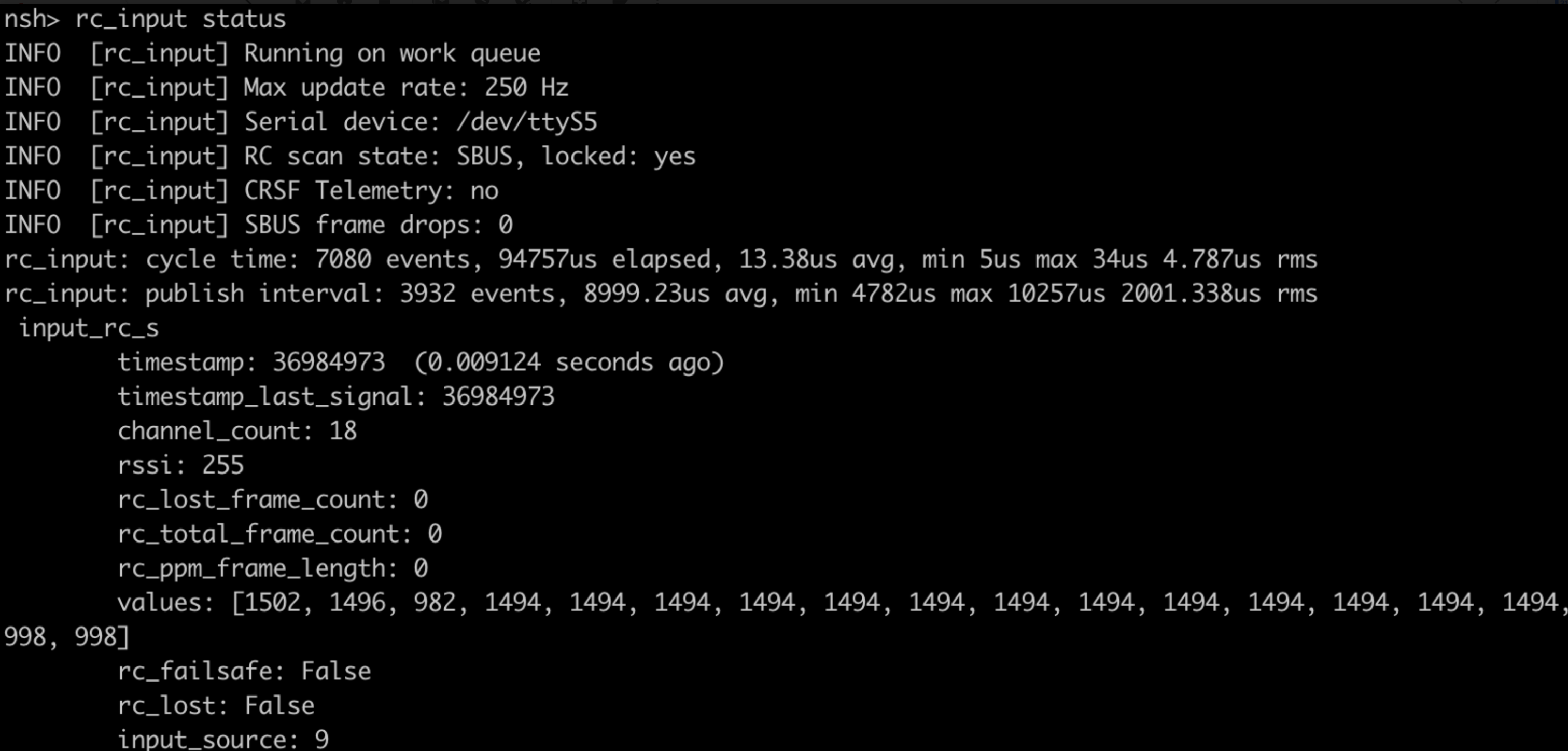

              • modaltbM
                modaltb ModalAI Team
                Can you connect the Flight Core to QGroundControl using USB, and then go to the MAVLink console? You can run rc_input status from there and check if you see anything:
