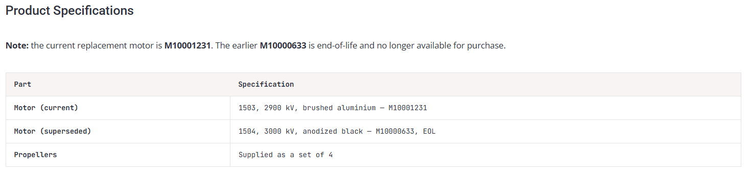

        Given that the original motor (1504 3000KV, PN: M10000633) is now officially obsolete/end-of-life (as shown in your product specs) and replaced by M10001231, we will strictly follow your advice and avoid any hardware hacks or mixing different motor specs.
