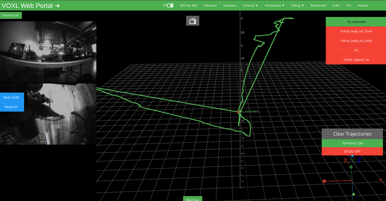

voxl-open-vins server, and I'm seeing massive drift on account of feature loss in the VIO section view invoxl-portal
I notice that myvoxl-camera-servershows the following logs when I run it from the terminal:WARNING: Pushed buffers back to pools for frame: 20093 ERROR: Received "Result" error from camera: tracking_down, frame number 20094 ERROR: Received "Buffer" error from camera: tracking_down, frame number 20094 WARNING: Pushed buffers back to pools for frame: 20094 ERROR: Received "Result" error from camera: tracking_down, frame number 20095 ERROR: Received "Buffer" error from camera: tracking_down, frame number 20095 WARNING: Pushed buffers back to pools for frame: 20095 ERROR: Received "Result" error from camera: tracking_down, frame number 20096 ERROR: Received "Buffer" error from camera: tracking_down, frame number 20096 WARNING: Pushed buffers back to pools for frame: 20096 ERROR: Received "Request" error from camera: tracking_down, frame number 20097 WARNING: Pushed buffers back to pools for frame: 20097 ERROR: Received "Request" error from camera: tracking_down, frame number 20098 WARNING: Pushed buffers back to pools for frame: 20098 ERROR: Received "Request" error from camera: tracking_down, frame number 20099 WARNING: Pushed buffers back to pools for frame: 20099 WARNING: Camera: tracking_down : dropping frame after re-init WARNING: Camera: tracking_down : dropping frame after re-init ERROR: Received "Buffer" error from camera: tracking_down, frame number 20112 WARNING: Pushed buffers back to pools for frame: 20112 ERROR: Received "Result" error from camera: tracking_down, frame number 20112 ERROR: Received "Result" error from camera: tracking_down, frame number 20113 ERROR: Received "Buffer" error from camera: tracking_down, frame number 20113 WARNING: Pushed buffers back to pools for frame: 20113 ERROR: Received "Result" error from camera: tracking_down, frame number 20114 ERROR: Received "Buffer" error from camera: tracking_down, frame number 20114 WARNING: Pushed buffers back to pools for frame: 20114 ERROR: Received "Result" error from camera: tracking_down, frame number 20115 ERROR: Received "Buffer" error from camera: tracking_down, frame number 20115 WARNING: Pushed buffers back to pools for frame: 20115 ERROR: Received "Result" error from camera: tracking_down, frame number 20116 ERROR: Received "Buffer" error from camera: tracking_down, frame number 20116 WARNING: Pushed buffers back to pools for frame: 20116 ERROR: Received "Result" error from camera: tracking_down, frame number 20117 ERROR: Received "Buffer" error from camera: tracking_down, frame number 20117 WARNING: Pushed buffers back to pools for frame: 20117 ERROR: Received "Request" error from camera: tracking_down, frame number 20118 WARNING: Pushed buffers back to pools for frame: 20118 ERROR: Received "Request" error from camera: tracking_down, frame number 20119 WARNING: Pushed buffers back to pools for frame: 20119 WARNING: Camera: tracking_down : dropping frame after re-init WARNING: Camera: tracking_down : dropping frame after re-init WARNING: no match found in fsync timestamp bufferPictures
The kind of drift I am seeing:
