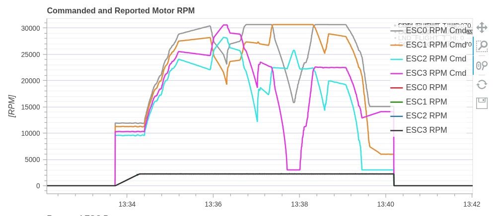

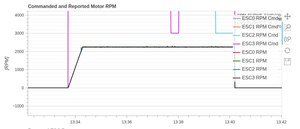

                  @jbiscan21 , can you also share the esc params that you uploaded to the ESC after ESC calibration ? I am assuming you went through this procedure : https://gitlab.com/voxl-public/voxl-sdk/utilities/voxl-esc/-/blob/master/voxl-esc-tools/calibration.md
                  From the log I see that all 4 motors spun up but the rpm is capped at about 2200 rpm, which may mean you ESC tuning params are incorrect.
                  Also note that after arming, your drone immediately commands about 10000 rpm, which is not great, because that would be a sudden jump.. you may want to check your flight mode to avoid this.
