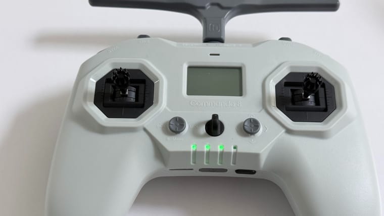

    I've bought Starling 2 Max (MRB-D0012) kit (MRB-D0012-4-V4-C29-M36-T8-K3)
    Controller included in the kit has issues during power on.
    Pressing power button resulted in charge level LED light up only. Screen is not turning on, no sound.

      Did you do a short press followed by a long press?
      • S Offline
        S Offline
        S.Hrytsenko.Rivian
        wrote last edited by
        That helped. Thanks a lot!
