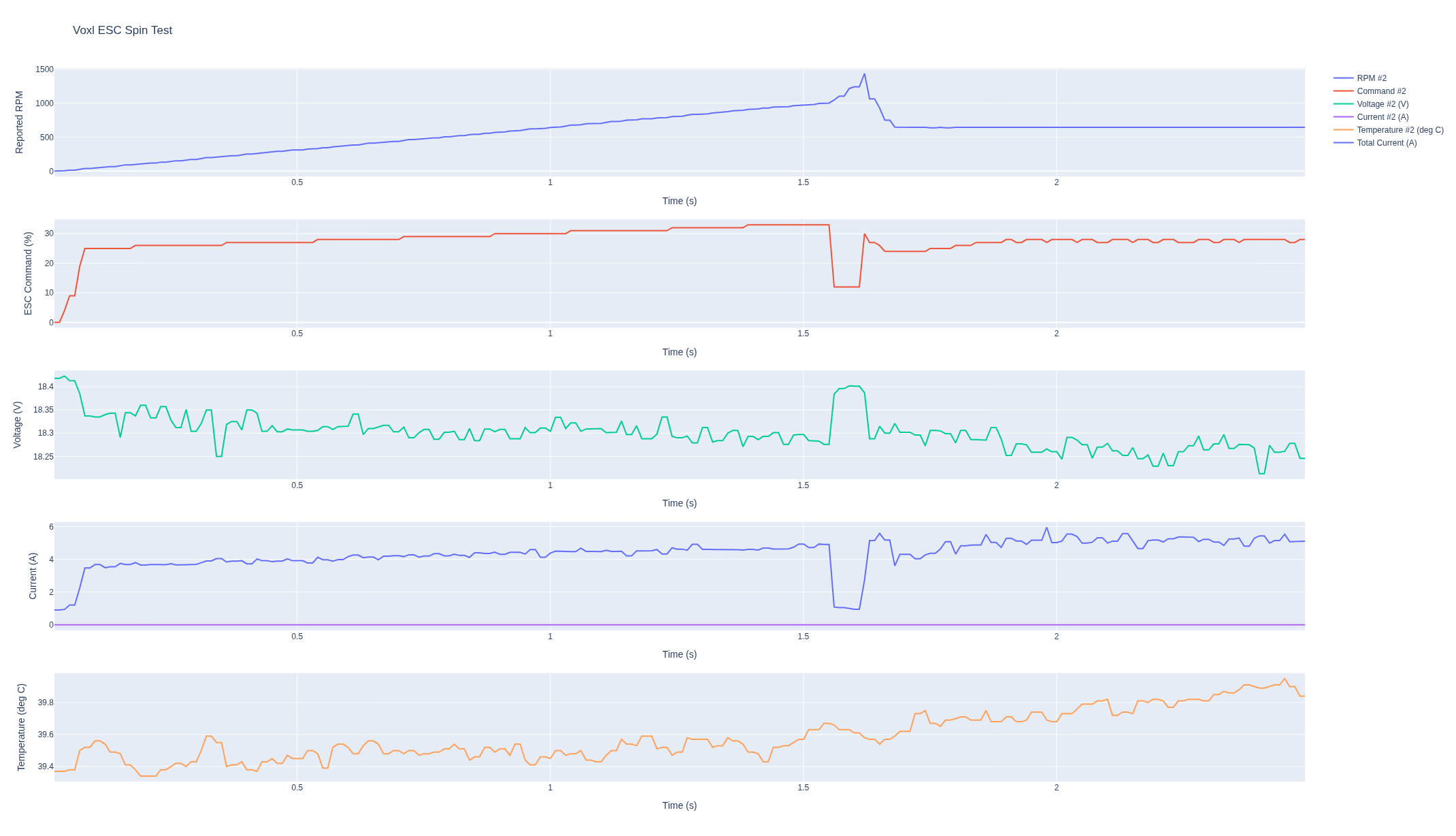

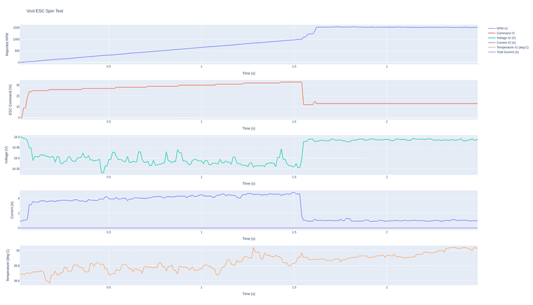

Constant RPM step from rest to 1000–1500 RPM: clean, stable.
Constant RPM step from rest to 3000 RPM: desyncs right at the spin-up→closed-loop handoff (~1.5s in, ~1000 RPM actual), gets stuck oscillating around ~640 RPM with elevated current, does not recover.
Threshold is consistent:
clean below ~2400 RPM target, desyncs above ~2500 RPM target.

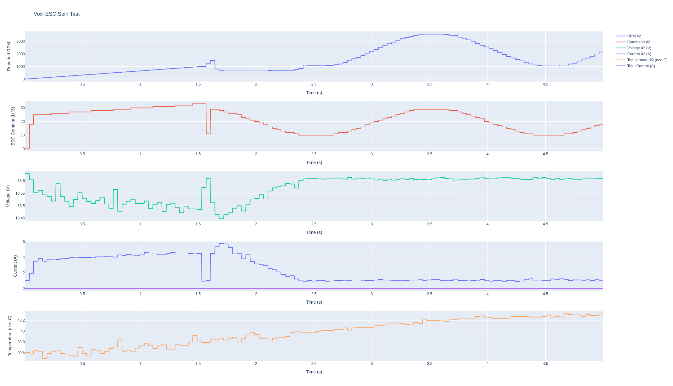

A sinusoidal power sweep through the same RPM range shows intermittent desync but does recover — likely because the commanded value keeps sweeping back down, unlike a fixed high target.python3 voxl-esc-spin-step.py --id 2 \ --power 20 --step-amplitude 10 --step-frequency 0.5 \ --waveform-type sinusoidal --cmd-rate 500 \ --temperature-limit 70 --timeout 5 \ --skip-prompt true --enable-plot 1

39.RC11,39.25, and39.26python3 voxl-esc-spin.py --id 0 --rpm 2500 --timeout 2.5 --skip-prompt true --enable-plot 1The same command on the same motor/ESC does not desync on an older firmware version:
Board : version 42: ModalAi 4-in-1 ESC (M0138-1) UID : 0x2030303355465716005A003A Firmware : version 39.00, hash e4f576a0 Bootloader : version 184, hash e1c038deQuestions for you:

I've rerun the above ramp tests with the RC10 firmware but the same desync event is occuring.
It's a 650kv motor with tests ranging between 18 - 19 V from a 5S battery into the ESC board.To be clear this is unloaded. Repeating this exact test with load on the motor (i.e. prop) the desync event does not occur.

One more request, are you able to repeat the same test with the original firmware (that currently works) and set the
demag_timingESC parameter to 0. This was a feature originally put in for testing to help with low kv motors, but we later decided that this feature was not complete / robust enough to cover general use cases and it was removed. I am curious if it is helping in this case.Alex
