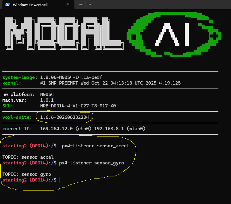

          @Eric-Katzfey It is a custom drone with three tracking cameras and one IMX412. Here is a screenshot with the suite code and the response to the suggested commands.
