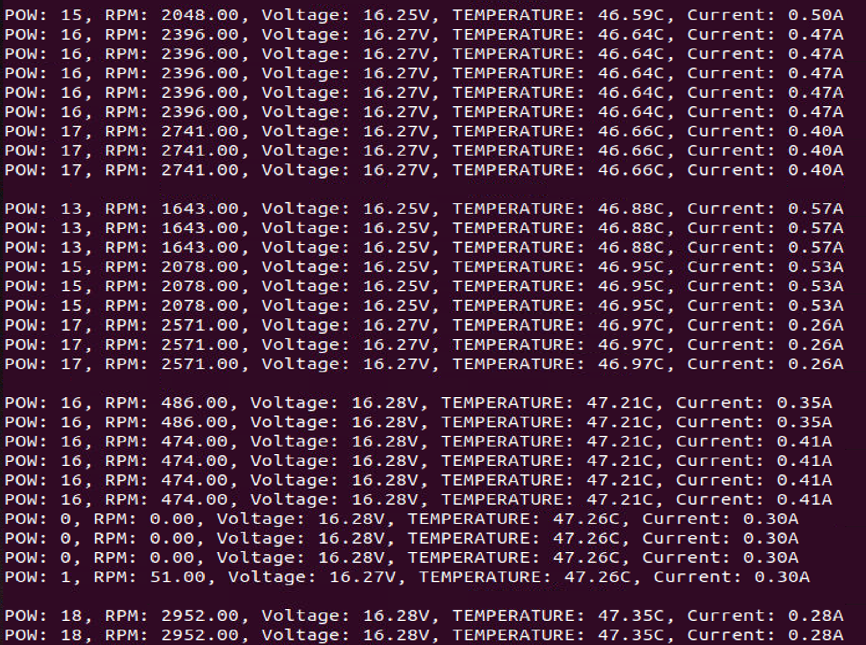

Good motor spin:

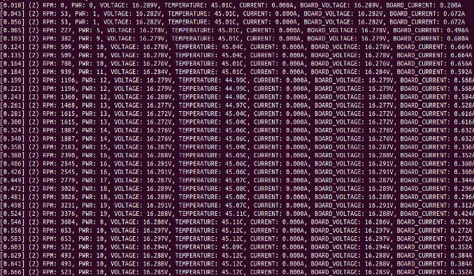

Bad motor spin:
I think it is a bad ESC, but need your guidance if this can be fixed. The output when running this motor is different: it shows extra BOARD_VOLTAGE, and BOARD_CURRENT fields when spinning. Also it knows the RPM keeps going to zero.

Good motor spin:
Bad motor spin:
Hi @qubotics-admin ,
Between the two tests, i see that one test shows 16V input voltage and the other test ~7.2V. Was the voltage applied to the ESC the same during the tests (and the ESC read it incorrectly) or the voltage was in fact different?
Such a big difference can have adverse affects on spin-up if the change in voltage is not accounted for in the esc tuning param file.
It is possible that if the ESC does not have correct parameters for your motor / propeller, the sinusoidal spinup does not have enough power and loses tracking during the spin-up phase and fails to transition to steady-state spin stage.
The ESC channel 2 on the FPV ESC is the only channel that measures the total board current, so that is why the printout is slightly different when you test the channel 2.

Regards.@qubotics-admin , thanks for doing the motor swap test. From this result, it does appear that one of the ESC channels is not working properly. We would like to take a look at the ESC - are you able to send it back for inspection? We can send you a replacement ESC in return.
