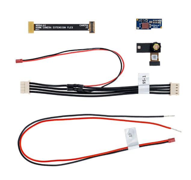

There is a way to make the TOF V2 work on VOXL2 mini, however it is a bit of a hack (which temporarily enabled a transition to the new TOF V2 while using old camera connectors, which did not provide enough power).
- https://www.modalai.com/products/m0178?variant=48528287826224
- basically this configuration uses M0169 adapter (instead of M0178). https://docs.modalai.com/M0169/
- M0169 requires a power input of 5V ideally 1.5A, provided via the 2-pin JST connector. If you were using a voxl2, then you can use the provided 4-pin power cable with a split connection for the TOF sensor. In case of VOXL2 mini, since it accepts 3.8V input, you will need a separate 5V supply.
- M0169 can be connected to M0076 or M0135 camera interposers using the standard flex cables, such as M0074 (comes with this kit), M0036.
Note that if you use M0195 camera front end (or M0188), then you will not be able to use the TOF V2 because both camera connectors on voxl2 mini would be used up.
What's included in M0169 kit (from our shop page linked above)
