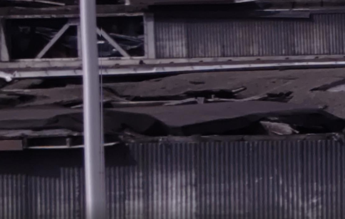

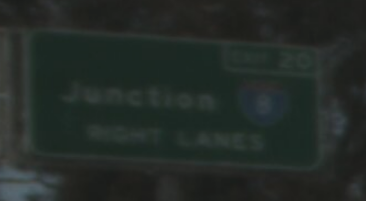

    In general, the pixel noise increases as you the pixel gain is increased. Part of Auto Exposure control is controlling exposure time and gain (both of which contribute to the image brightness), but higher gain has higher pixel noise and higher exposure values will result in motion blur.
    The Qualcomm ISP has lots of liters, including noise reduction, which are applied when you use the ISP snapshot (even though they have not been tuned for the particular camera, the ISP output may result in better de-noised image). There are several types of filters, for example spatial (such as bilateral filter) and temporal (TNR - temporal noise reduction), and it's usually a combination of both with the filter weights increasing as the gain increases (more noise requires more noise reduction).
    Currently, MISP does not have any de-noise filtering, but we are working on adding some. That is why i was discussing with you the ability to process the image offline (from the original bayer source). You could save the full raw image and perform any filtering you need in post processing. This approach is similar to using a RAW image on a fancy camera and then importing that into image processing software on a laptop / desktop, which can perform a lot more filters / effects directly on the raw image (loss-less).
    What i suspect is that you are testing in the low-light environment and you are seeing the effects of high gain (high pixel noise). the MISP auto exposure tries to balance exposure and gain and there are a few parameters for that, but in your tests you should see what exposure and gain values the camera is at when you see the noisy image. You can use voxl-portal to control exposure and gain to see what the difference is. I believe the max gain for ov64b is 16x (1600).
    I am about to set up your use case again for testing and i will investigate the noise and the original ISP snapshot artifact and we can also compare the image noise from the ISP snapshot and misp snapshot.
    Unfortunately the lens for ov64b in the Hadron unit is very small, which reduces the amount of light that gets into the sensor. The sensor is 8+K resolution which means the pixel size is small, so the amount of light that gets to each pixel is small. To compensate for that, we would typically want a larger lens, but it is probably not possible to change the lens in this specific Hadron unit (we have not tried).

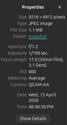

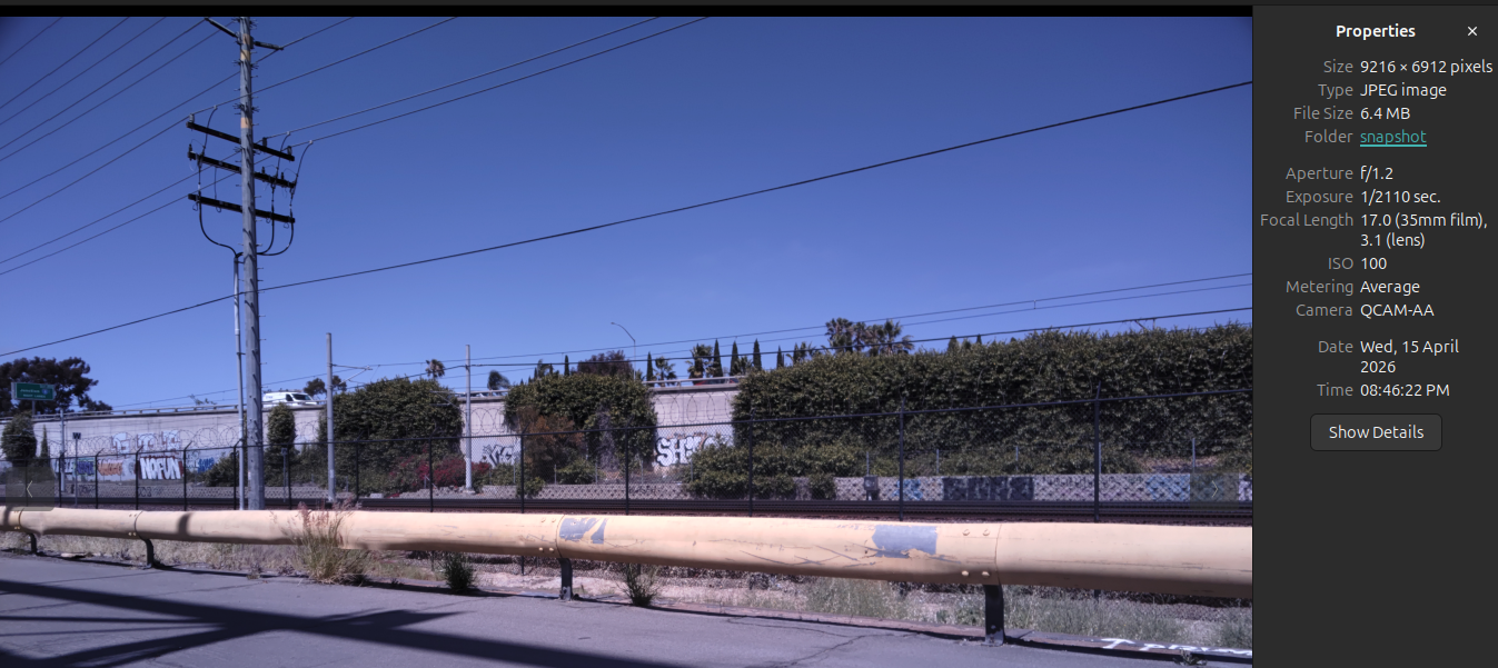

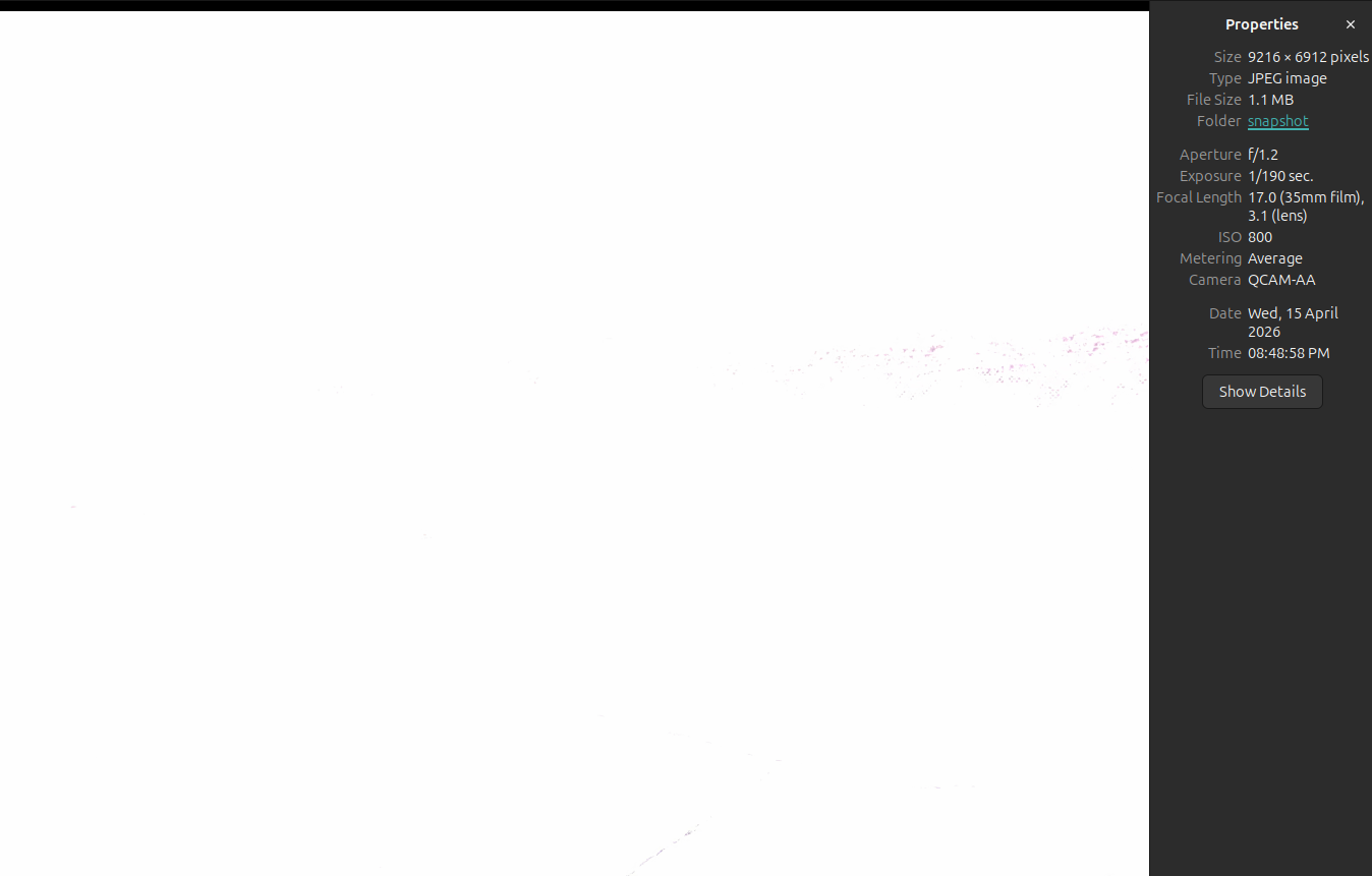

            @Alex-Kushleyev I have been doing some tests and the updates to the camera server and mpa tools seem to work great, thank you! What I meant about the metadata not recording is this data only shows up when using the snapshot command, and does not show up when using the jpeg flag in the voxl-record-raw-image command:
            Also noticed the auto exposure doesn't seem to settle unless the camera's feed is opened on the voxl-portal. Here are two images I took - voxl-camera-server was running for a considerable time before taking either one.
            Before looking at the live stream in the portal:
            After looking at the stream in the portal for a few seconds (I could see the exposure settle down)
            Didn't mess with voxl-camera-server at all in between taking the two images.

                      @Alex-Kushleyev Also just noticed the vertical artifact again. The artifact is only present in the snapshots and not the raw images saved as jpeg - will definitely need those post processing scripts now.
                      Here is the raw image:
                      And here is the snapshot:
                      • C cguzikowski

                        @cguzikowski , thanks for following up.
                        I don't know why the ISP is outputting the jpeg with the issue - that is outside of our area of expertise. It could be a bug in the ISP or JPEG encoder.
                        I will get together some scripts i have been using for testing. I need add the LSC (lens shading correction) otherwise the colors look wrong and also image gets darker towards the edges. In order to apply LSC correction, we need a map (either look-up table or a poly fit) of each channel's response as a function of pixel coordinate (or radius) -- this needs to be calibrated (not for each camera module, but for each camera type + lens type). So after the calibration, my results should apply to your camera as well.
                        I will follow up early next week.
