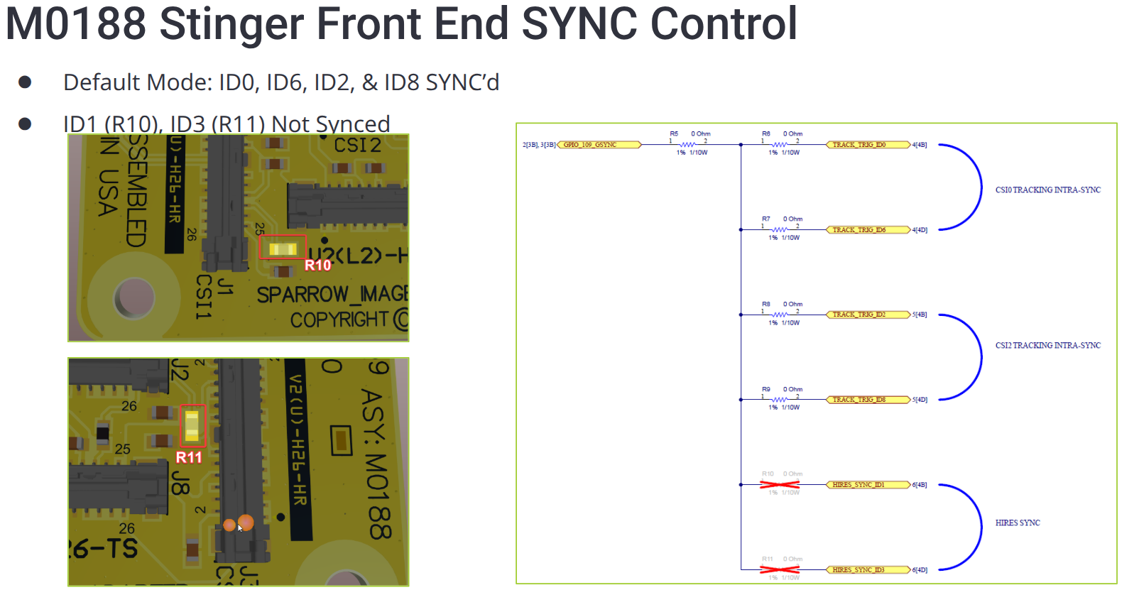

      @cbay I got it working by swapping it to ID's 0-3 (2 on the hires lines).
      Any known issues with doing this for use in VIO?

        @cbay , yes this should work.
        Whenever you add cameras of the same type, you should always check for possible I2C (CCI) conflicts. If you look here https://docs.modalai.com/M0188/#image-sensor-interfaces , the sensor IDs 0,2,3,6 (which is what you use) use unique CCI buses 0-3, so that is all good.
        If you used ID 1, it would conflict with with another AR0144 on ID6 (both use CCI1)
        One last thing to check is the sensor sync.
        • if you see fsin in the configuration of the sensor (and name of the sensormodule in /usr/lib/camera/), it means it is set up as a sync slave
        • currently you have the IDs 0 and 6 set up as sync slaves, but ID 2 and 3 as free-running
        There are two issues enabling sync'ed drivers for AR0144 in ID 2 and 3:
        • the driver is provided only for ID2 in : /usr/share/modalai/chi-cdk/ar0144-fsin/ - this is easy to fix
        • ID1 and ID3 on M0188 do not have the sync line connected to the camera connector
          • this is easy to fix by installing a 0-ohm resistor, which is DNI by default.
        Depending on your requirements for VIO (which VIO are you using?), you may or may not need the cameras synchronized.
        Please let me know your requirements and we can go from there..
        C 1 Reply Last reply

            @cbay , OK got it.
            In order to synchronize all 4 cameras, you will need:
            • use fsin sensormodules for camera slots 2 and 3 -- i will need to provide one for slot 3
            • add a resistor to actually enable sync signal for slot 3 (will provide a diagram for M0188)
            Meanwhile, you should be able to enable sync for camera slot 2 by using the following sensormodule:
            /usr/share/modalai/chi-cdk/ar0144-fsin/com.qti.sensormodule.ar0144_fsin_2.bin instead of com.qti.sensormodule.ar0144_2.bin -- just replace it in /usr/lib/camera/
            Also, we have a tool for checking camera sync (you may have to build it yourself from this branch) : https://gitlab.com/voxl-public/voxl-sdk/utilities/voxl-mpa-tools/-/blob/add-new-image-tools/tools/voxl-check-cam-sync.c -- this is a quick way to check if the timestamps of the frames are aligned.

              cross-posting the reply here as well, since this is more relevant thread:
              I have uploaded the latest ar0144 drivers with fsin versions for all camera slots here : https://storage.googleapis.com/modalai_public/temp/ar0144/ar0144_drivers_20260402.zip
              There are two additional files (inside the zip), which you should copy to /usr/lib/camera to make sure you have the latest updates:
              • com.qti.sensor.ar0144.so -- contains functions for exposure / gain control (we recently made some improvements to make gain control smoother)
              • com.qti.tuned.default.bin -- fixed gain scaling so that min gain (1.0x analog gain) is equal to 100 in the HAL3 gain units, not 54 (and the max gain will be 29.6 = 29600 for AR0144) -- you can also double check this using voxl-camera-server -l and update the min/max gain settings in your voxl-camera-server.conf to make sure you are using the full range.
              My colleague will follow up with a diagram for locations of the DNI resistors that need to be installed to enable sync signal for camera slots 1 and 3 (0402 0-ohm resistor)

                @cbay ,
                Here is the diagram for M0188 showing resistor R10 and R11 that need to be added (0 ohm) in order to connect the sync signal to the camera slot 1 and 3.
                For some historical reasons, these resistors were DNI'ed in order to prevent (incorrectly configured) hires cameras from outputting a sync signal and interfering with the tracking cameras.
                Please be careful when adding the resistors, as spacing between components is pretty tight.
                We will update the docs for M0188, M0195 and M0173 to reflect the default state and how to enable the sync on the camera ports that do not have it already connected.

                  @Alex-Kushleyev Thanks so much, we have the resistors on the way, will let you know how this goes.
                  Once this has been done, I would assume we would have no issues getting all of the cameras working with OpenVins
