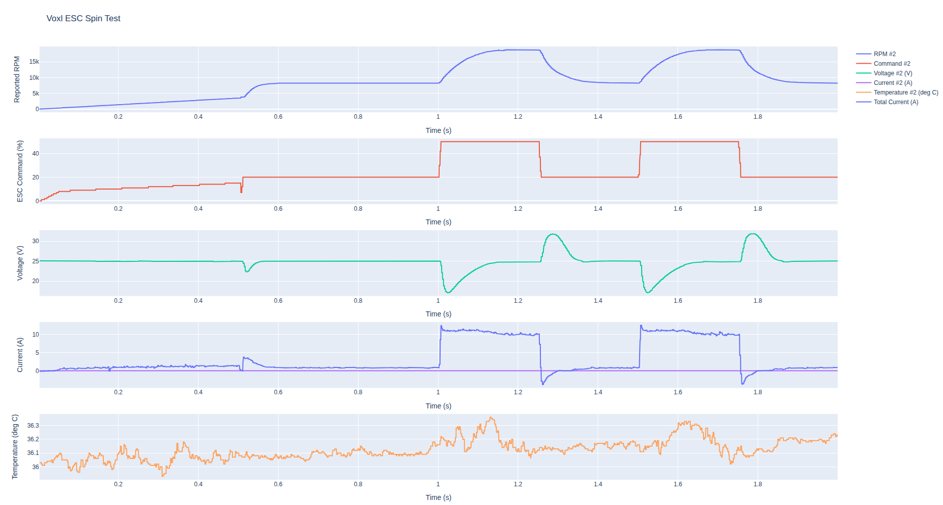

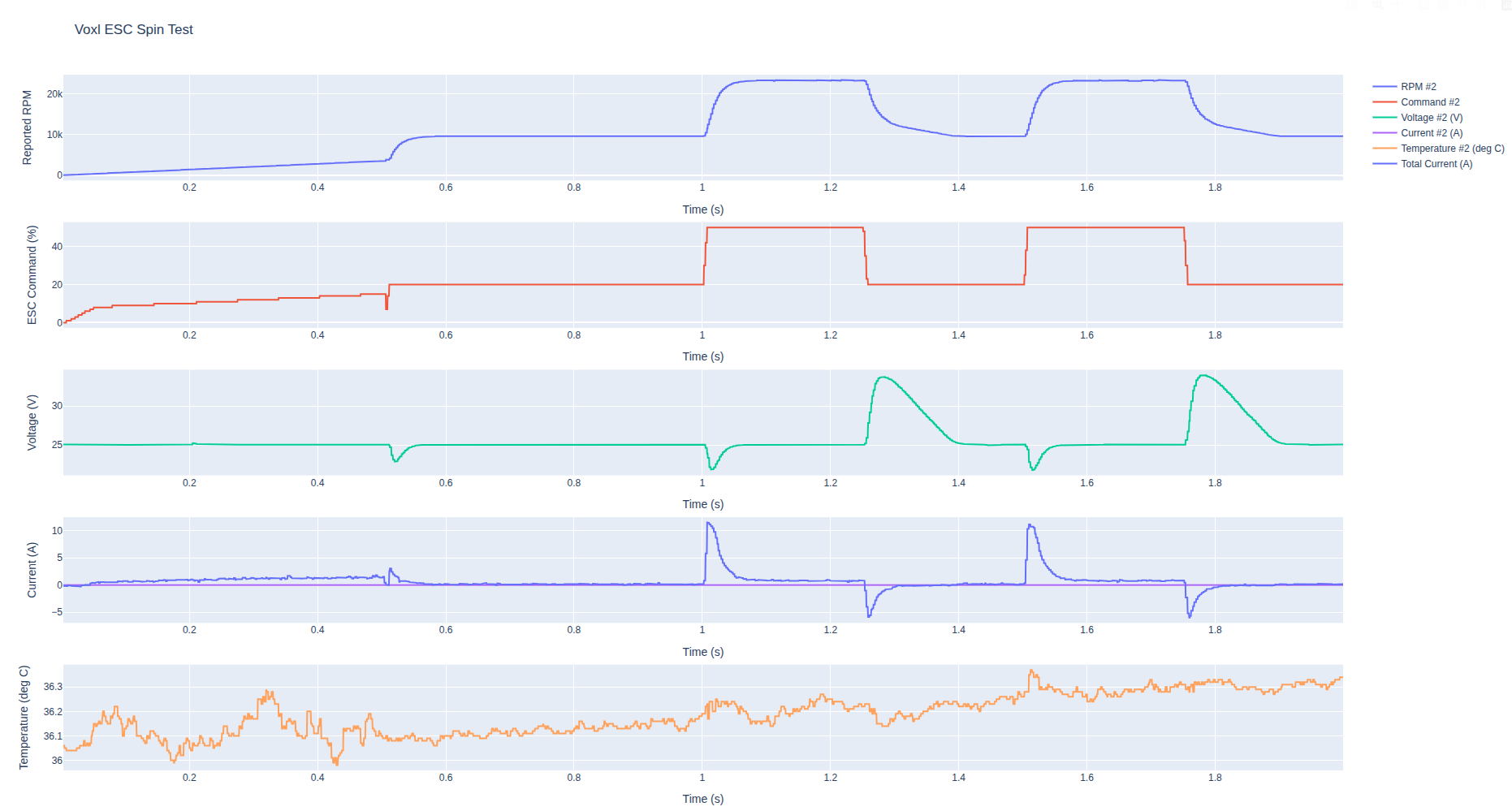

          I went ahead and ran a few tests with a 11A power supply set to 25V.
          Using M0138 ESC, Xing2 2207 1855kV motor and 5x4x3 propeller
          Both tests using the same voxl-esc command, executed on a linux pc that is connected to the ESC directly via usb to serial adapter.
          Test command:
          ./voxl-esc-spin-step.py --id 2 --power 20 --step-amplitude 30 --step-frequency 2.0 --timeout 2.0 --cmd-rate 2000 --enable-plot 1
          Results / notes:
          • no load test showed a higher peak of 33.8V vs about 31.8V loaded with prop, which actually makes sense because the no load motor RPM is higher (larger back-emf).
          • only testing one channel at a time to reduce voltage spike
          • start with small step to get a sense of regenerative voltage rize
          • short test to avoid any damage
          • ran the test on ESC id 2, so that total current is measured and displayed
          • this motor has pretty high kV and small size propeller, so it decelerates quickly. However, other motor and larger propeller combinations (and larger rpm changes) may generate a lot larger spike (if the motor spends more time at higher rpms).
          • also did a test to see at which point the ESC starts drawing more current - TVS diode starts conducting (short voltage increase on the power supply, i.e. for 1 second). As the TVS diode warms up, the current drops a bit because of the diode characteristics (breakdown voltage increases with temperature). However, the performance of TVS diode varies significantly across the voltage range, so it cannot be used for any exact measurements.

          Test 1: no propeller
          Test 2: with propeller

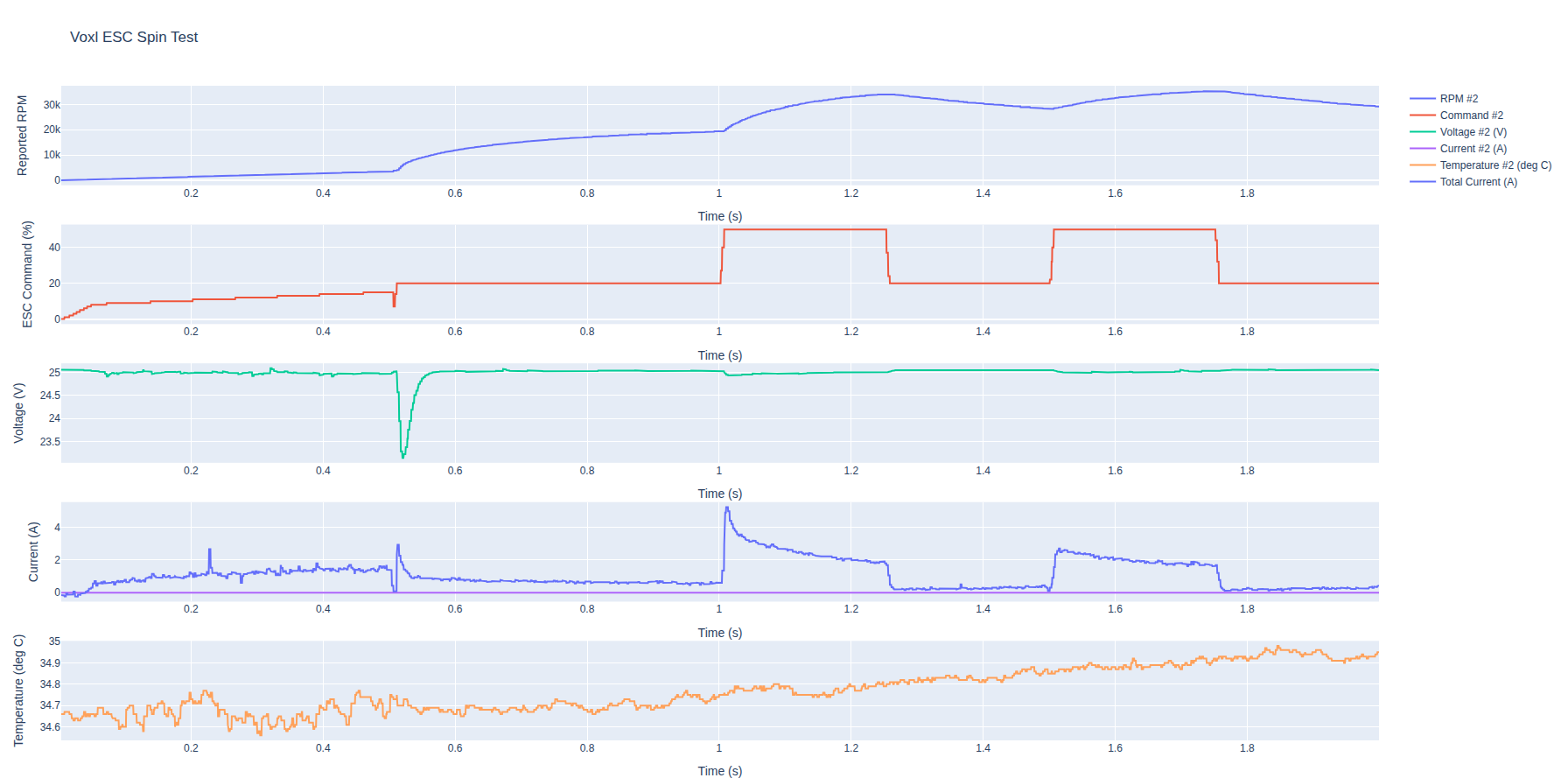

              @austin-c , i just checked and actually we have an option to disable regen braking, it is just not available yet via a param. Here is the test result with same setup (no prop) with regen braking disabled. You can see that the motor takes a long time to coast down, but there is no regen voltage spike or regen current at all. If you application does not require rapid rpm change (high to low), then it will work fine.
              We have not tested this in a while, but at some point we did testing for an application with a smart battery which did not like being re-charged with the regen current.
              I will see if we can enable this via param or worst case scenario I can share the latest firmware with regen off.
