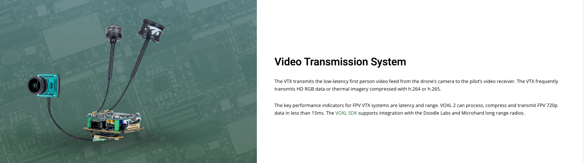

    Hi Everybody.
    I'm trying to get a better understanding of how the Video encoding latency gets down to 15ms with Doodle Labs integration? I recognize these are two separate statements that are in the same paragraph so it may not be possible.
    Has there been any improvements to Doodle Labs Mini OEM getting a lower latency below 100ms? I'd love to test this out myself.

      @Demarconius Yes, we can achieve ~50ms glass to glass using our VRX and voxl-vtx software service on the UAS-side.

        @Moderator
        Thanks for the clarification on the ~50 ms glass-to-glass number.
        Trying to get a better understanding the performance envelope:
        1. Does the 50 ms include RF transport over Doodle, decode, and HDMI output latency, or is that measured only within the VOXL + VRX software stack?
        2. Was this measured in point-to-point mode or mesh routing mode?
        3. Can you expand on bitrate, resolution, and encoder settings were used (GOP structure, B-frames disabled, UDP vs RTSP)?
        4. Is MAVLink or other traffic running on the same link during that measurement?
        5. Do you have a latency breakdown per stage (encode / RF / decode / display)?
        Appreciate any information you can provide. I just want to make sure I can test and validate this effectively.
