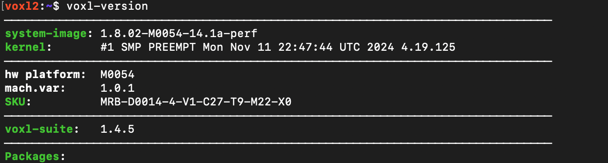

          Hello, please provide your platform specs and sdk version.
          Nitin Varma VegesnaN 1 Reply Last reply Reply Quote 0
          • Nitin Varma VegesnaN
            Nitin Varma Vegesna @zauberflote1
            @zauberflote1 said in OpenVINS issue:
