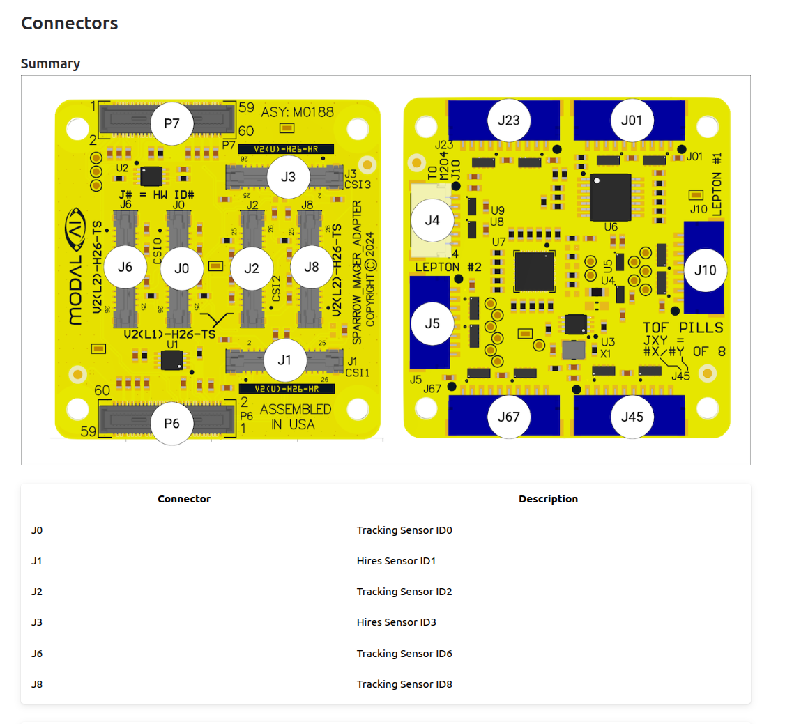

    @Alex-Kushleyev If I dont need to change the CCI to use 4 tracking camera's with M0188, then I am not going to bother to do so with the M0173, I will just run 3 cameras in the meantime.
    Am I right to believe that M0188 can allow me to run 4-AR0144, 2-Leptons and 1-Boson+?

      @cbay , M0188 does NOT support a Boson sensor, which has different power requirements (compared to tracking, hires cameras) and uses different pinout of the same micro coax port type.
      M0195 supports 4 cameras + Boson https://docs.modalai.com/M0195/ , but the Boson takes ID2 (CCI2), meaning you would have to put AR0144 cameras on IDs 0,1,3,6 and IDs 1 and 6 would still have a CCI conflict (CCI1). So you would still need the alt slave address for one AR0144.
      Boson can only be connected to J2 of M0195, as documented.
      Let me check about the dual lepton. It is documented, but i just want to confirm that it works.

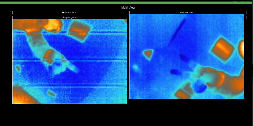

                      @Alex-Kushleyev Hi, I'm working with @cbay on this project and I just wanted to report that I was able to modify voxl-lepton-server with your suggestions and achieved dual lepton camera streaming into voxl-portal.

                        @Haxerus , that's great to hear! Can you clarify what you did? I am guessing the following:
                        • modify voxl-lepton-server to run multiple instances
                        • disable i2c interface for the second lepton
                        Also, the image on the left seems noisy (horizontal lines)? I am not sure what it is, something to check.. (is it always present, what about when only single lepton is running).
                        Do you need anything else for any next steps?

                          @Alex-Kushleyev sure thing. As per your suggestion, I modified voxl-lepton-server by moving all the Lepton camera-specific logic into a C++ class and added locks to any I2C operations to prevent race conditions. I then just created 2 instances of the LeptonCamera class I made which parse and publish the camera feeds to their own pipes which I can view in voxl-portal.
                          I didn't need to disable any I2C interface for the second Lepton. I'm not too sure what you were referring to by that.
                          In regards to the horizontal line artifacts, those don't seems to consistently appear and I don't know what causes it. I'll investigate it further.
