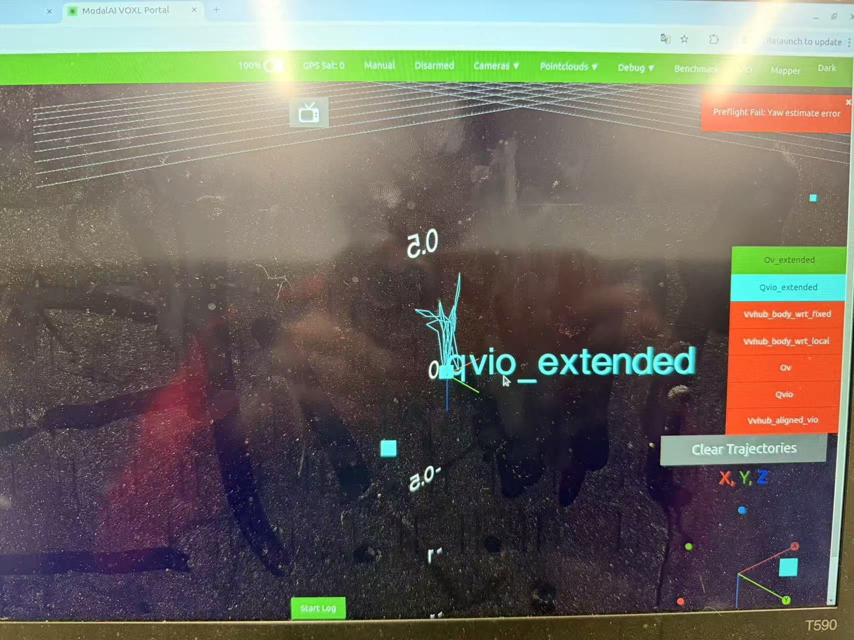

      we have got a starling 2 max and enabled the qvio service. In GUI the qvio outputs good odometry:

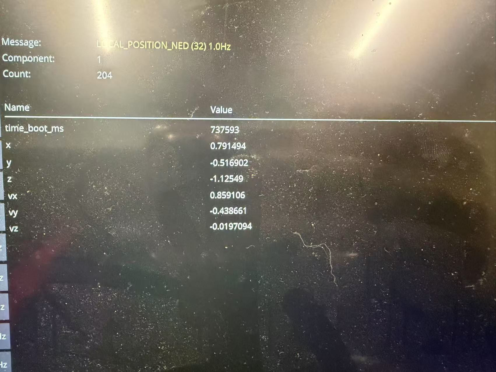

      However, in px4 mavlink list, we cannot find the odometry mavlink message. And the local position estimate gives very high velocity even when the drone is static:

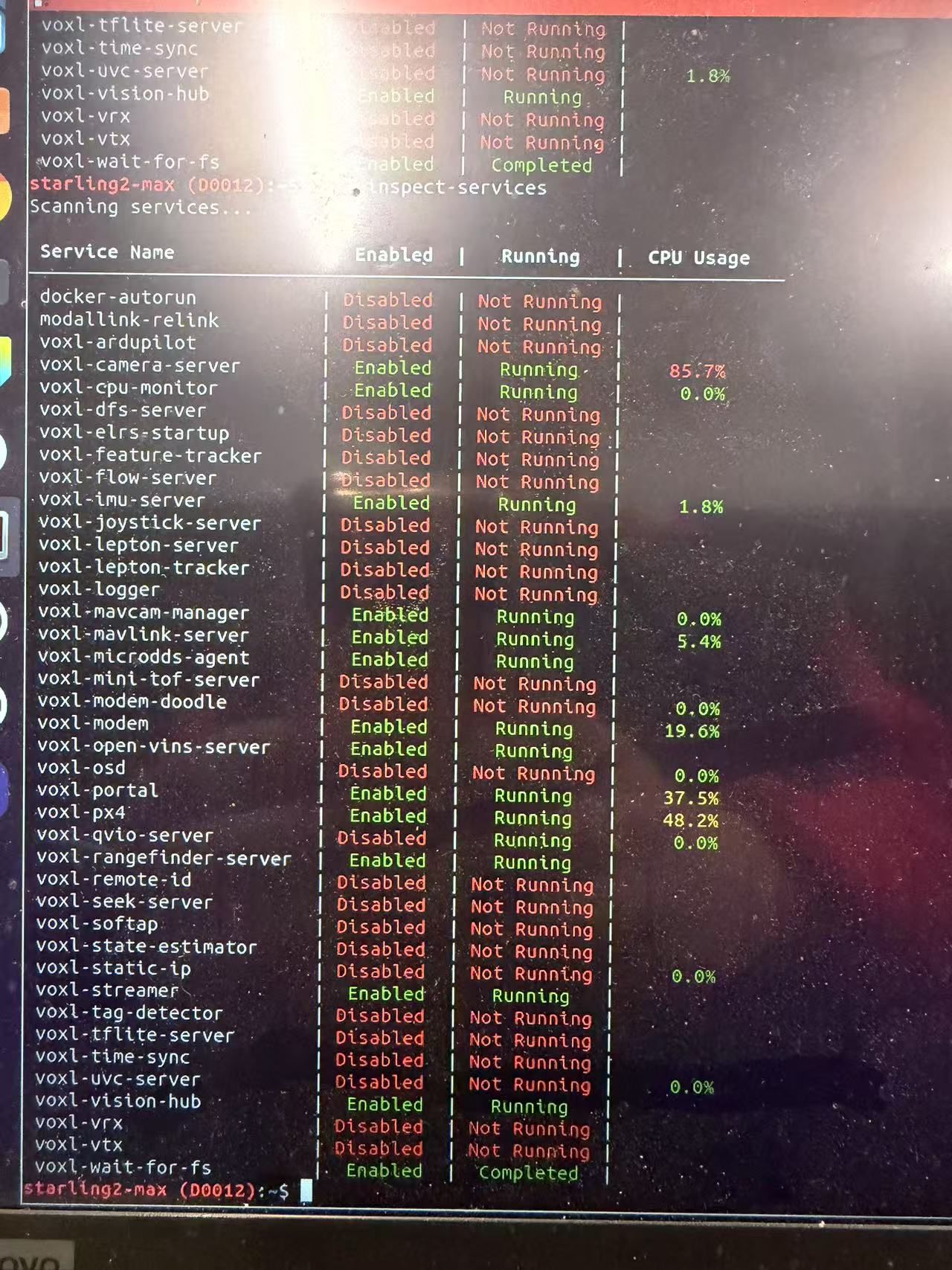

      This is the list of qvio services running:

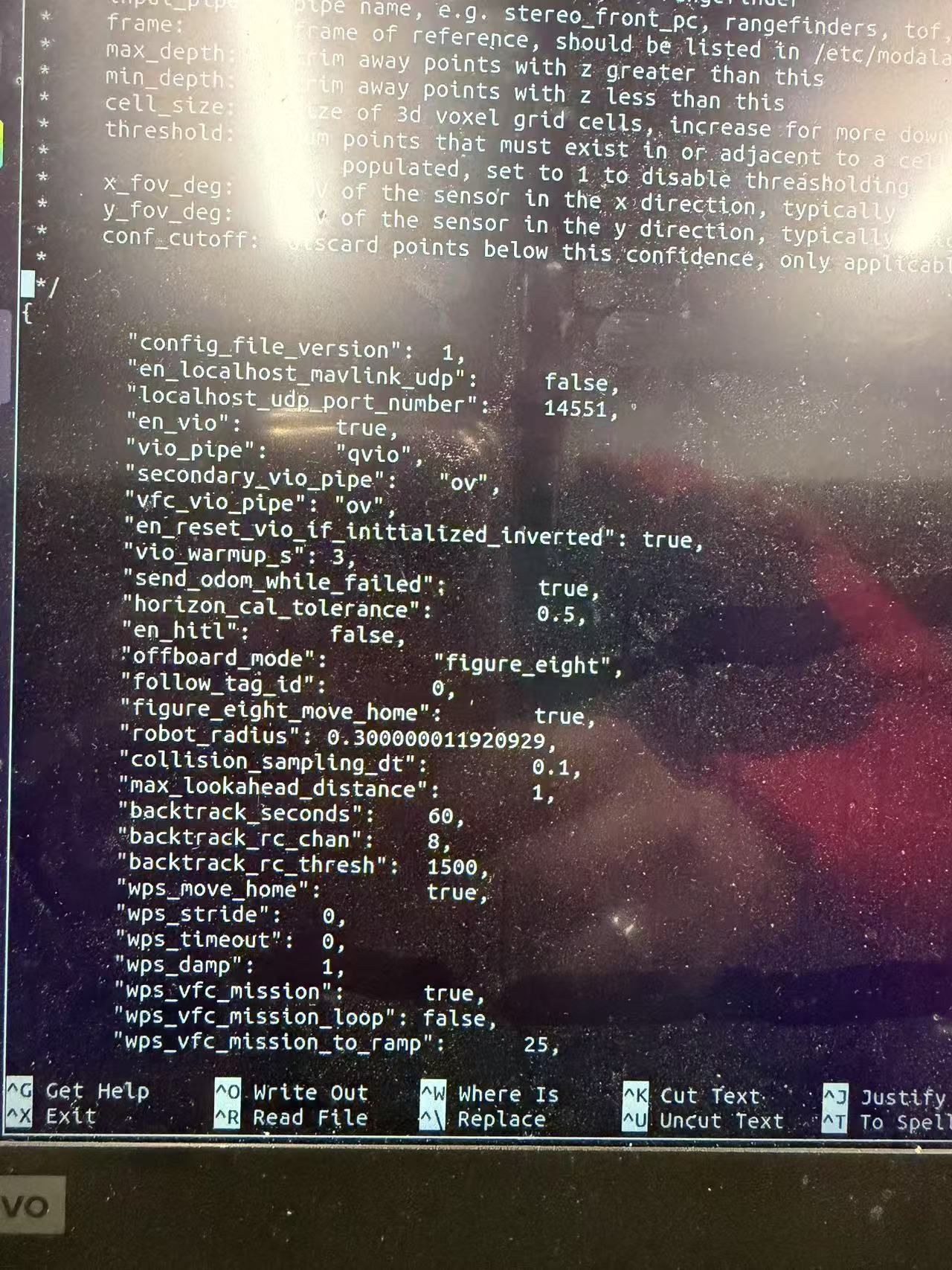

        @Muqing-Cao In the voxl-vision-hub configuration file /etc/modalai/voxl-vision-hub.conf how is the parameter en_vio set?
        Muqing CaoM 1 Reply Last reply Reply Quote 0
        • Muqing CaoM
          Muqing Cao @Eric Katzfey
          @Eric-Katzfey
          en_vio is set to true

                • Zachary Lowell 0Z
                  Zachary Lowell 0 ModalAI Team
                  @Muqing-Cao you have voxl-open-vins-server and voxl-qvio-server running at the same time. Only one can be run - modalAI defaulted to open-vins as the main method for positioning - if you have both running, you are bound to run into conflicting errors.
                  • Muqing CaoM
                    Muqing Cao @Zachary Lowell 0
                    @Zachary-Lowell-0 after turning off open-vins and rebooting it works. thanks!
