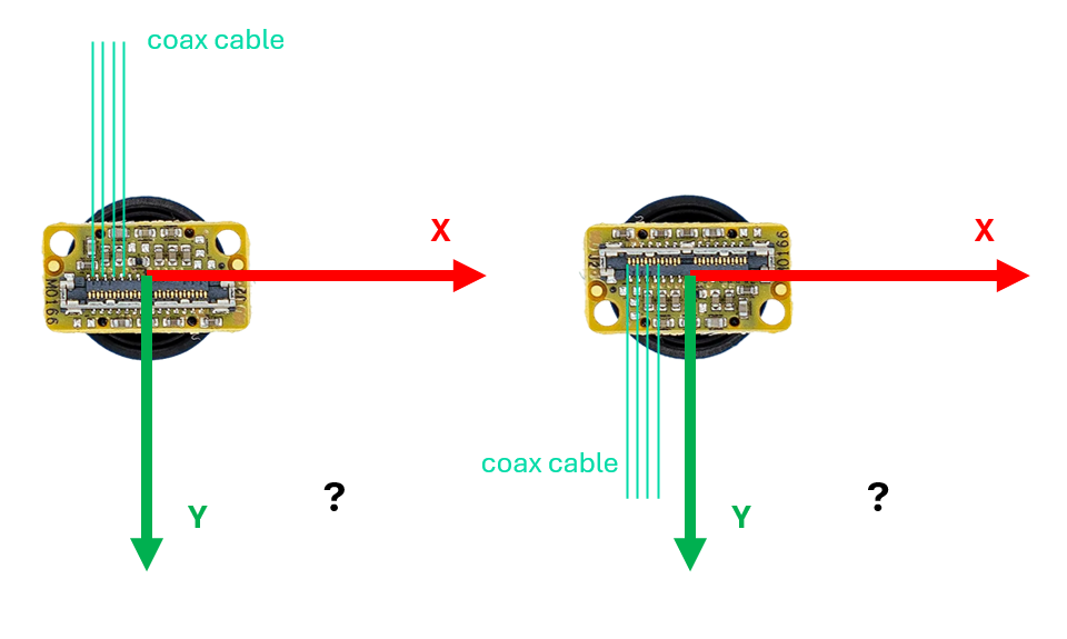

      I have a quick question regarding the coordinate frame orientation of the AR0144 tracking camera. As far as I understand it, the camera coordinate system is defined such that the z-axis points out of the lens, the x-axis to the right and the y-axis downward when looking through the camera.
      What I am currently unsure about is the originally intended orientation of the tracking camera frame itself. I created a small sketch showing the two possible orientations I could think of. Which one is the correct one, the left or the right figure?

        The other side of the M0166 PCB has a picture of a tiny figure which shows the nominal "up" orientation. You will see the little guy in the image below (coax cables are going up):
        So if you flip the camera around to point away from you, then reference frame will be (right-handed):
        • X : right
        • Y : down
        • Z : out of the camera lens
        So your first diagram (on the left) is correct.
