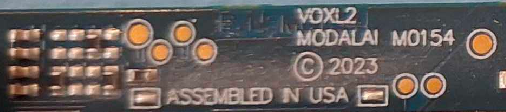

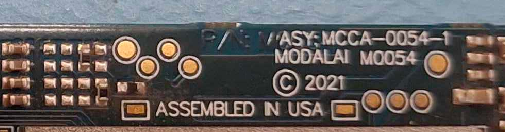

          mark
          @Alex-Kushleyev, By the way, as i was comparing this VOXL2 to one which does not have this same issue, i noticed that the board seemed to be an older one, could this have anything to do with it?
          VOXL with the issue:
          69799746-8bb1-463f-ba1a-b99c16e24a59-Screenshot from 2025-11-27 09-03-38.png
          VOXL which behaves as expected:
          a27a1ef5-0ddb-450f-8ba4-ce97641b6cf1-Screenshot from 2025-11-27 09-03-24.png

            @mark, thank you for the details. It should not matter whether M0054 or M0154 voxl is used.
            Can you please do a test and disable both hires cameras and see if the issue is still reproducible? If the issue is gone, then enable one hires camera and test again.
            Also, does setting cpu to perf mode help with this? (Voxl-set-cpu-mode perf)
            I have never seen this happen with out stable camera configs, such as C28, so this is very odd!
            M 1 Reply Last reply

              mark
              Hi @Alex-Kushleyev i ran the tests, and it seems that the issue only occurs when both the hires cameras are enabled. when one or the other is disabled, this problem does not occur. Also running the CPU in performance does make it run normally longer, but the stream still switches.
              Looking again at the images of the VOXLs i notice that a resistor in the bottom left of the frame is not placed in the m0054 version that is placed in the m0154 version. I placed a 100k resistance there (same as on the other resistances.) and that seemed to work, at least for this VOXL. Could it be that this is related to the I2C address of the camera or the VOXL?
              • M mark
                @mark ,
                Thank you for running the tests!
                Regarding installing resistors without knowing what the function is - not recommended 🙂 . I will look into what this resistor is. Are you saying that after installing this resistor, the issue is not reproducible?

                        M Offline
                        M Offline
                        mark
                        This is the output i get from dmesg -w, the i put 2 enters at the place where the camera stream duplicates.
                        I do see the same error mesages as you sent, but only with id 6 instead of 3. I am quite certain i am using the 8-bit drives, since the files in /usr/lib/camera/ do not specify 10_bit, or 12_bit, and the output format of the sensor is RAW8
                        [  420.109884] qcom,camera ac50000.qcom,cci:qcom,cam-sensor2: Linked as a consumer to regulator.60
                        [  420.109907] qcom,camera ac50000.qcom,cci:qcom,cam-sensor2: Linked as a consumer to regulator.56
                        [  420.109942] qcom,camera ac50000.qcom,cci:qcom,cam-sensor2: Linked as a consumer to regulator.79
                        [  420.123279] CAM_INFO: CAM-SENSOR: cam_sensor_driver_cmd: 997 CAM_ACQUIRE_DEV Success, sensor_id:0x577,sensor_slave_addr:0x34

                          @mark , thank you for confirming. The error is the same that i am observing. It should not matter whether it is 8 or 12 bit image (in your case it is 8 bit).
                          In my case the issue happens on M0154 board. I don't think M0054 vs M0154 makes any difference.
                          Just to clarify what is actually happening..
                          The issue starts with some CRC errors (interference between multiple cameras, it seems). In my case, the rate of CRC errors depends on the position of the ucoax cables. (you can also watch these CRC errors and move the coax cables for the second tracking camera).
                          If the error occurs at a critical point (such as beginning of the frame), the camera pipeline reports a critical problem and should produce an error in the camera pipeline.
                          The correct behavior should be that the problematic camera stops streaming and in latest SDK, it will actually be restarted and stream will recover. However, the camera is never stopped, instead it reports a duplicate image from the other tracking camera.
                          We are investigating the root cause, as it is somewhere low level in the camera stack (not in voxl-camera-server).
