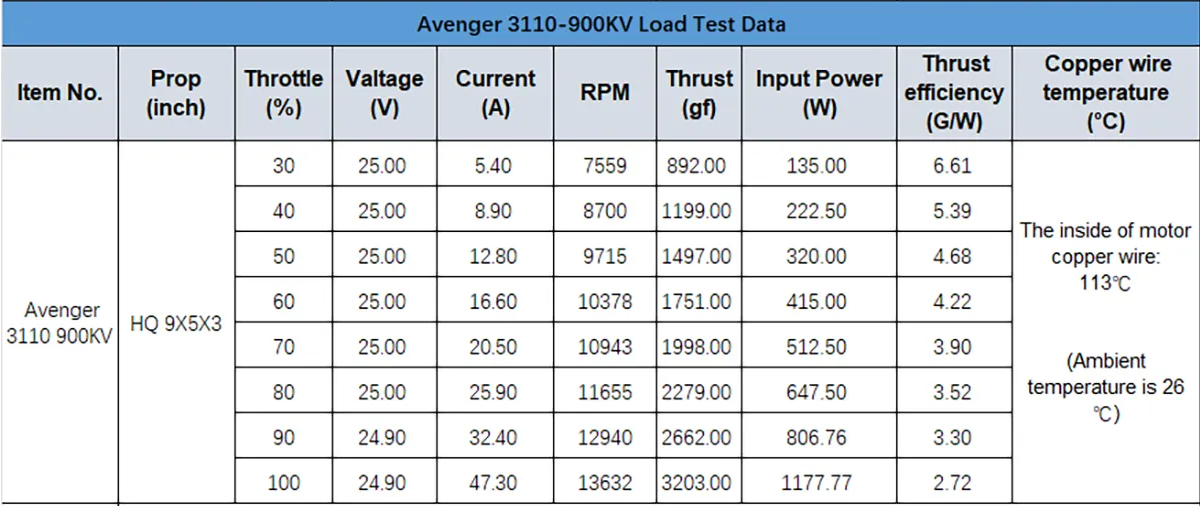

      we are trying to calibrate a m0138 ESC using a VOXL2 mini. We have upgraded the ESC firmware using the provided scripts. We were able to run the script on m0 successfully and motors spun all the way to the max rpm set in the config file (see attached log). However, the calibration failed to spin the motors all the way up to the max pwm value for second motor (it keeps resetting to 0 , ramps up again and never exceeds about %15-20). attached is output log of the failed test as well.
      we also tested a version which we updated the number of poles and kv to match our actuators and we seemed to experience similar issue.
      link to calibration logs
      Below are some of printouts of the python scripts and also specifications for the actuator we are using:
