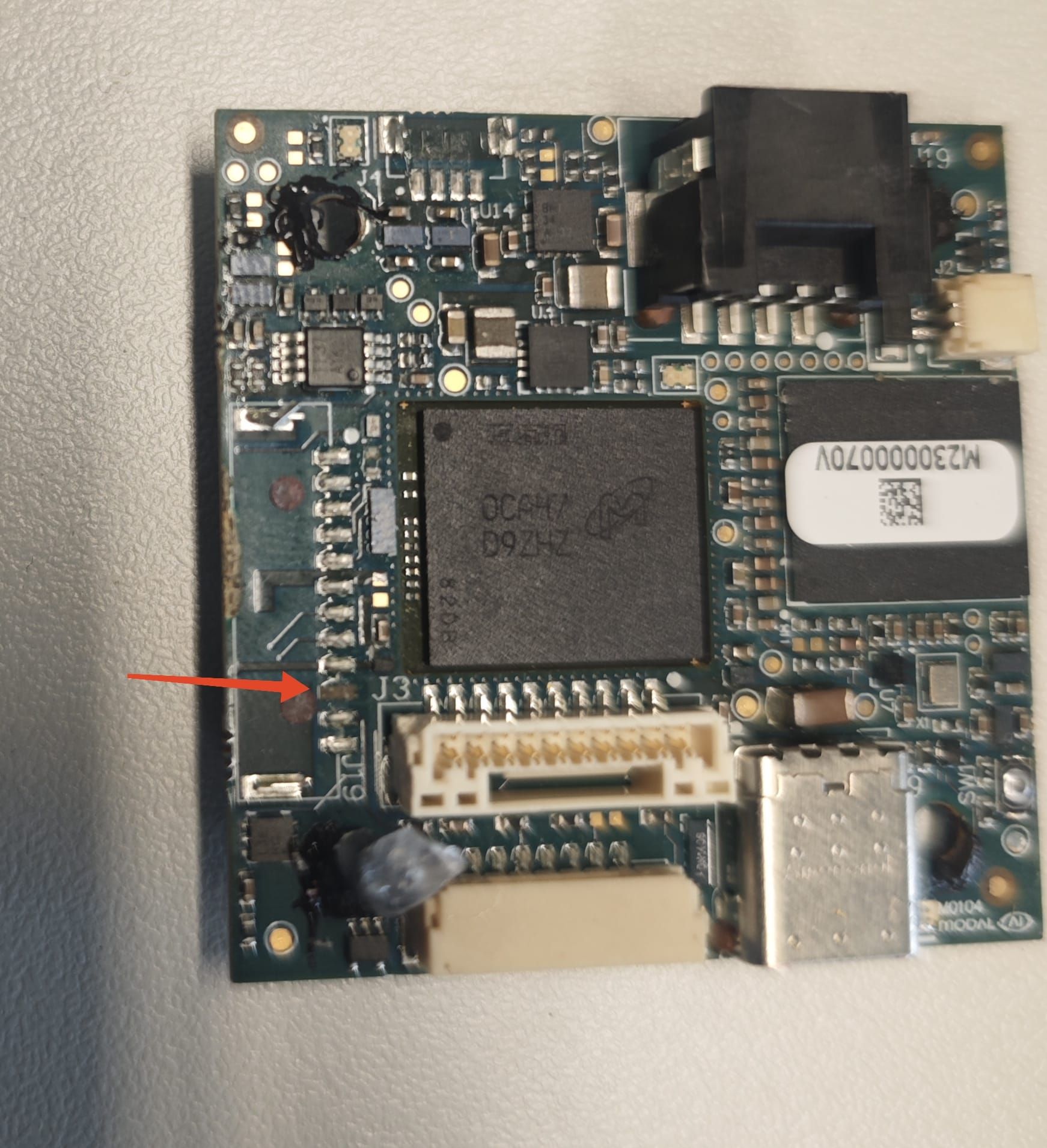

    Hello everyone,
    I had a crash with my VOXL2 Mini, which caused the J19 connector to come loose. A solder joint was also torn off, so the connector cannot simply be soldered back on. Apart from that, the VOXL2 Mini still works perfectly.
    The loose connection is this pin:
    RC_UART_TX (Output) slpi_proc, SSC_QUP7, GPIO_178, 3.3V signal levels
    I really need it because it controls the gimbal. Can I solder a strand of wire to any other point on the board to tap the signal?
    Best regards,
    Tom

      Hi @TomP
      I'll look right now, but can you please also send me a zoom in clearer picture of that area?
      I think I see other damaged parts, so I want to double check and advise what else could be impacted.

        Hi @TomP
        Looking pretty grim...
        That specific signal is all buried at least 3-7 layers deep directly from that pad and it hits other BGA devices right in the pad.... no exposed traces, no exposed pins at all...
        You'll have to find a different UART port or some other plan B.... sorry.
