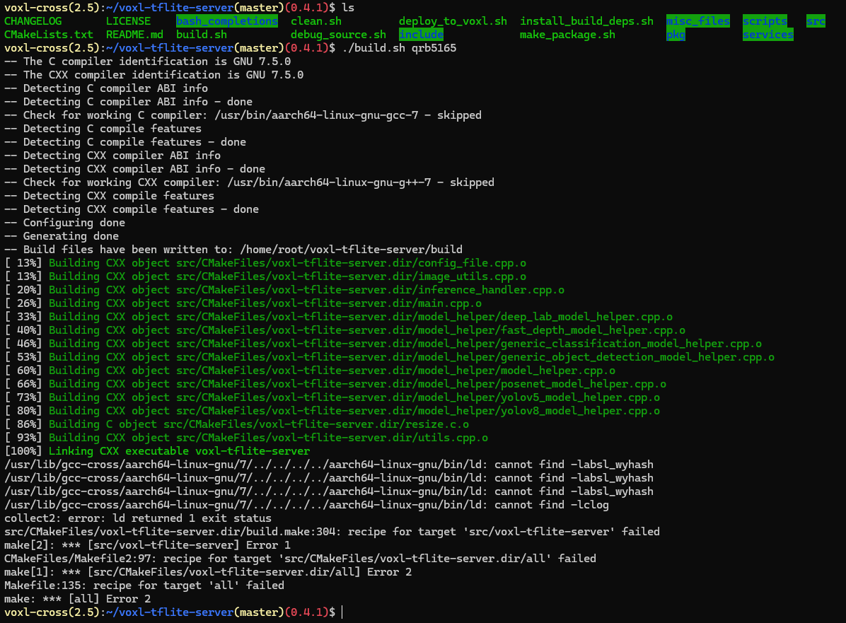

      I was able to compile successfully before, but recently the linker has stopped finding the library files "absl_wyhash" and "clog".
      The compilation output is shown below.

        @Wondosen How are you running ./install_build_deps.sh?
        WondosenW 2 Replies Last reply Reply Quote 0

          @tom yes I did
          ./install_build_deps.sh qrb5165 dev
          • WondosenW
            Wondosen @tom
            @tom for running, ./build.sh qrb5165
            • tomT
              tom admin @Wondosen
              @Wondosen You're building voxl-tflite-server which is part of SDK 1.4.4, while calling install_build_deps.sh qrb5165 dev will pull the dependencies for a much newer version of voxl-tflite-server than you're using.
              Try running ./install_build_deps.sh qrb5165 sdk-1.4

                  @tom Thank you so much. It is working now with your suggestion. I think the README file of voxl-tflite-server need to be updated.
