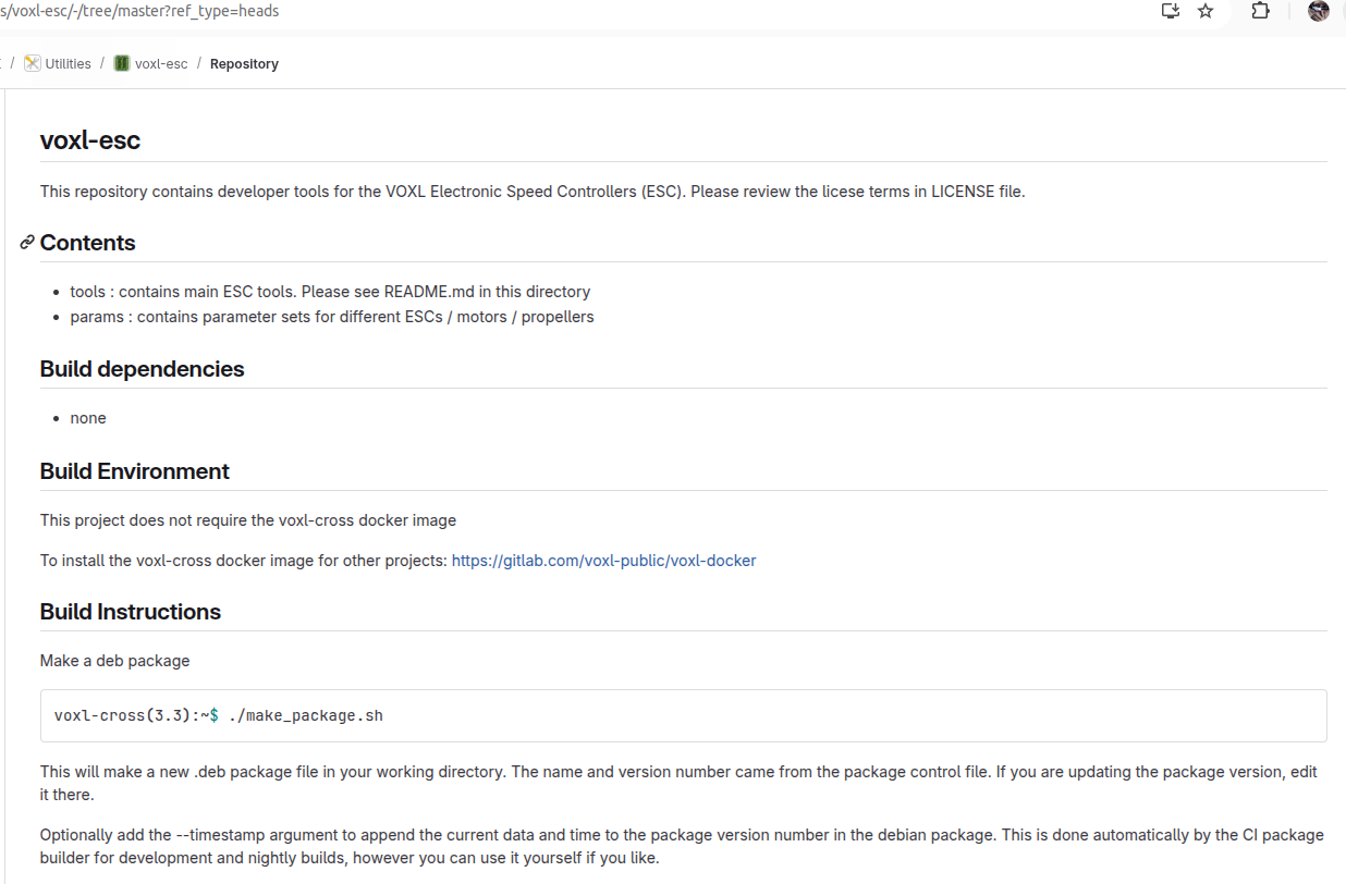

    The make_package.sh file in https://gitlab.com/voxl-public/voxl-sdk/utilities/voxl-esc/-/tree/master?ref_type=heads claims that build.sh needs to be run first but this script doesnt appear to be included? Can someone point me to where that would be? I am new to building debian packages so I may just be missing something simple.

      @JackHammer , the instruction do not specify that build.sh is needed for this project.

        @Alex-Kushleyev In the first few lines of the make_package.sh, it states that you must run build.sh first to build the binaries.

          @JackHammer , I see. thanks for clarifying. This is a copy / paste error. In this project, you don't need to build anything.
