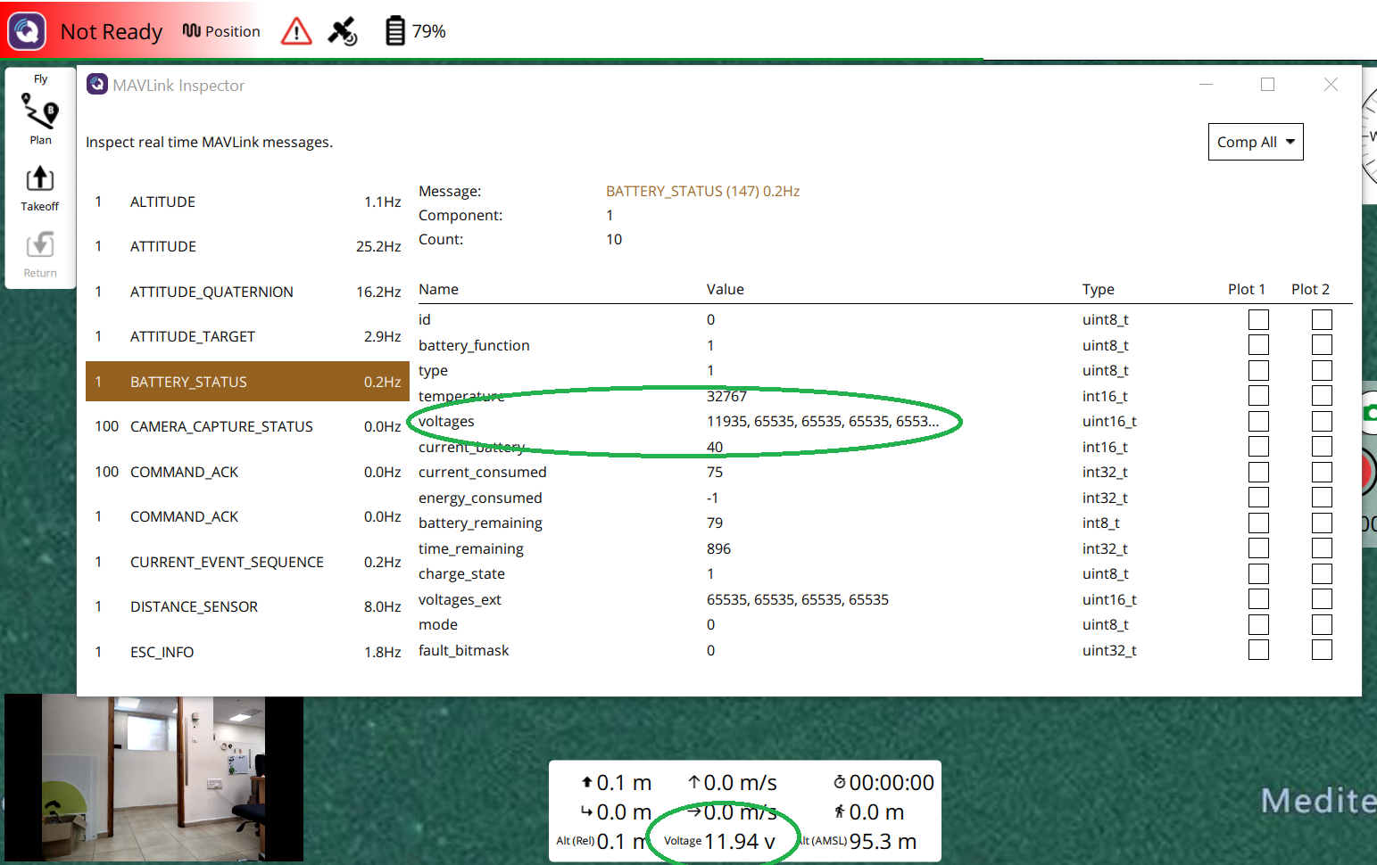

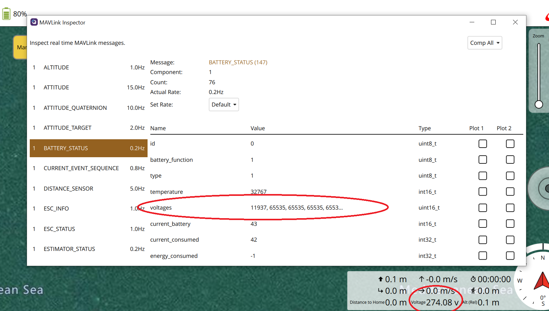

                This is how it looks with QGC v5.0.6
                And this is the same system but with QGC v4.4.4
                george kollamkulamG 1 Reply Last reply Reply Quote 0

                    According to this the Modalai PX4 uses the voltages_ext field of the BATTERY_STATUS message incorrectly. That fields does not use UINT16_MAX (65535) to indicate no value. It should use 0, otherwise they are added to the battery voltage 😕
