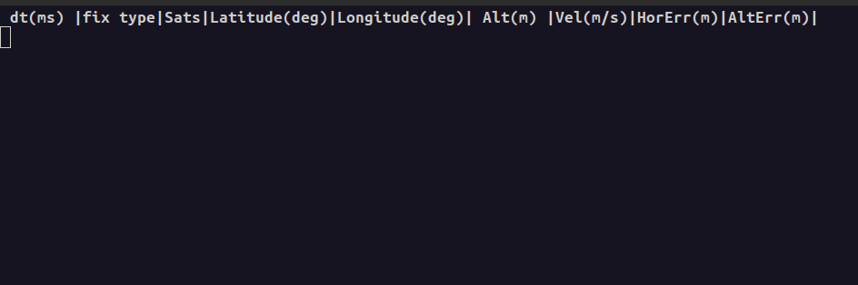

            @Eric-Katzfey We just got the m10s gps that you linked and are still having some trouble. Again when running px4 the gps works as expected, but running ardupilot seems to cause some issues. Getting the same behavior as the m9n, where running voxl-inspect-gps has no output:
            Any ideas on what to try next?

              @cguzikowski I just downloaded the latest ArduPilot and loaded it on to my VOXL 2 with m10 GPS unit attached. It comes up and I can see that the GPS_RAW_INT message is being received at QGroundControl. The voxl-inspect-gps application does not print anything though so I'm not sure what's going on with that since it supposedly uses the Mavlink GPS_RAW_INT message to print the values. That will need to be looked into so don't rely on it for anything right now. If you look at QGroundControl Mavlink inspector do you not see the GPS_RAW_INT message coming in?
