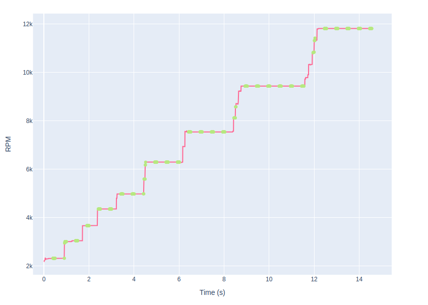

      We calibrate from 10% - 95% per the instructions, but no matter the ESC/motor, the calibration process maxes out at around 60 - 70% power (11k - 13k RPM).
      Here's a link to the calibration results on ESC 2 when using the Starling 2 MAX cal params as a starting point (with the mentioned changes to match the motors and battery):
      cal results (Starling 2 MAX)
      And here's a link to the calibration results on ESC 2 when using the low-KV cal params as a starting point (with the mentioned changes to match the motors and battery):
      cal results (low KV)
      You'll need to download the HMTL files to view them locally.
      As stated earlier, it looks like the power only goes up to 60 - 70%. It also looks like the voltage command inputs are "overlapping" leading to the same resulting RPM output and there's not as many distinct RPM values as seen in the reference in the documentation. We notice this on all 4 ESCs. I shared the calibration results for ESC 2 since it provides the current output as well.
      Does anyone know what might be happening here and what needs to be done differently? Let me know if the calibration parameter files we used initially are needed. Thanks!.

        From the following plot, i see an issue that looks like the clock is being stretched and the intervals between the calibration steps are getting longer and longer. I will double check this to make sure it still runs fine on my test setups.
        V 1 Reply Last reply 3 Jun 2025, 15:43 Reply Quote 0

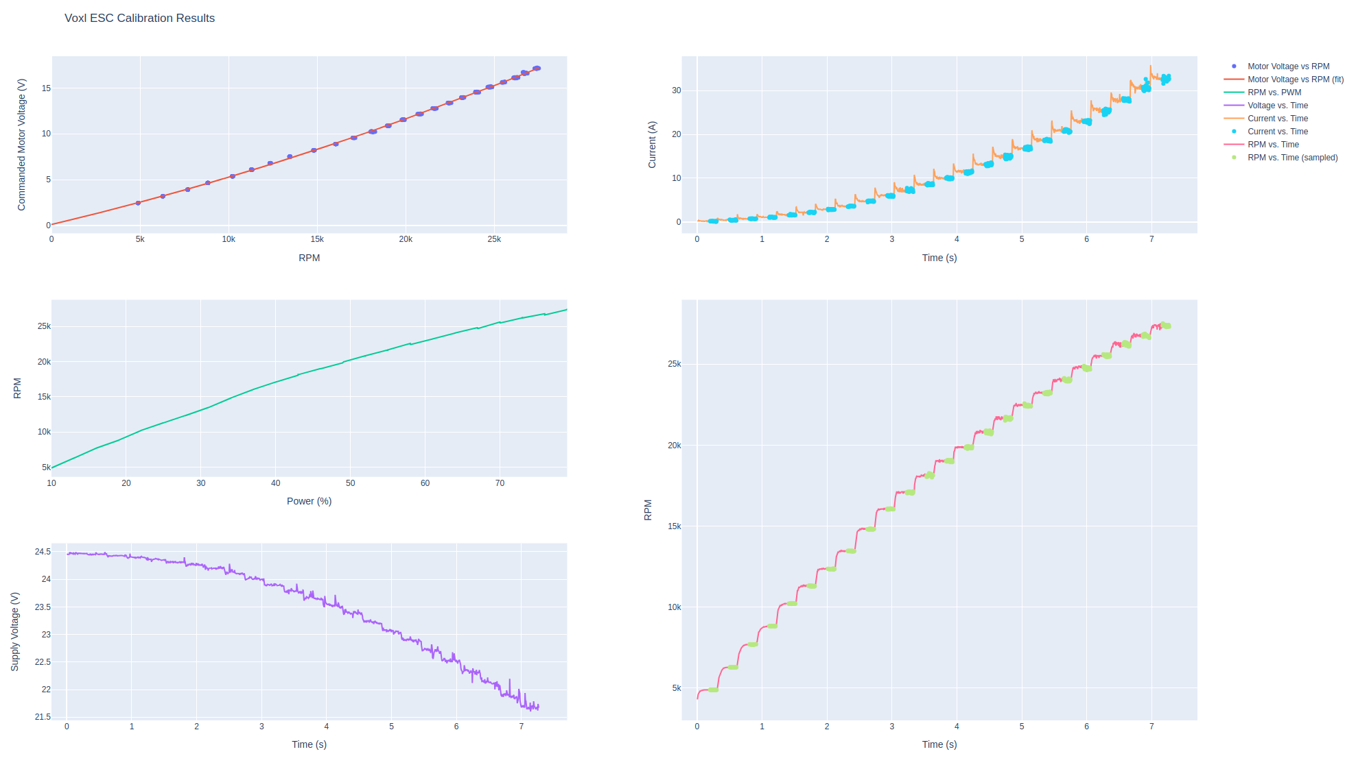

                @Alex-Kushleyev We were able to change our setup to calibrate with a Linux PC directly connected to the ESC. The calibration results look much better.
                Here's the calibration results for ESC 2 with the current output as well:
                https://drive.google.com/file/d/1jXxyAO6eBfVzh6qAuWCJVFvE2Dsa1sZX/view?usp=drive_link

                  @victochen , your latest calibration curve looks good! 62A steady state at full power (single motor), not to mess with! 🙂
                  If you are going to push the ESC hard, you should watch the ESC temps (reported in PX4 esc_status topic). Depending on your average current draw, you may need significant cooling of the ESC (the ESC may be thermally limited, not limited by current capacity). technically speaking if your ESC runs hotter than 120C, that is a red flag (the MCUs on ESC are technically rated for 125C, and will likely run fine at higher temps, but that is just not a good practice to run them this hot). I typically recommend keeping the ESC below 90C in steady-state for good practice. Personally, my preferred temps are much lower (60-70C max), but that is way below the rated specs and obviously depends on the application.
                  Also, did you calibration using the suggestions for the low-kv motors, or not? I would not consider 1000kV low, necessarily. Increasing the commutation advance per those instructions can reduce the efficiency (and heat up the motor a bit more).
                  Also, i am not sure if you have changed the RPM controller gains at all - i would suggest starting soft first, maybe even set kp and ki to 0. Setting the RPM controller feedback gains too high could create issues if you have IMU noise from vibration, so it's good to start off with less aggressive RPM control and then increase the gains as you gain more confidence (which will allow to do better attitude control of the drone with updated attitude controller gains). Starling 2 MAX ESC gains were pretty soft, so you could start with that as well.
                  When you update the PX4 params (assuming you are using PX4), make sure that you update the ESC RPM limits for the voxl_esc px4 driver.
                  Regarding running the script on VOXL2, i did not yet get a chance to try it, but it should work the same.. it was previously tested. I will test it out and will report back..

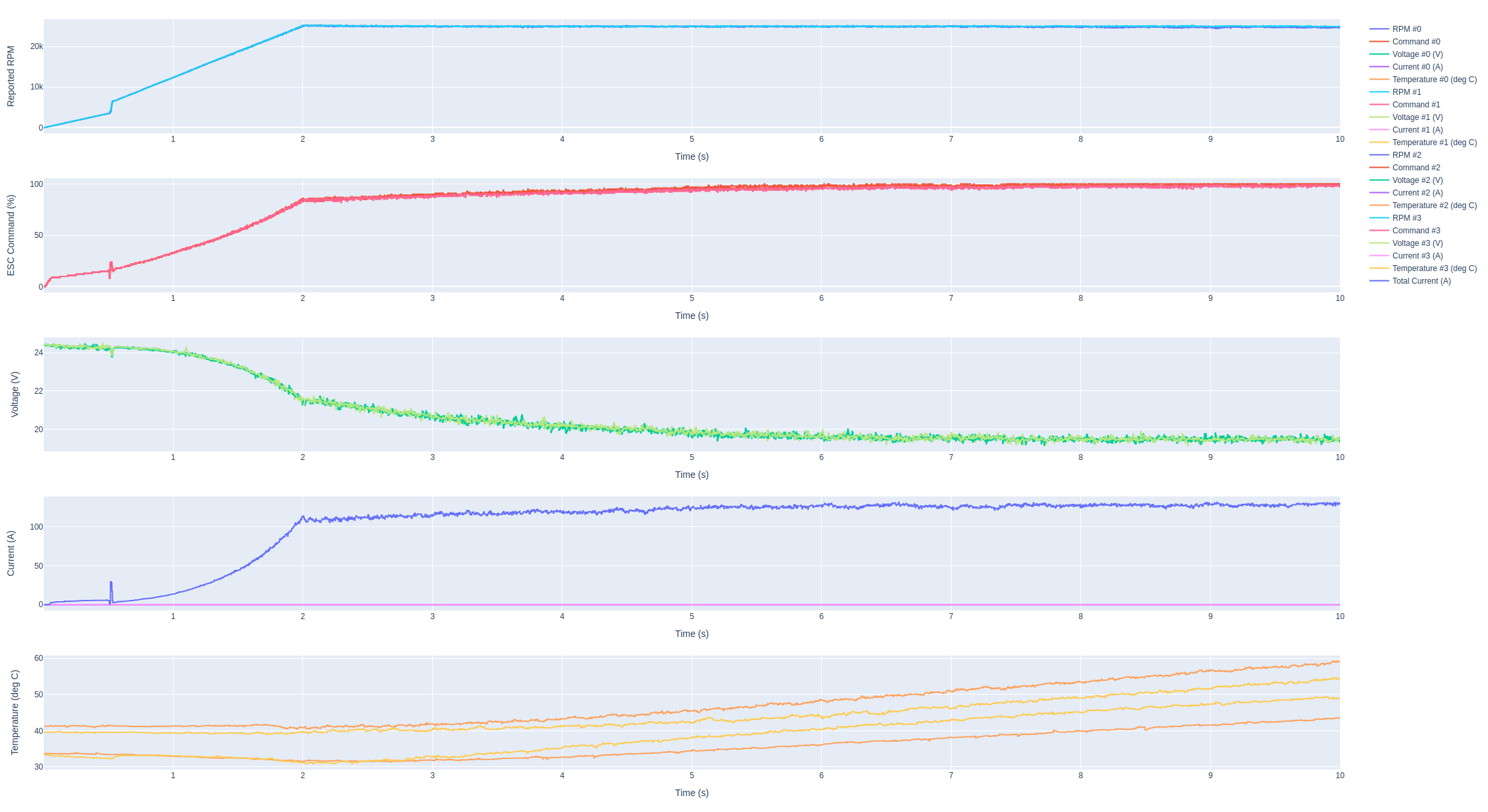

                      The 62A current draw (1.3KW!) for one motor is probably OK for motor to sustain for a short period of time, but my guess is that the motor itself would overheat pretty quickly. Unfortunately I could not find any test data about this particular motor, which is unusual.
                      If we knew the propeller's thrust vs rpm, you could estimate your hover power draw right from this calibration plot (knowing the weight of your drone).
                      In any case, after you do a short first flight, you should analyse the log data, if you are using PX4, you can use flight-review to view the PX4 logs. Additionally, we maintain our own version of the flight review analysis tool, which includes some VOXL2 specific updates including all the ESC data (commanded and actual rpms, etc). You can find the fork of flight-review and instructions how to use it locally on your machine here : https://github.com/modalai/px4-flight-review
                      The total current (as the FPV ESC does not measure the individual motor current), will be reported in the battery_status message in the PX4 log and is viewable using flight-review (there is a section for battery voltage / current).
                      Also just to give you an idea of M0138 performance (and you can reproduce these tests), here is a test of 4 2207 motors with 5x4x3 props, 6S battery, spinning at 25K RPM (in closed loop RPM control mode) with full airflow cooling of the ESC. You can see the the ESC temp(s) go up pretty quickly, but this particular test was pretty short, i think i did not want to cook the motors, since ESC temps were still fine. The ESC is pulling around 125-130A total in this test and the performance is stable. You will notice two temperature bands in the 4 temperature measurements because these temps are reported from different locations (the higher temps are from the MCU's built-in temp sensors, which run a bit hotter due to MCU power consumption) and the lower two temperature measurements are from dedicated temperature sensors located next to the Mosfets (top and bottom of board).
                      voxl-esc tools provide the tools to perform this analysis on the bench pretty easily and find out how your propulsion system is stressed under different conditions. You can also get similar logs from flights / px4-logs for real use case analysis.
                      Finally, our ESC driver in px4 supports warning and critical temperature limits, which will send out warnings to QGC if those limits are reached. The limits are disabled by default, but you can enable them with params: https://github.com/modalai/px4-firmware/blob/voxl-dev/src/drivers/actuators/voxl_esc/voxl_esc_params.c#L238 . However, i am not 100% sure of the behavior of PX4 if ESC reports critical temps, it could enter some failsafe mode, or something like that - you should double check that, if you enable these warnings.

                        @victochen , just to close the loop on the original issue.. the delay in the calibration procedure was caused by UART data or processing of the ESC feedback backing up. The fix is to just slow down the command rate, seen in this commit : https://gitlab.com/voxl-public/voxl-sdk/utilities/voxl-esc/-/commit/b512f9e3d5e695868775de3d40eedb2ad15cf6d9 . Additionally, using command line argument --cmd-rate 100 when you run the calibration script on VOXL2 will fix the issue.
