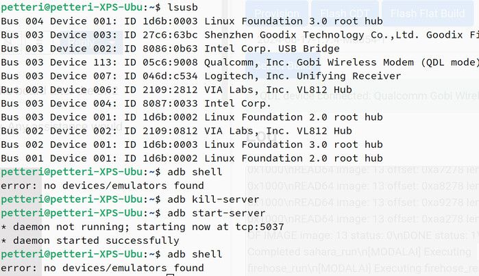

      I lost my device after getting it to work for a while, and thought that the issue was that my device got bricked.
      I was following your unbricking tutorial and ran into following error (not encountered in the previous unbricking threads 1, 2, 3, 4, 5, 6)
      I think I got the Provisioning and Flash CDT done with some warnings (also weirdly the green text says that things succeeded even if things failed)
      I have the QRB5165M version and I was using the Latest: VOXL 2 QDL Image 14.1a_1.7.8. I am usinf Ubuntu 22.04 and like said, the Starling 2 was working for a while and established a connection there, but then I lost it.
      Any ideas why the flashing fails?

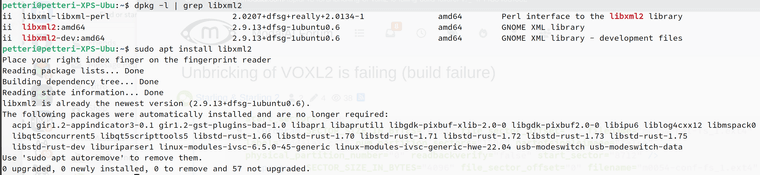

            It's possible that there's an issue with the XML parser where it tried to open or failed to find the rawprogram_unsparse0.xml file.
            Can you ensure libxml2 is installed by running:
            dpkg -l | grep libxml2
            If not present, run the following to install:
            sudo apt install libxml2
            P 1 Reply Last reply Reply Quote 0
            • P
              pettertei @Nathan Raras
              @Nathan-Raras It seems that the libxml2 is up-to-date
