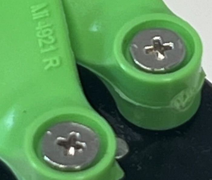

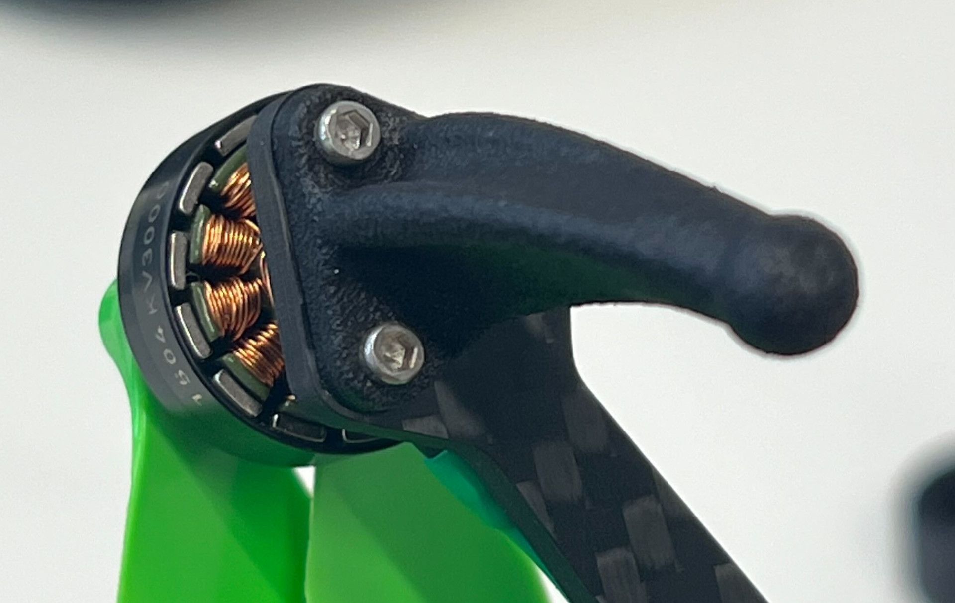

    • Starling 2 Phillips/hex screw sizes
      What is the actual size of these screws in the Starling 2 propellers, could not find their sizes from the datasheet, or not very good list of the mechanical parts:
