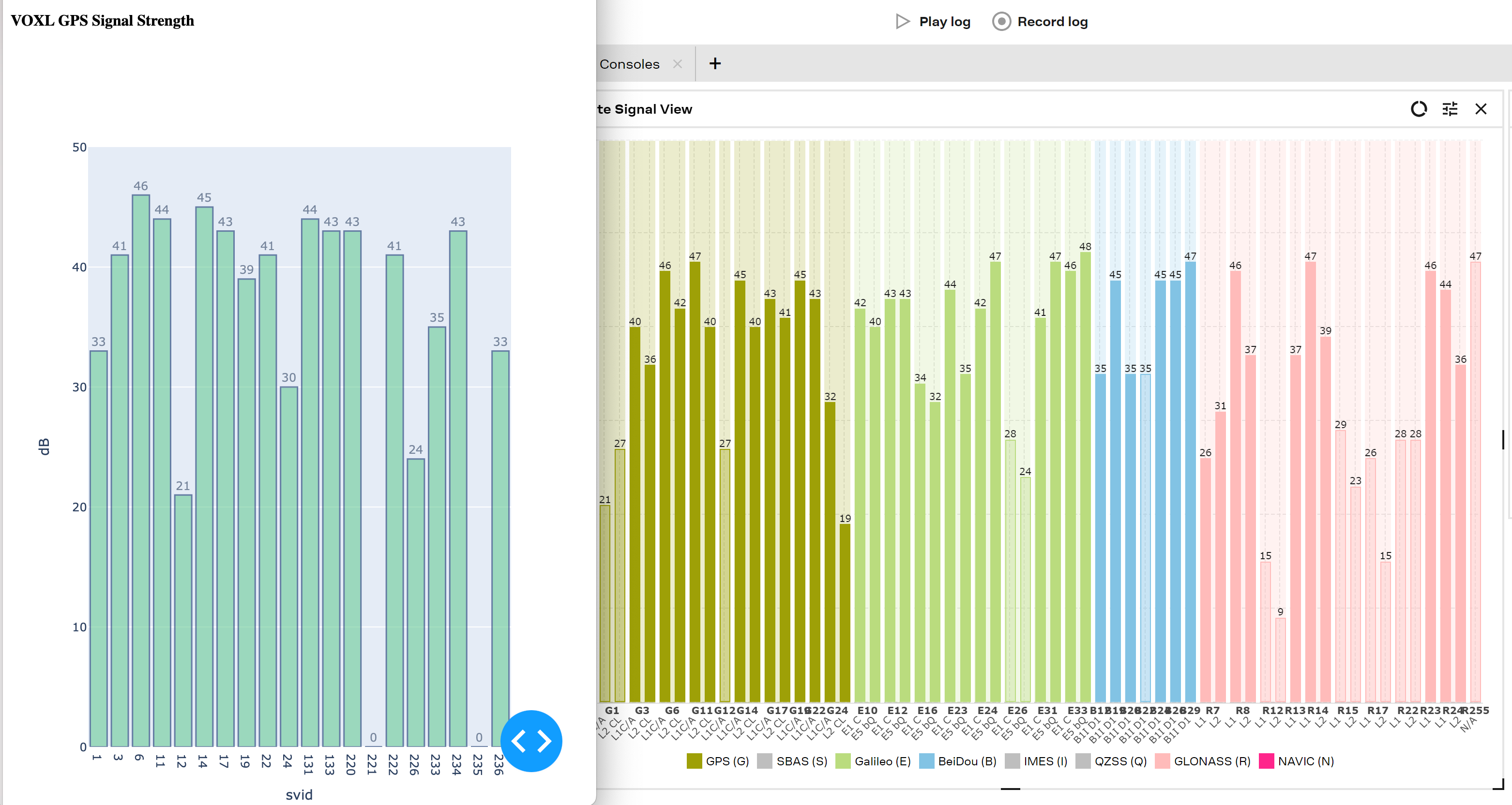

                    • in order to compare know what SNR to expect, i hooked up a Ublox EVK to my laptop so i can use Ucenter2 to plot the signal strengths while the EVK is placed about 2ft from the drone.
                    • we now have a simple python script that can grab the satellite info from px4 (satellite info needs to be enabled via px4 param, see script), so that the bar graph of voxl2 gps SNRs can be running live on a laptop that is also running ucenter.
                    Results
                    • using the mast with the FR4 (with copper) shield achieves SNRs that are very close to the SNRs from EVK
                    • Running Commando 8 transmitter in close proximity (less than 5ft, the closer the worse, especially TX antenna above the gps antenna) to the gps receiver can degrade SNR up to 10dB !! This can happen if you are standing right next to the drone before take off. It looks like the RC TX is saturating the GNSS receiver, even though the RC is in the 900mhz band.
                    • the shield on top of the mast (FR4+copper, but i also tried thin carbon fiber) helps increase SNR by around 3-6dB. Also, it may be good to add some copper tape (with non-conductive adhesive) to cover up the back of the GNSS receiver in order to prevent noise being injected into the short trace connecting the antenna and the GNSS receiver. I will try that, need to buy some copper tape. Using copper tape can reduce the mass of the top of the mast (the FR4 itself does nothing for shielding, since it's not conductive)
                    • I found better results when the 6-conductor cable is tightly wrapped around the mast as opposed to hanging loose , I may consider trying a shielded cable, perhaps there is some noise that can be picked up by the conductors as well (TBD)
                    • I would like to flight test this configuration (TBD, maybe Weds or Thurs). It is important to make sure the mast is stable and does not vibrate.
                    • the Lepton cable did not seem to matter, whether it was plugged in or not, i did not see any change when using the mast and unplugging the lepton cable in real-time.
                    • wifi dongle did not affect the gps signal, especially since it's normally mounted underneath the drone
                    Conclusion:
                    • based on these numbers from a non-moving test, the satellite signal strength looked very good (can't do much better than that) and I got a DGPS lock (i guess SBAS)
                    Other Thoughts
                    • using a GNSS receiver with a larger antenna, can help a bit more, but it will also increase the weight on top of the mast
                    You could try to replicate this type of testing and use a second (reference) gps receiver so you can compare the SNR to a (close to) ideal gps receiver without any interference. The reason for this is that the satellite SNR vary significantly as their position changes (over time), so a reference will allow you to always see what the SNR for each satellite (roughly) should be.
                    Images and plots:
                    SNR plot. Left: Starling 2 Max (plot using attached script), Right: Ublox EVK (using Ucenter2)

                        Alex Kushleyev ModalAI Team @ROBERT JUDD
                        @ROBERT-JUDD , the behavior of the RC receiver on the drone as is as follows:
                        • when the Transmitter (Commando 8 ) is off, the receiver does not send (broadcast) anything
                        • when the Transmitter is on, the receiver sends back telemetry packets (even if there are no telemetry updates from the PX4 side).
                        However, the GPS signal degradation seems to be related with proximity of the RC TX when the TX is on. The RC RX antenna is already located at the bottom of the drone and it should be OK, but there could also be some sort of interference, so possibly moving the RC RX antenna to the landing gear could resolve that (if it's an issue, TBD).

                              I was finally able to do basic flight testing with the GPS mast. I was able to observe 23-26 satellites reported by PX4. In my initial test I was not logging the SNRs in px4 directly, but i will repeat the test again (with SNRs logged) and double check that SNRs were high throughout the flight. I did not see number of satellites drop between non-flying and flying modes.
                              I will continue testing more actively in the next few days. Meanwhile, If you want to get your Starling Max flying with better GPS, I would recommend that you try to replicate my results using the mods from images i posted above. The only changes i made from those images was just orient the slot in the FR4 board towards the front of the vehicle so that i could align the GPS module in the same orientation as the original one.
                              Please note that when you move the GPS unit (which also has the magnetometer), the mag needs to be re-calibrated. Additionally EKF2 GPS POS px4 param should be updated if the location of GPS module changes. It looks like these offsets are just defaults (0) on the Starling 2 Max, which may be OK, considering the offset is pretty small.
                              Please let me know if you need any additional details to help you get started with the mods.

                                          I tried many of the suggestions mentioned in this and related threads, but the only two approaches that consistently improved signal strength enough to achieve a fix were:
                                          • Increasing the distance between the GPS receiver and the rest of the electronics (some manufacturers recommend >10 cm).
                                          • Shielding the receiver.
                                          After experimenting with several designs, the setup shown below gave me ~30 dB signal strength while still allowing WiFi functionality, adequate cooling, and a compact profile that won’t break in case of a crash. For shielding, I used copper foil and Kapton tape (as an extra precaution).
                                          With this arrangement, I can now get a fix quickly and achieve about ~1.5 m HDOP.
                                          WhatsApp Image 2025-10-05 at 21.20.38.jpeg WhatsApp Image 2025-10-05 at 21.07.26 (1).jpeg WhatsApp Image 2025-10-05 at 21.07.26.jpeg
                                          I’m sharing the STL file here in case anyone else finds it useful. Hopefully it helps others experiencing the same issue!
