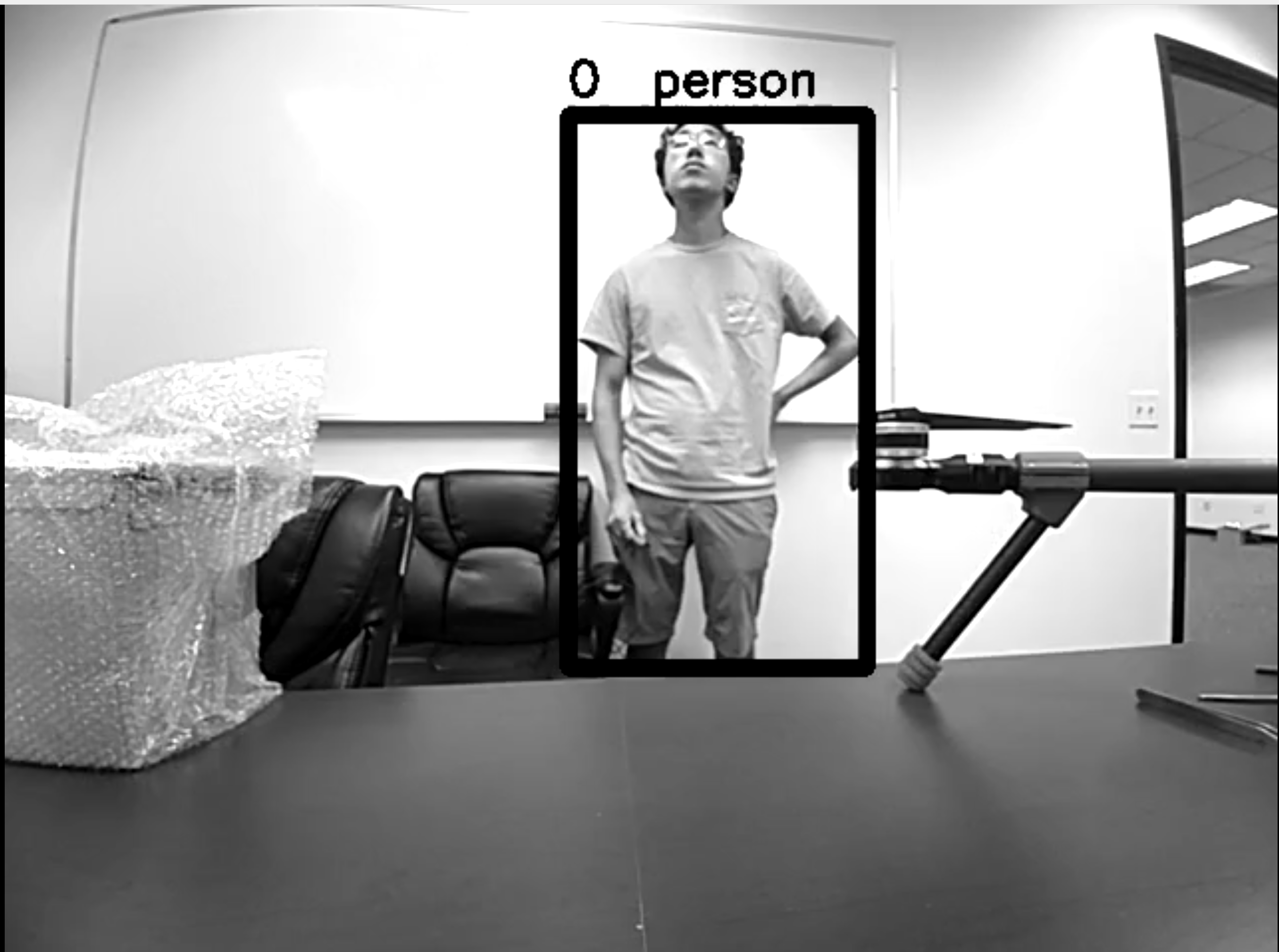

          After that, I had a colleague of mine stand in front of the hires camera and then I ran voxl-streamer -c tflite-overlay. When viewing the output through VLC, I only get the very first frame, almost as if only a photo was taken. There is no video feed except for the first frame which correctly detects my colleague as a person. Additionally, the photo is in black and white. Any idea what I could be doing wrong here or how to go about fixing this issue?
          Here is what the output from the stream looks like.
          ![0_1629494534628_Screenshot from 2021-08-20 13-40-43.png](Uploading 100%)
          • C
            colerose
            It looks like the photo didn't upload as it was too large in size. Here is a more compressed version of it voxl-tflite-output.png.

                Thanks Alex. I actually was able to get it to stop freezing by connecting to the rtsp port via opencv in python. However, it was still a low quality image in black and white.
                Additionally, I was able to successfully install and start voxl-portal and access the tf-lite server through the portal. However, the image is still low quality and in black and white. Any idea how to modify the image quality and add color to it on the tf-lite server? Thanks.

                    The output image quality is dependent on what you feed into the tflite-server as input, but we run the object detection on a downscaled 300x300 image.
                    To add color to the output, insert this section to line 326 of models.cpp:
                    // adding color
                    cv::Mat output_image;
                    cv::Mat yuv(img_height + img_height/2, img_width,
                                CV_8UC1, (uchar*)new_frame->image_pixels);
                    cv::cvtColor(yuv, output_image, CV_YUV2RGB_NV21);
                    Then, in the main object detection loop, change the input_img cv::Mat to our new output_img (lines 425 and 426) :
                    cv::rectangle(output_img, rect, cv::Scalar(0), 7);
                    cv::putText(output_img, labels[detected_classes[i]], pt, cv::FONT_HERSHEY_SIMPLEX,
                                0.8, cv::Scalar(0), 2);
                    Finally, change the metadata and data that we send via MPA to match our new rgb image, lines 429-435:
                    meta.format         = IMAGE_FORMAT_RGB;
                    meta.size_bytes     = (img_height * img_width * 3);
                    meta.stride         = (img_width * 3);
                    if (input_img.data != NULL){
                                    pipe_server_write_camera_frame(TFLITE_CH, meta, (char*)output_img.data);
