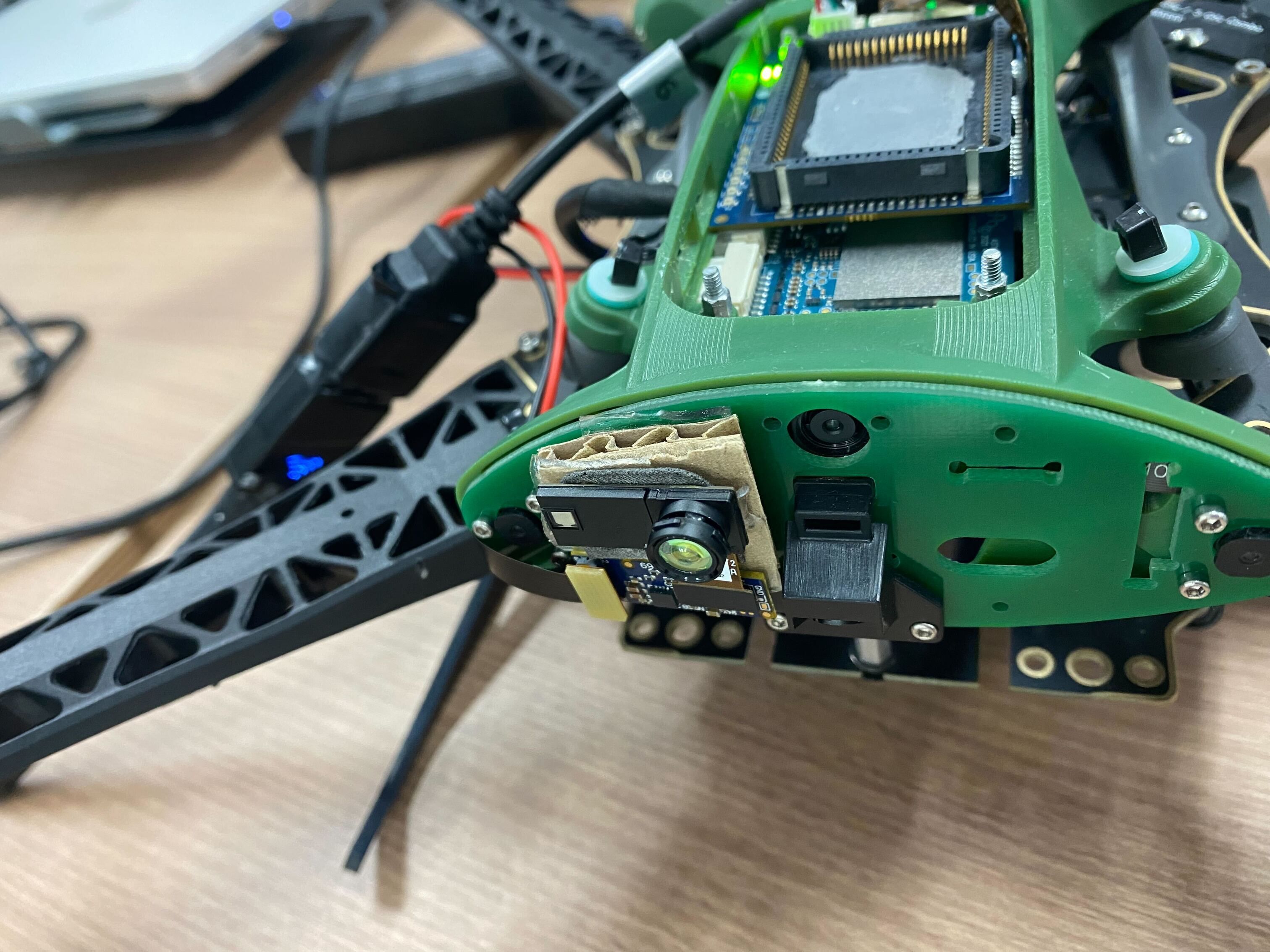

      I'm currently testing the tof v2 (IRS2975C) on Sentienl (voxl2 based) with the latest version of voxl-suite 1.2 installed. The voxl-camera-server keeps crashing, so I decided to debug it. The result is that the temperature of the tof v2 was too high, causing it to abort (you can check the captured image). When I touched the tof v2, it was indeed very hot.
      Is there a solution to this issue, or did I install it incorrectly?
      <tof installed Sentinel>
      <error message>
      (+++) When I attached a thermal pad on tof v2, voxl-camera-server worked over 1 hour.

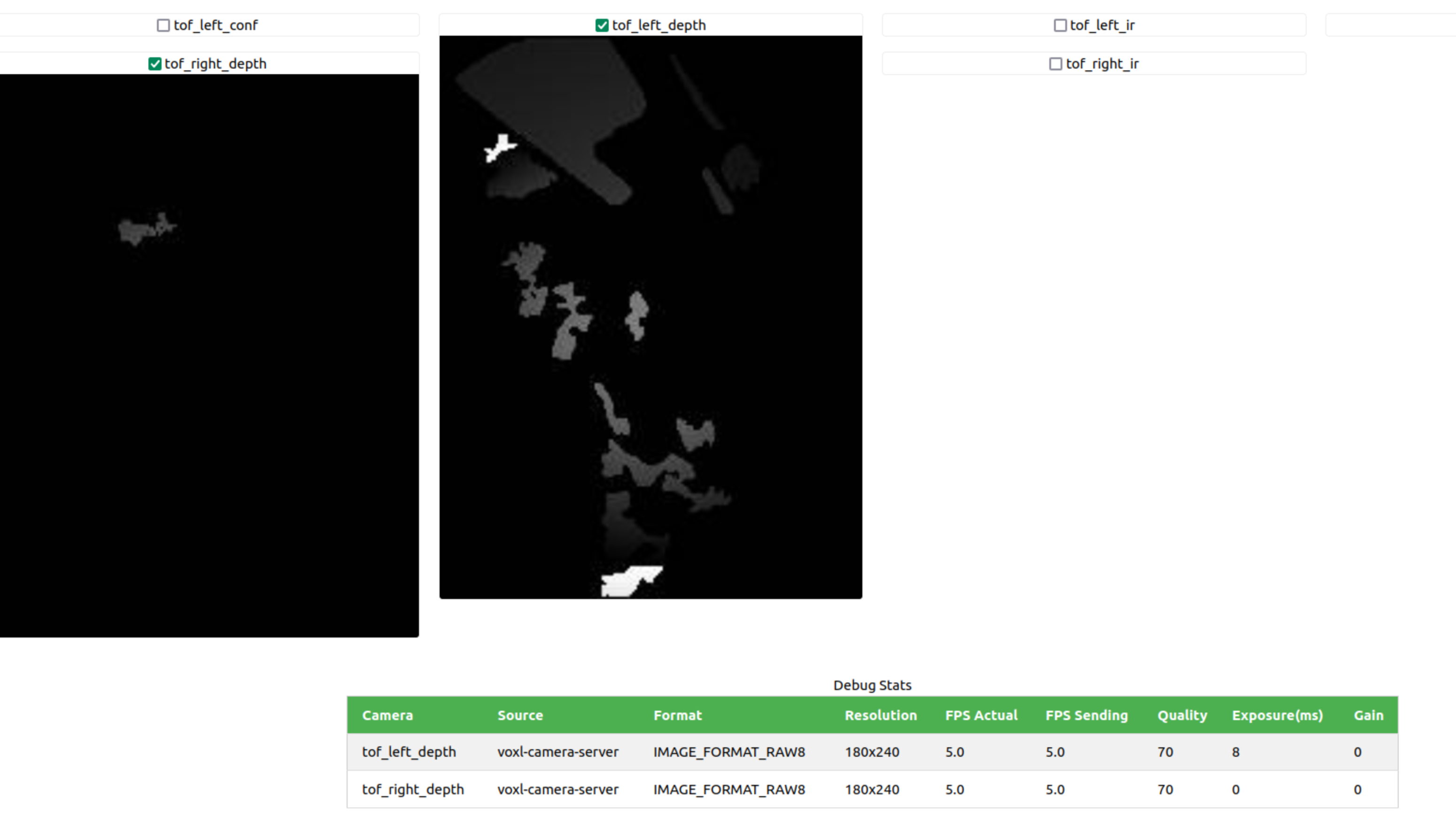

                FPS is set to 5.

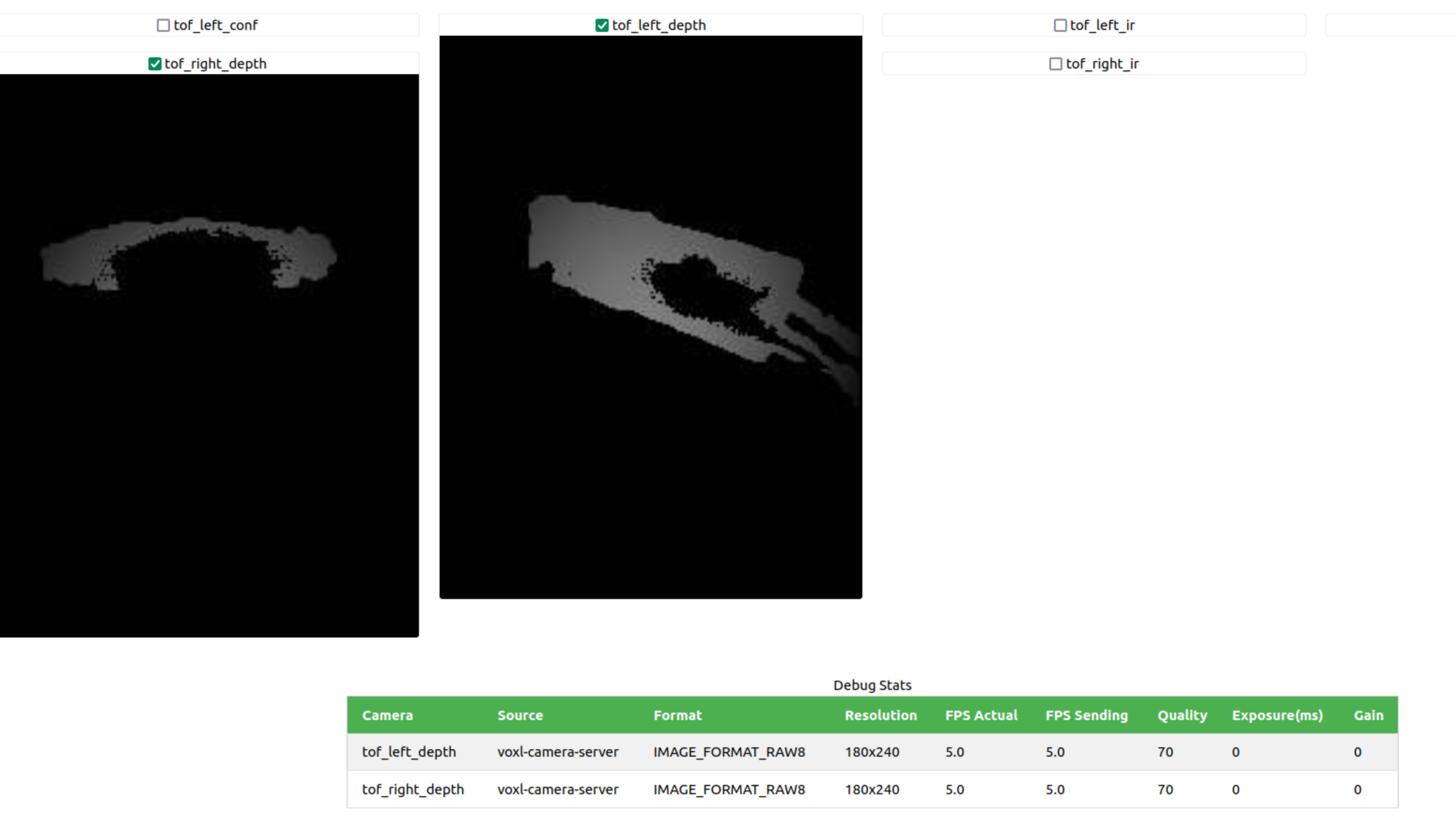

                And here's another where one of the sensors is given a longer range to ping over:
                Alex KushleyevA 1 Reply Last reply Reply Quote 1
                  Alex Kushleyev ModalAI Team @msberk
                  @msberk , ok so you are not seeing exposure being reported.. You should double check that you are using the version of camera server that supports this feature:
