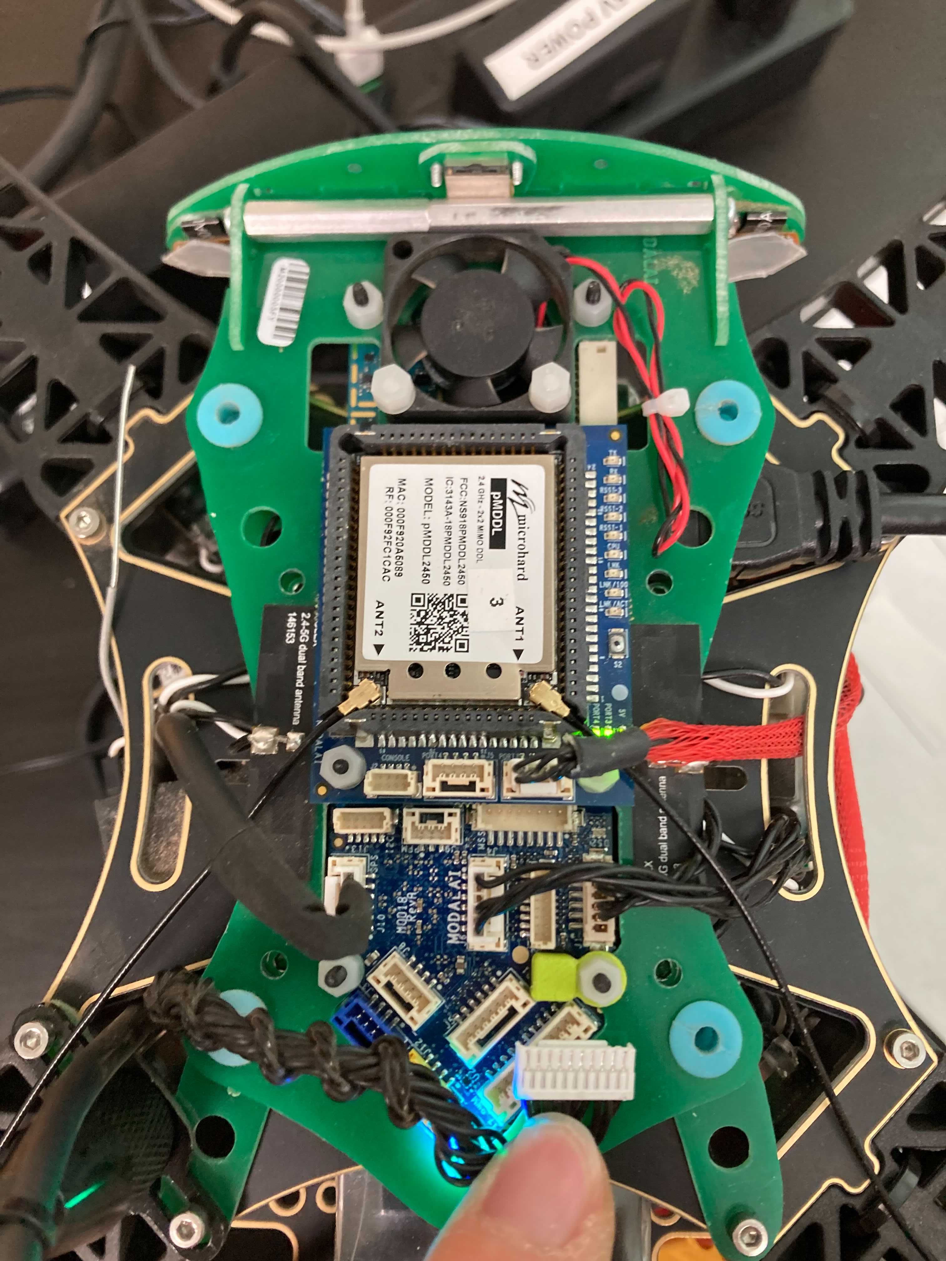

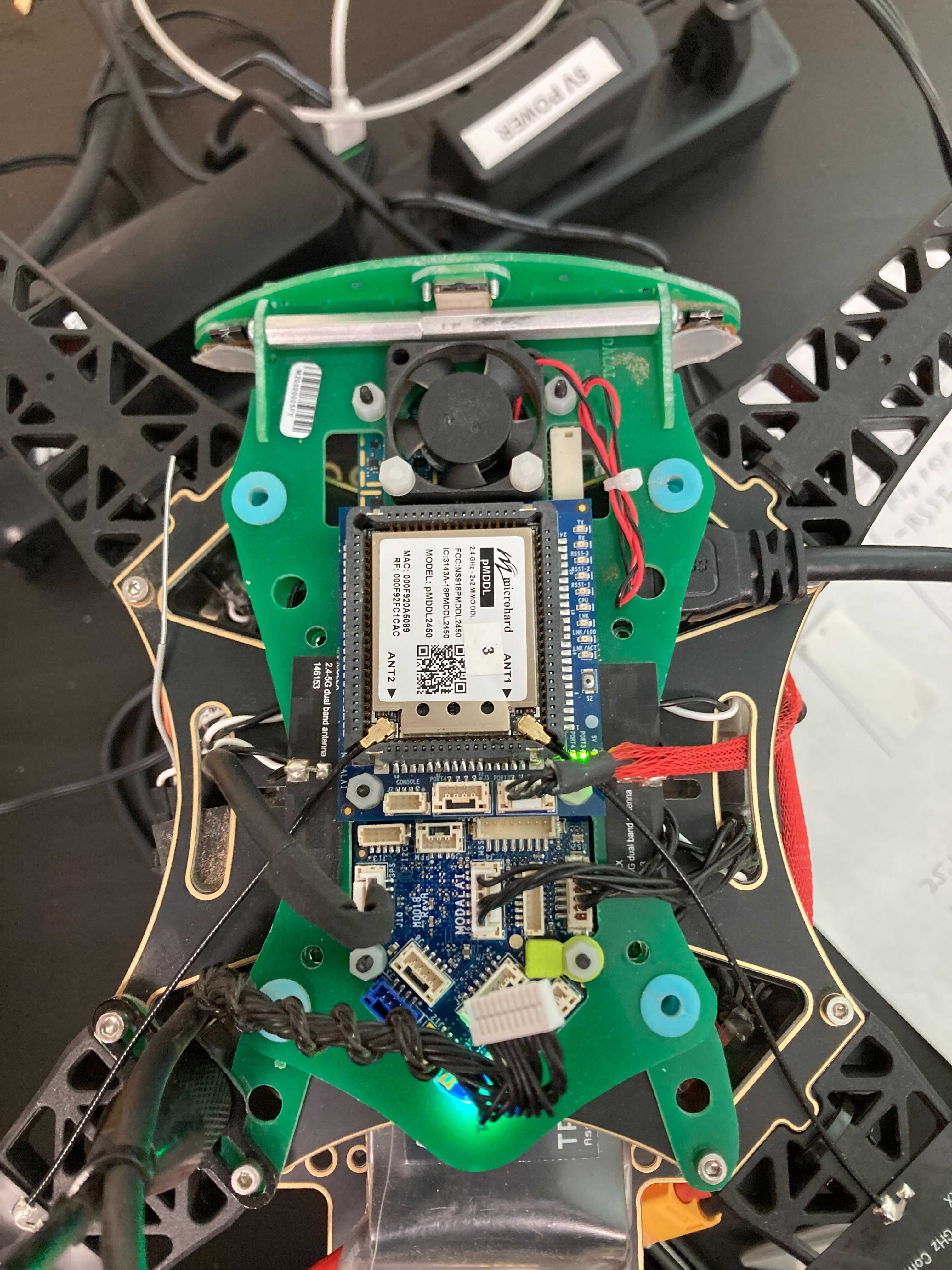

    I have been using this m500 for roughly a year now. Recently the microhard radio I have been using with this m500 has not been powering on, but the m500 gimbal is being powered on despite being attached to the same board. Any suggestions on what I could try to restore power to the microhard?

      @Daniel-Ryu Is the voxl-modem service running on boot?
      systemctl status -l voxl-modem
      The Microhard modem won't be able to power up without it.

        @tom That was the issue, I had to rerun voxl-configure-modem. Thanks!
