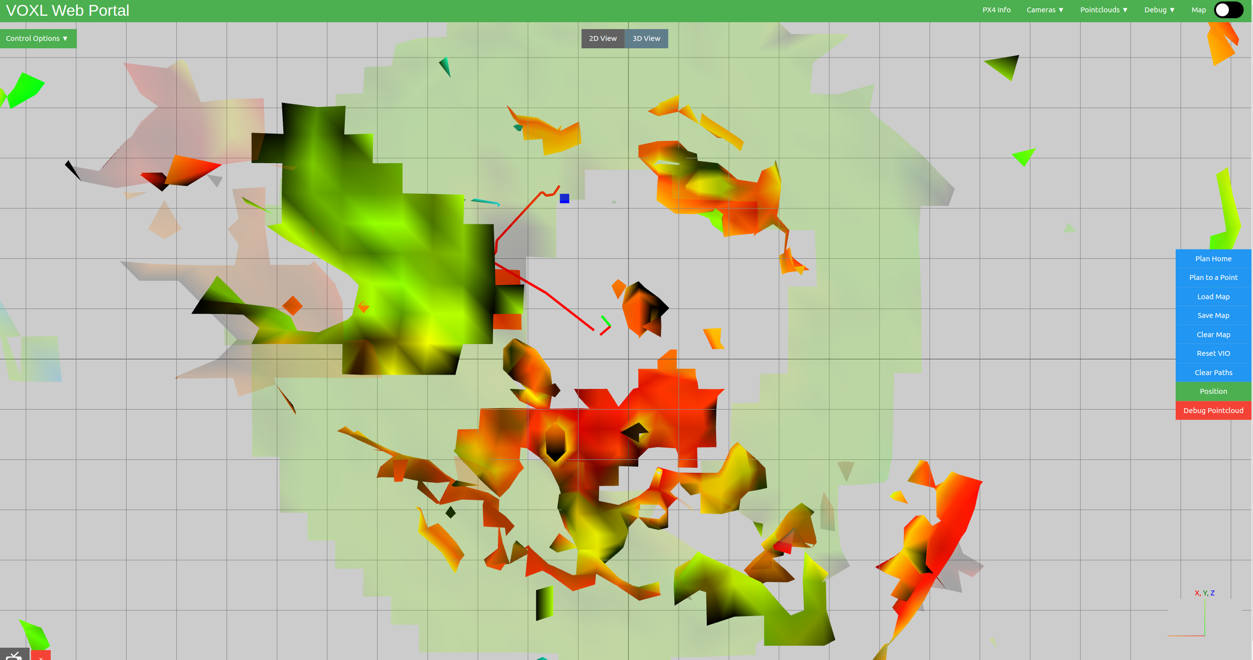

      Naturally, voxl-mapper also produces proper indoor map
